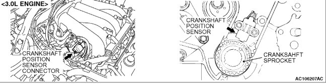

I cant locate the crankshaft and camshaft position sensors

Yep, they are hidden, the crankshaft sensor is in front of the crankshaft under the timing belt cover, the camshaft sensor is under the intake manifold, here is a diagram of the locations. Check out the images (below). Please let us know what happens.
