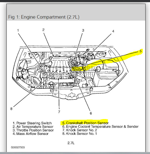

Yes we had to replace the crankshaft and camshaft position sensors, but I need to know where each is located.
Jul 19, 2019 at 12:31 PM
SCGRANTURISMO
  • 4,897 POSTS
The Camshaft Position Sensor (CMP) is located on the rear of the left cylinder head, and the Crankshaft Position Sensor (CKP) is located on the rear of the engine. I have included a diagram showing the location of the CKP in the diagrams down below. Please get back to us with how everything turns out.
Thanks,
Alex

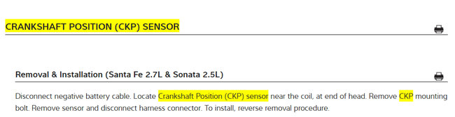

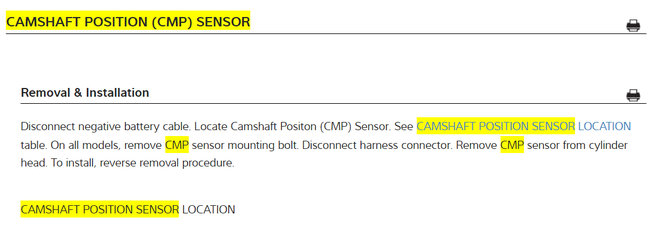

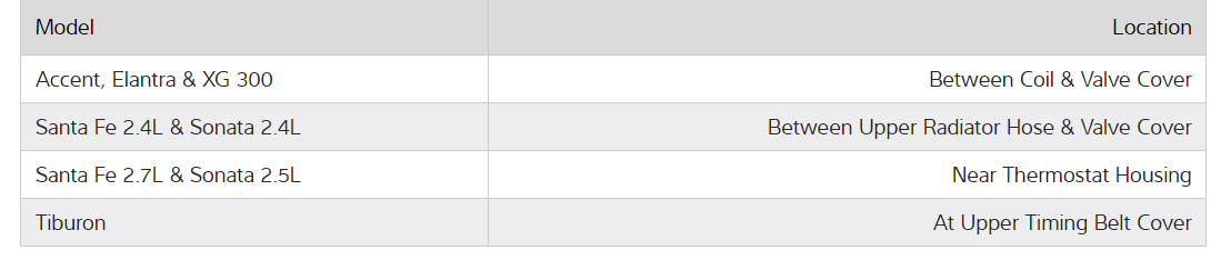

Could you by chance show a diagram showing the camshaft position sensor? they are not the same correct? Because our codes said we had to replace the crankshaft sensor and we did and now it only says camshaft position sensor needs replaced, but when we bought it it looked the same as the crankshaft sensor.
Jul 19, 2019 at 12:54 PM
MOMATUS1986
  • 27 POSTS

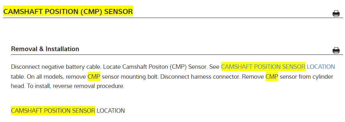

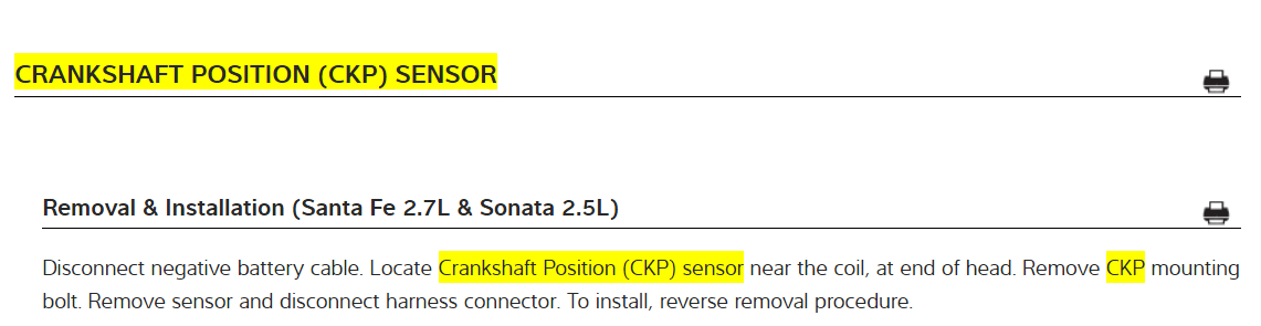

Could you tell us the steps to replace the camshaft position sensor on our car listed above?
Jul 19, 2019 at 1:00 PM
SCGRANTURISMO
  • 4,897 POSTS
Hello again,
I have included the information that you requested in the diagrams down below. Please go through these guides for the removal and installation of your vehicle's CKP and CMP and get back to us with what you are able to find out, or how everything turns out.
