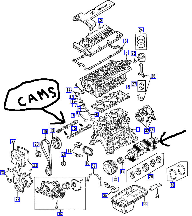

I am trying to find out where my camshaft and crankshaft is located at on my car listed above it is the EX model. I would like a picture of where they are located at.
Oct 8, 2017 at 5:20 AM
STEVE W.
  • 15,295 POSTS
Your car has a Beta II (G4GC) 2.0 engine.
The crankshaft is inside the engine at the bottom. Lower black arrow.
Camshafts are both located at the top of the engine. One cam opens the intake valves the other opens the exhaust valves.

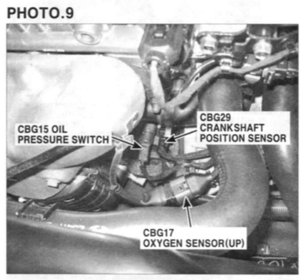

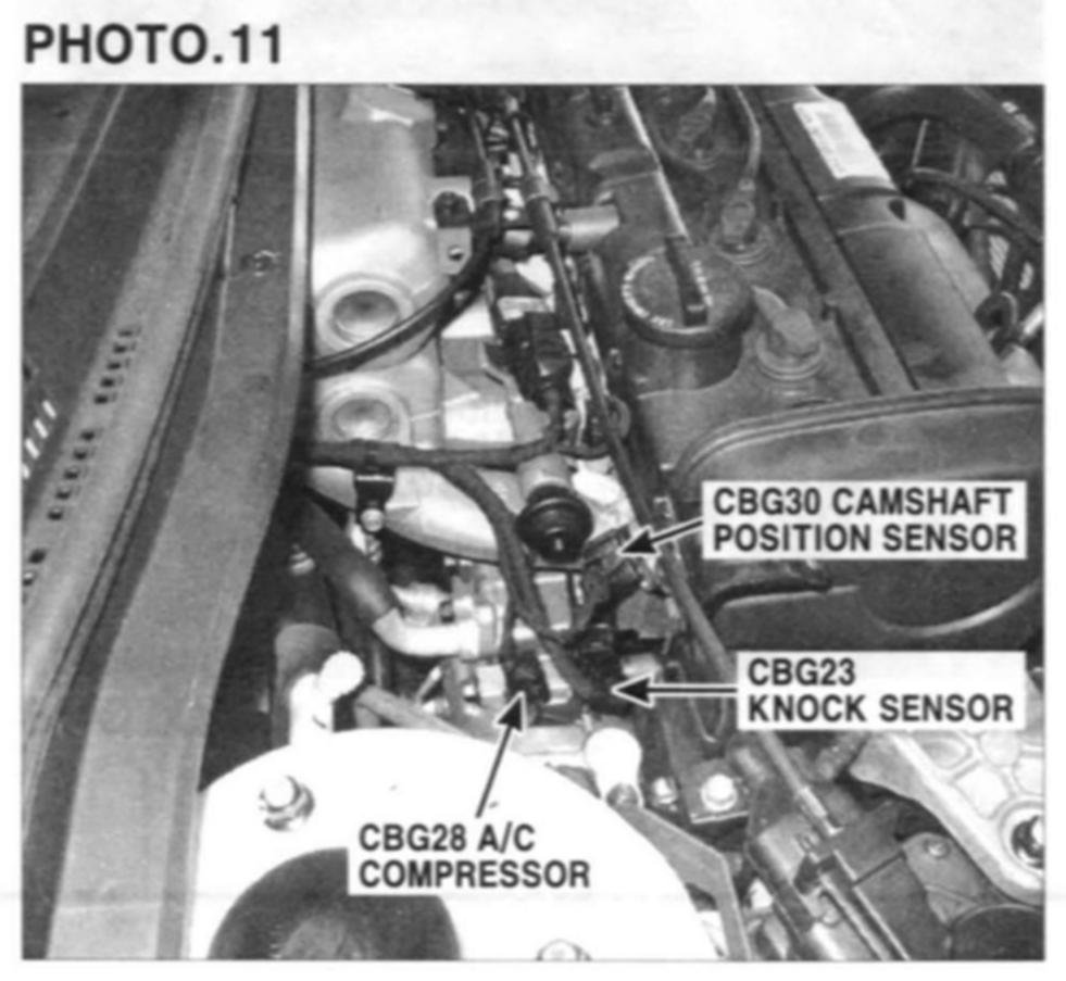

I am looking for the camshaft sensors and crankshaft sensors.
Oct 9, 2017 at 12:09 AM
STEVE W.
  • 15,295 POSTS
Okay, that was not in the question I have.
Crank sensor is next to the oil pressure sender just below and left of the radiator hoses.
Camshaft sensor is on the corner of the cylinder head in line with the fuel rail.
