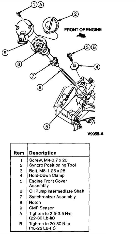

Engine light came on running rough, code says camshaft alignment sensor is bad. where do I find it at?

It is where the distributor once was the call it a synchronizer.
Here is a diagram of what it looks like (below).

Thanks Ken, I will be sending some photos soon, but I was wondering what kind of tool do I need to remove it?

I do not recall any special tool that you need except for a universal for the hold down bolt.

Is there a tool to replace the synchronizer

What do you need a tool for can you send pictures?
