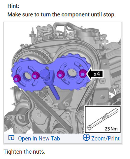

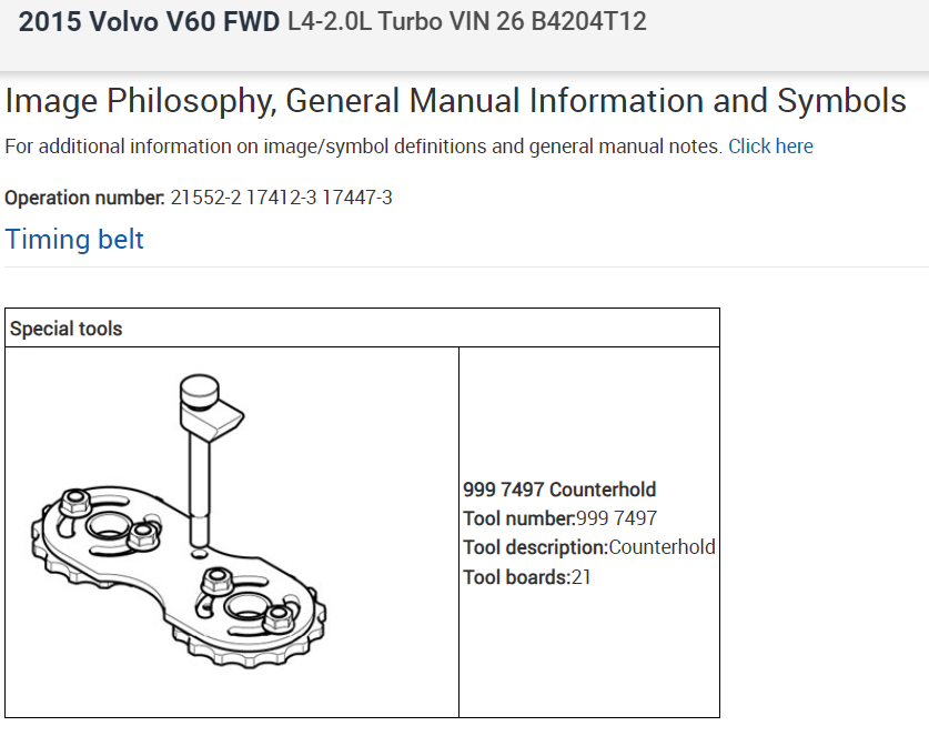

I am on with aligning the camshaft and was told to go by the marks but also have piston 1 at TDC, but on the crank mark it's not TDC do I go TDC, or go by the mark?
Oct 22, 2024 at 5:33 AM
  • 55,214 POSTS

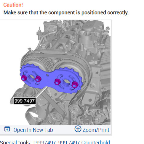

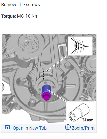

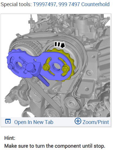

Correct, the piston for the #1-cylinder comes up twice, but once one position is correct. If the engine is apart the best way to tell is to have the #1-cylinder camshaft lobes 180 degrees away from the valves themselves. Here are the timing marks to make sure you will get it put back together correctly. For the camshafts timing there is a special tool they use. Here is the crankshaft mark and the tool they use. Check out the images (below). Let us know if you need anything else.
Oct 22, 2024 at 10:22 AM
SEANBYERS
Okay, thanks, so I don't want it top dead center I just want it on the marks. thanks
