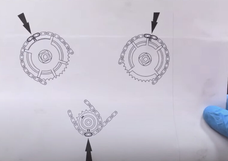

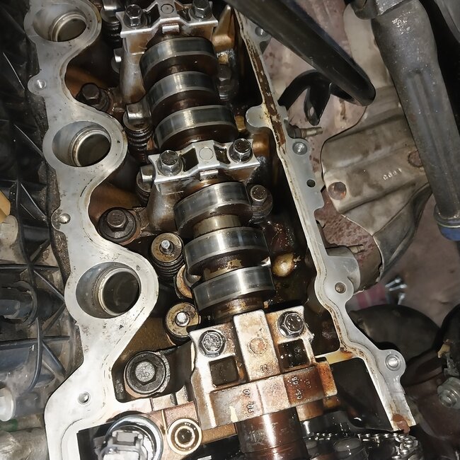

I watched a video on timing chain replacement on the 5.4 3v, it said I have to make sure I get both cams at the 12o'clock position then remove 3 roller followers from each side. How do I get both cams at the 12o'clock position at the same time? I started with the crankshaft at 12 then turned it until cylinder was at 12 but cylinder wasn't.

Do you have an image of the problem? I am not sure what you are talking about.
This is the video in case we need to review it:
https://youtu.be/dler2t2e4Zw?si=Cag_u4DYh6S9d24g
Here are the mark locations. Check out the images (below). Let us know what you find.

I can't get the cam lobes to align at the 12o'clock position on cylinders 1 and 5.

It looks like the timing of off, can I get a picture for the camshaft phasers?
