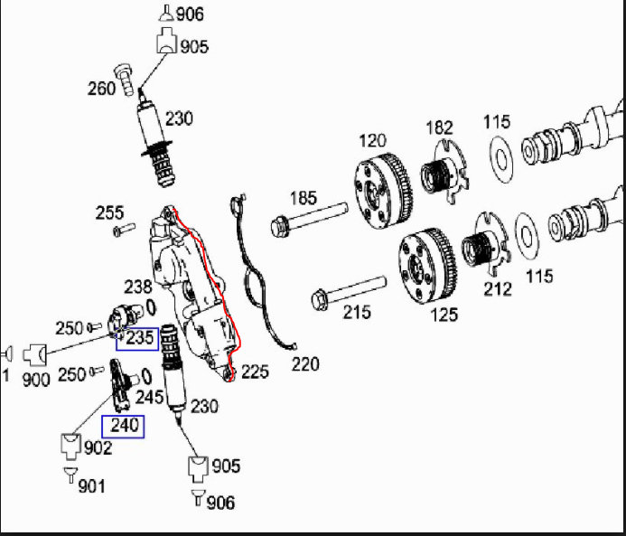

I've replaced both valve covers and noticed an oil leak on both camshaft adjusters. Do the cams need locked before removing the covers to replace the seals?

Is this a C63? I believe by accident you transposed the model above. I just want to confirm I have the right vehicle.
If you are not removing the timing chain, there isn't a need to lock the cams in place.
Let me know if that helps and if I have the correct vehicle.
