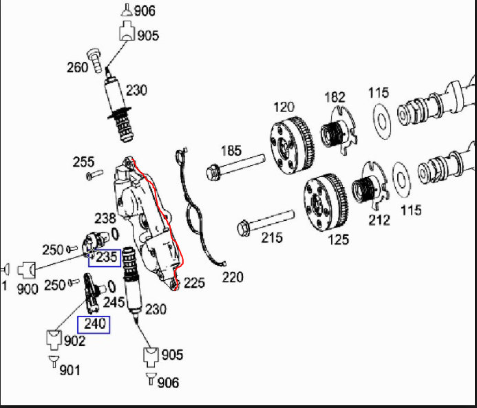

Camshaft adjuster housing seal

I've replaced both valve covers and noticed an oil leak on both camshaft adjusters. Do the cams need locked before removing the covers to replace the seals?

If you are not removing the timing chain, there isn't a need to lock the cams in place.
