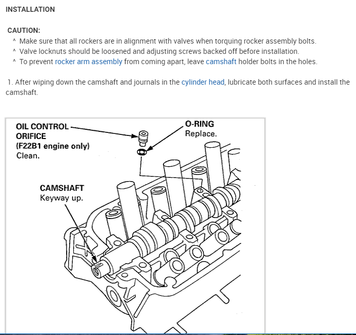

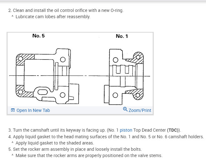

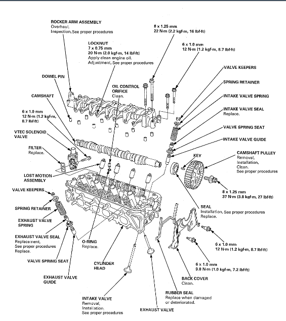

I was getting oil in one of my plug wires, so I replaced the o-rings. While turning the motor over, the left side of the camshaft popped up from the distributor. I had to realign the notches again, and may have turned it upside down. Now the camshaft won't drop all the way down on that side, and I can't lift it up high enough to spin it around. Does it matter which notch is on the top?

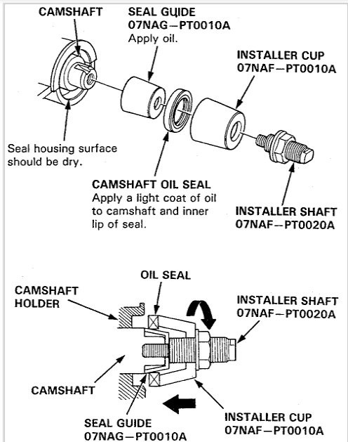

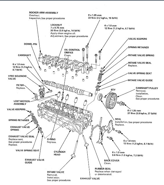

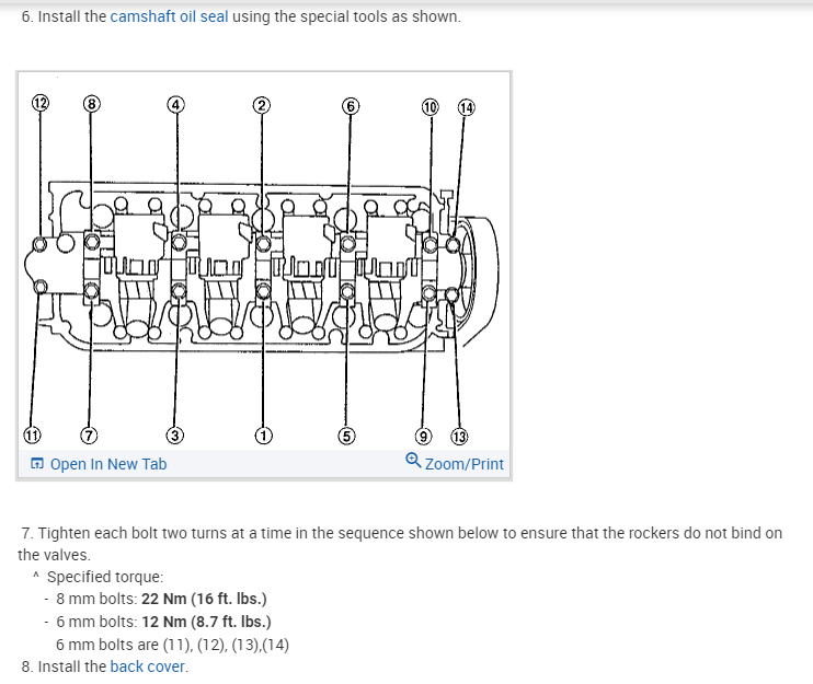

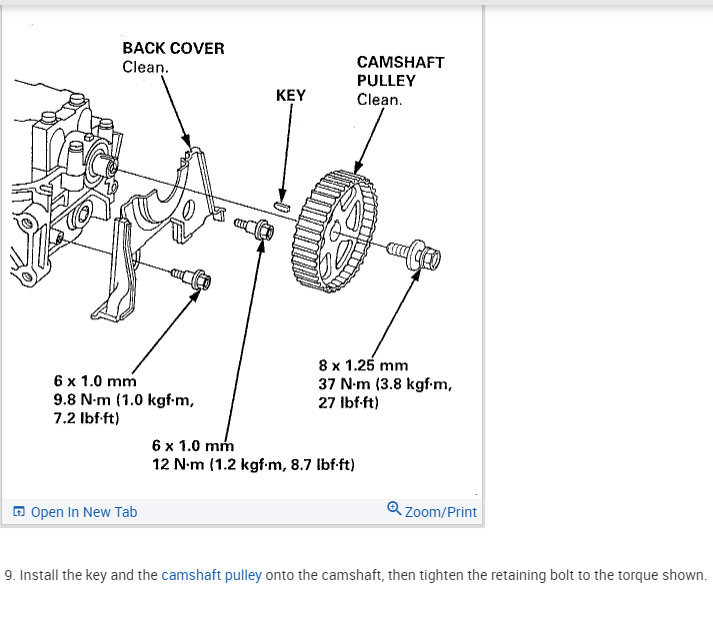

I've attached a bunch of step-by-step pictures below to help you replace the camshaft. Hope this helps and thanks for using 2CarPros. Check out the diagrams (Below). Please let us know if you need anything else to get the problem fixed.
