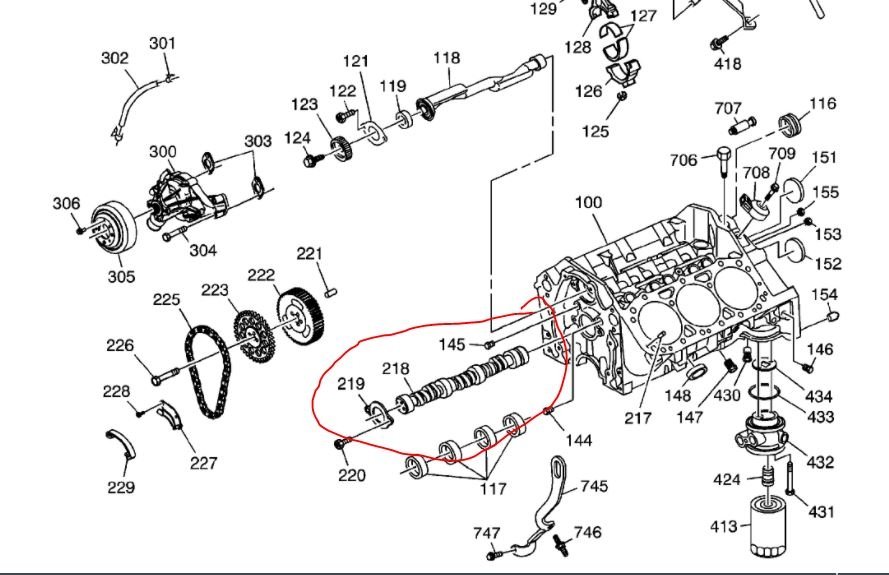

Truck listed above is a 1500 with a 4.3l.
Where is it located at?
Jan 13, 2021 at 1:49 AM
Good afternoon,

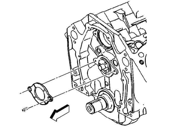

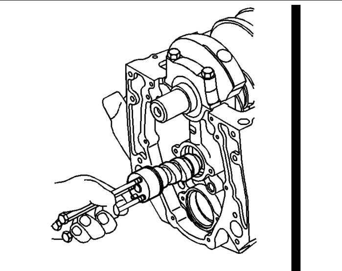

Since this is a pushrod motor, the camshaft is in the center of the motor.
This repair is a total break down of the motor to access the camshaft.
I attached some pictures for you to view.
