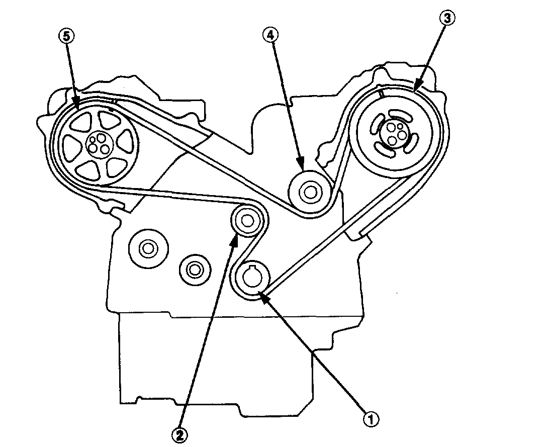

I think am leaking oil from the rear camshaft seal. do I have to remove the whole camshaft to replace it? or can I just put back the round rubber ring without pulling off the camshaft? i noticed a broken piece of the ring on the ground. not sure quite the procedure is to replace it.

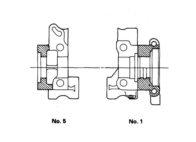

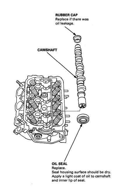

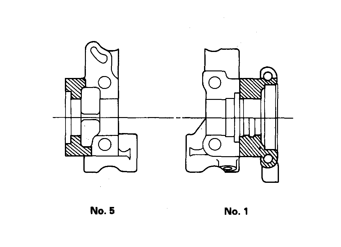

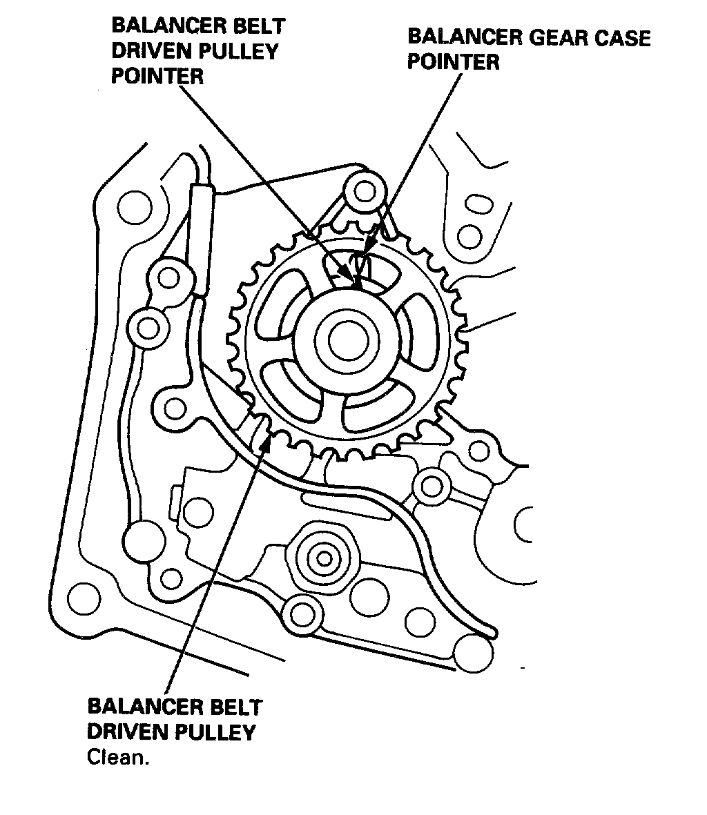

According the the directions, the cam needs removed. Here are the directions for replacing the seals (both front and rear). The attached pitures correlate with the directions.
_________________________
CAUTION:
- Make sure that all rockers are in alignment with their valves when torquing the rocker assembly bolts.
- To prevent the rocker arm assembly from coming apart, leave the camshaft holder bolts in the holes.
- Handle the rocker arms carefully so that the oil does not come out of the hydraulic tappets.
pic 1

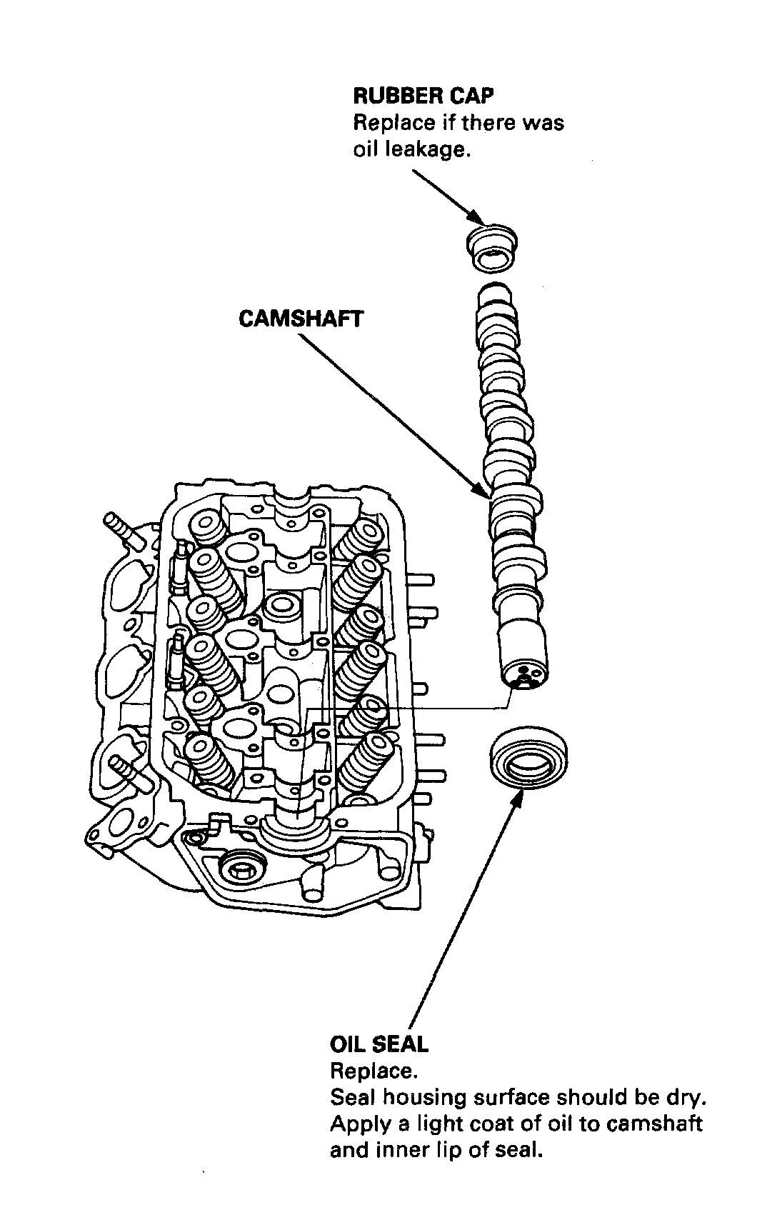

1. Install the camshaft and rubber cap, then install the camshaft seal with the open side (spring) facing in.
NOTE:
- Position the camshaft with pin hole at the top.
- Do not apply oil to the camshaft holder mating surface of the camshaft seal.
- Apply liquid gasket, Part No. 08718-0001 or 08718-0003 around the rubber cap.
pic 2

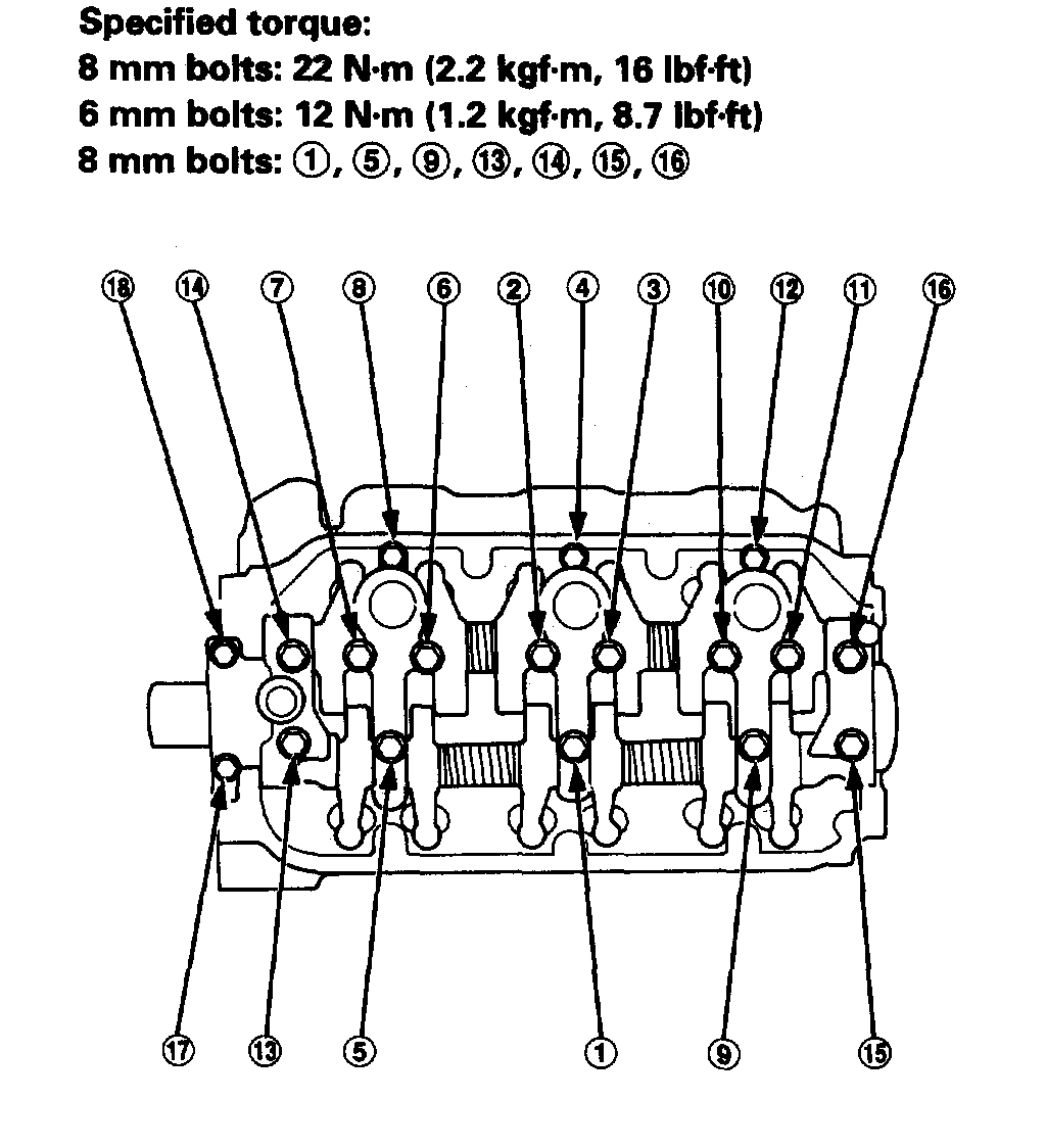

2. Apply liquid gasket to the head mating surfaces of the No. 1 and the No. 5 camshaft holders. Apply liquid gasket to the shaded areas.
pic 3
3. Tighten each bolt 2 turns at a time in the sequence to ensure that the rockers do not bind on the valves.
__________________________________

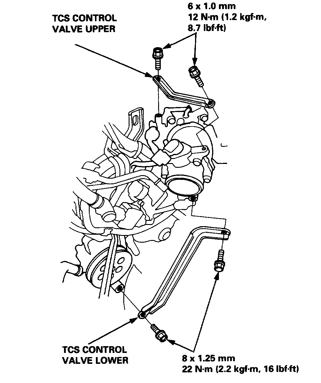

4. Loosen the idler pulley center nut and adjusting bolt, then remove the air conditioning (A/C) compressor belt.
pic 4

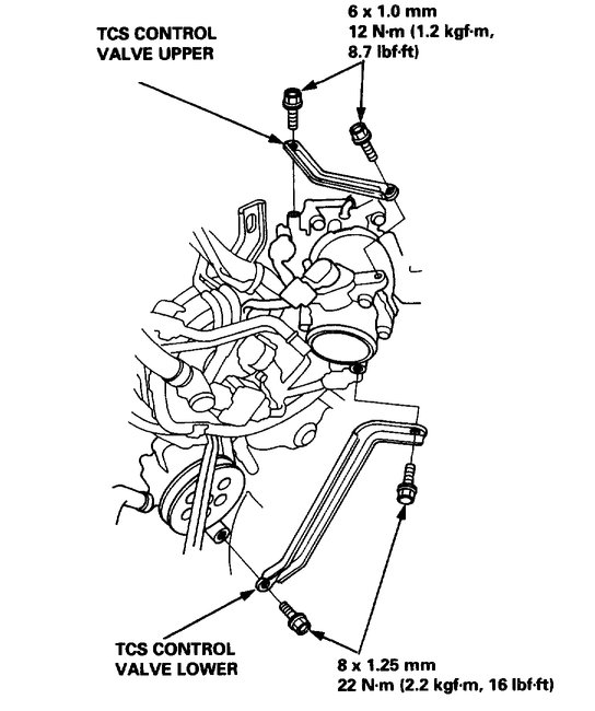

5. Remove the TCS control valve upper and lower
NOTE: Refer to Brakes when installing the brackets.
6. Loosen the adjusting bolt, locknut and mounting bolt, then remove the power steering (P/S) pump belt.

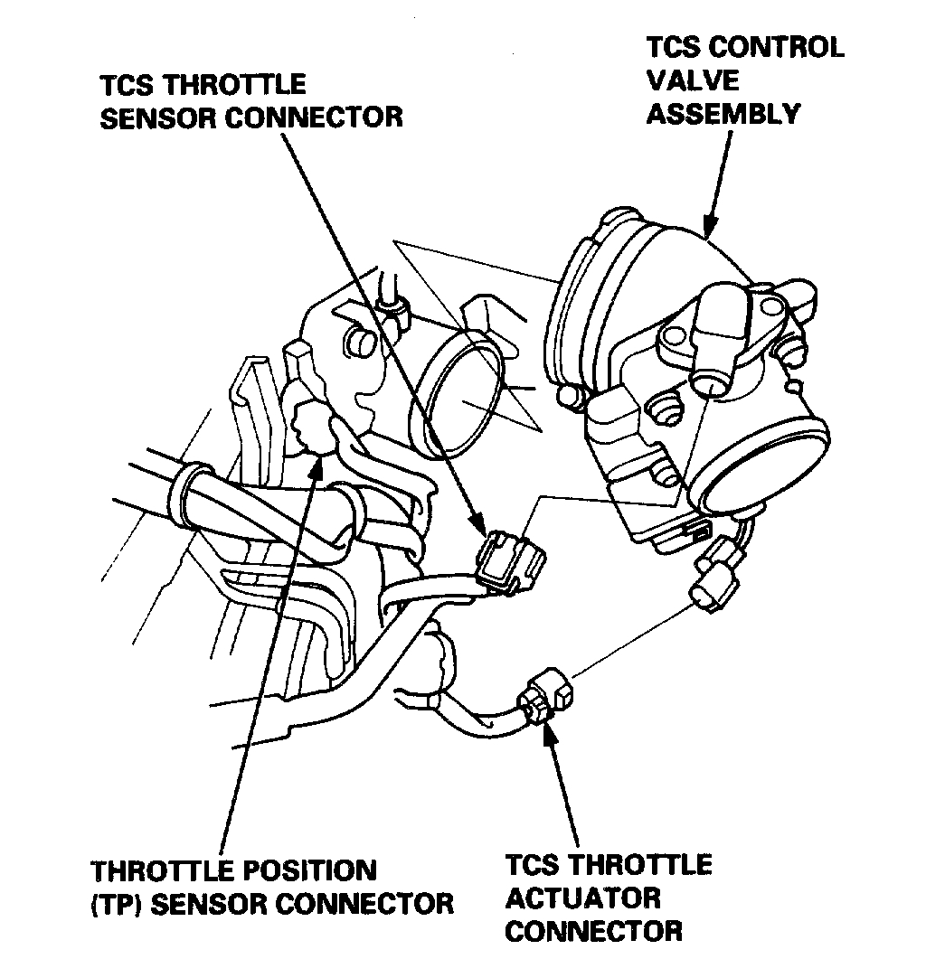

7. Disconnect the TCS throttle sensor connector, the TCS throttle actuator connector, and the throttle position (TP) sensor connector, then remove the TCS control valve assembly.

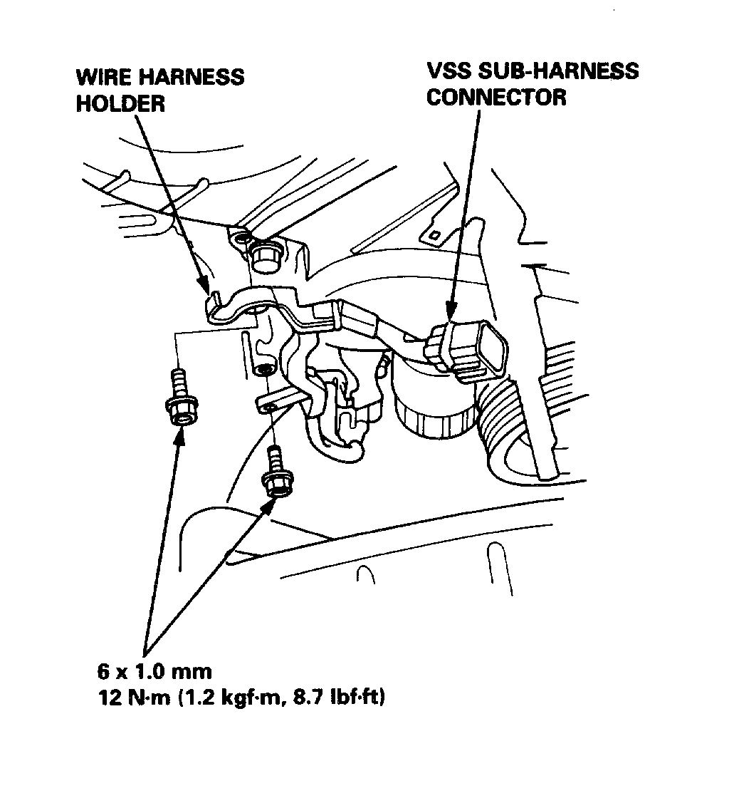

8. Disconnect the vehicle speed sensor (VSS) sub-harness connector, then remove the wire harness holder.

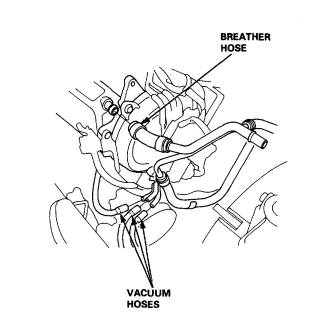

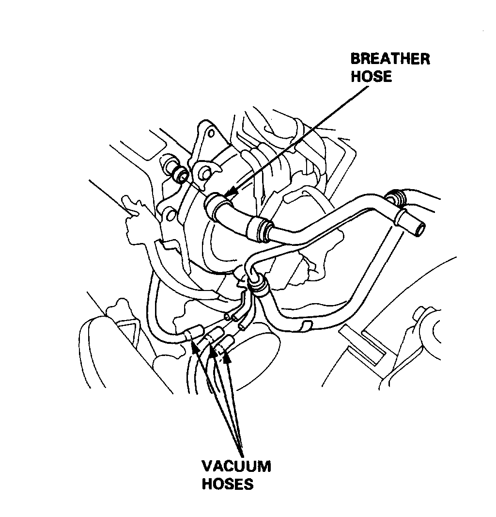

9. Remove the breather hose and vacuum hoses.
pic 8

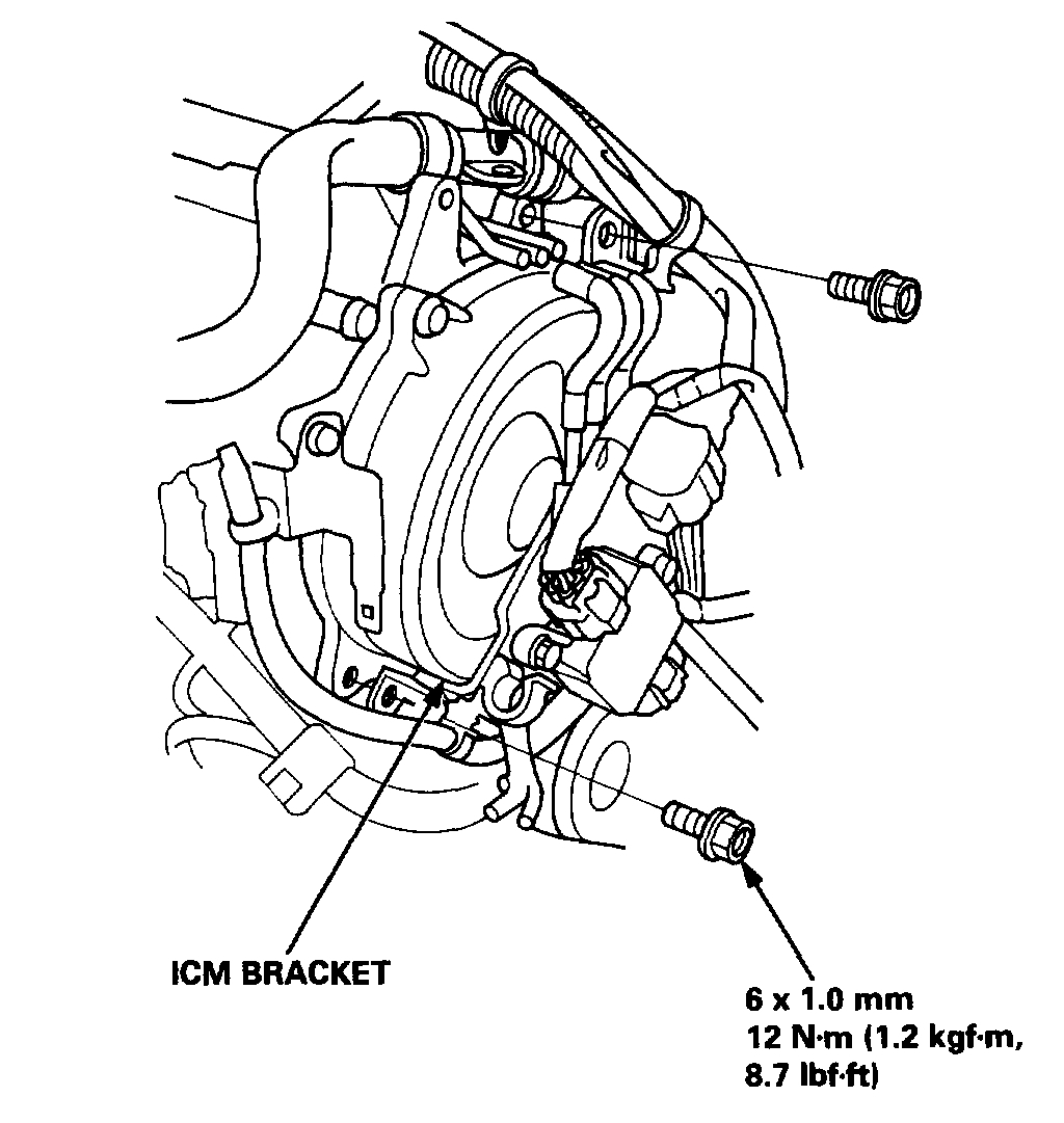

10. Remove the vacuum hoses and ignition control module (ICM) bracket.
pic 9

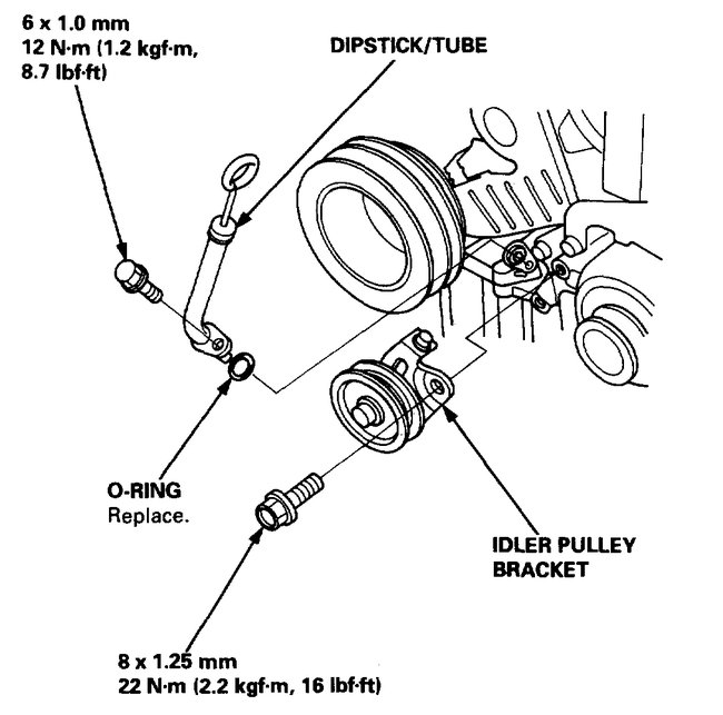

11. Remove the idler pulley bracket, dipstick and tube.
12. Remove the crankshaft pulley.

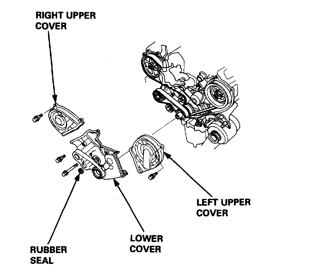

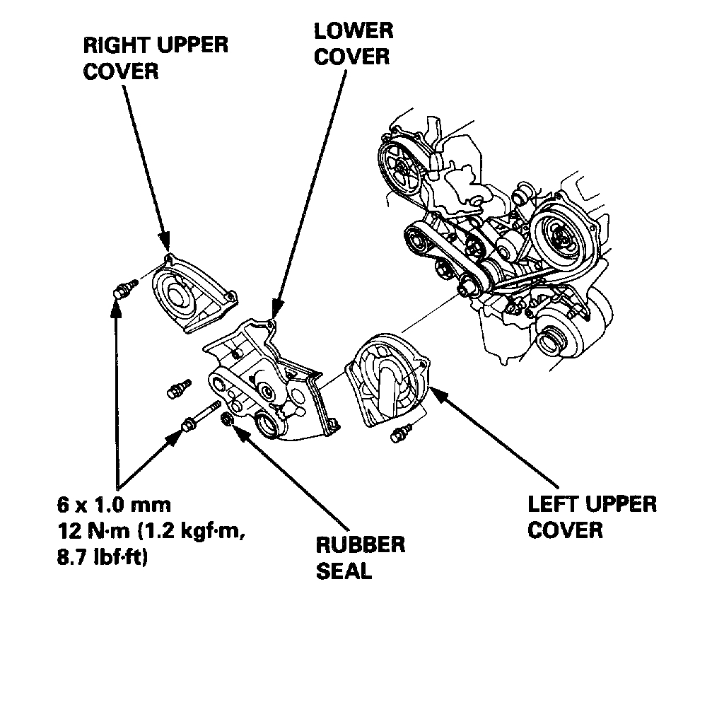

13. Remove the upper and lower covers.
NOTE: Do not use the upper and lower covers for storing removed items.

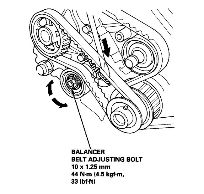

14. Loosen the balancer belt adjusting bolt 180°. Push the tensioner to remove tension from the balancer belt, then retighten the adjusting bolt.
15. Remove the balancer belt.
pic 12

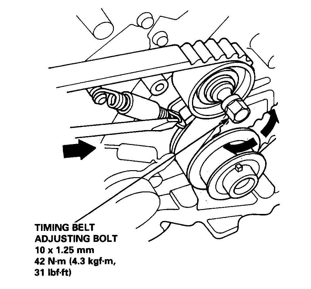

16. Loosen the timing belt adjusting bolt 180°. Push the tensioner to remove tension from the timing belt, then retighten the adjusting bolt.
17. Remove the timing belt.

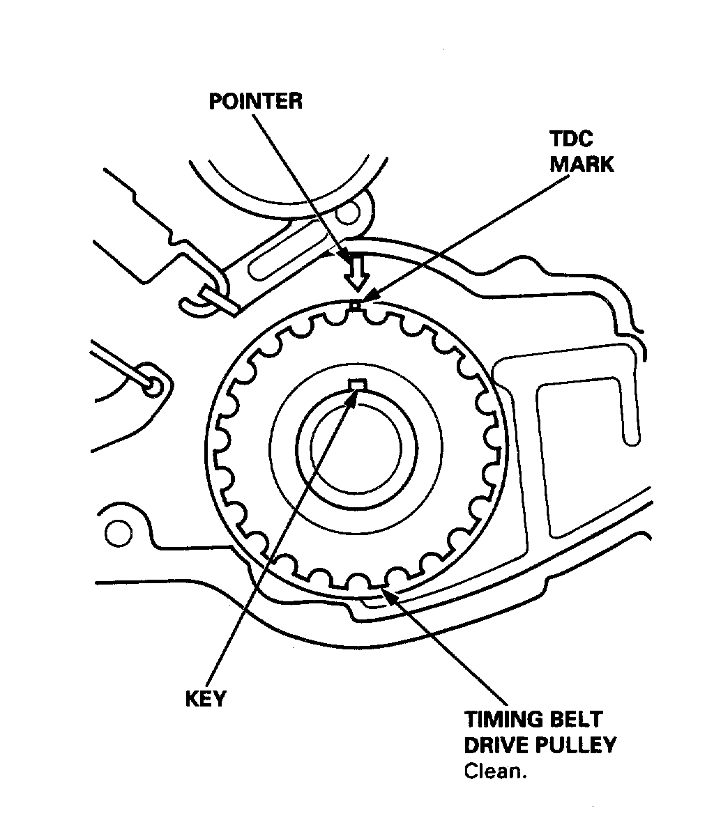

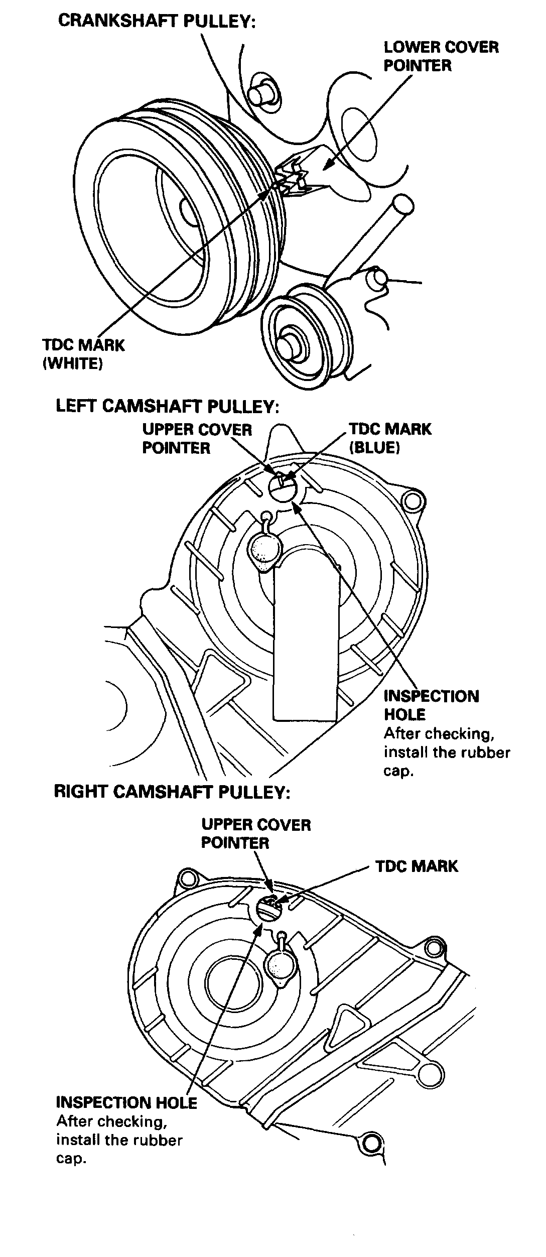

3. Set the timing belt drive pulley so that the No. 1 piston is at top dead center (TDC). Align the TDC mark on the timing belt drive pulley with the pointer on the oil pump.
pic 14

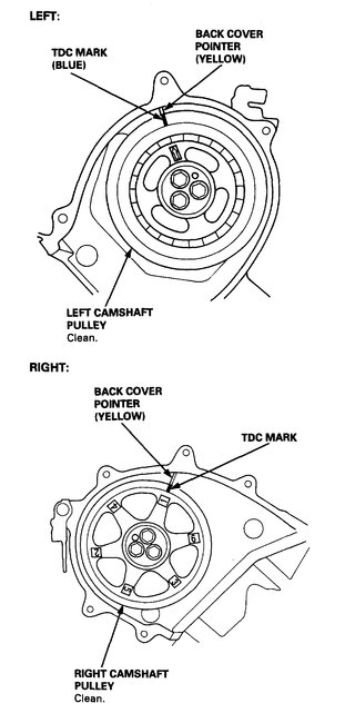

4. Set the camshaft pulleys so that the No. 1 piston is at TDC. Align the TDC marks on the camshaft pulleys to the pointers on the back covers.
pic 15

6. Loosen and retighten the timing belt adjusting bolt to tension the timing belt.

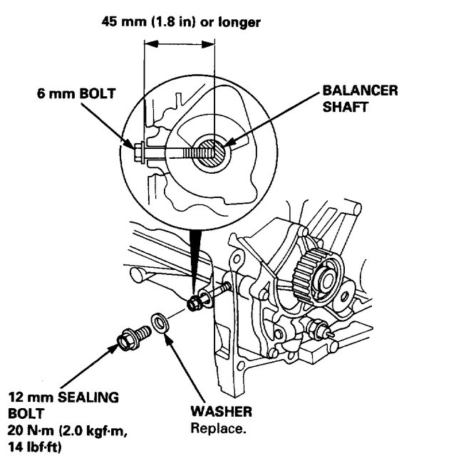

12. Align the maintenance hole and the balancer shaft hole. Insert a 6 mm bolt that is at least 45 mm (1.8 inch) long into the balancer shaft.

17. Remove the 6 mm bolt. Install the sealing bolt in the maintenance hole. Use a new washer.

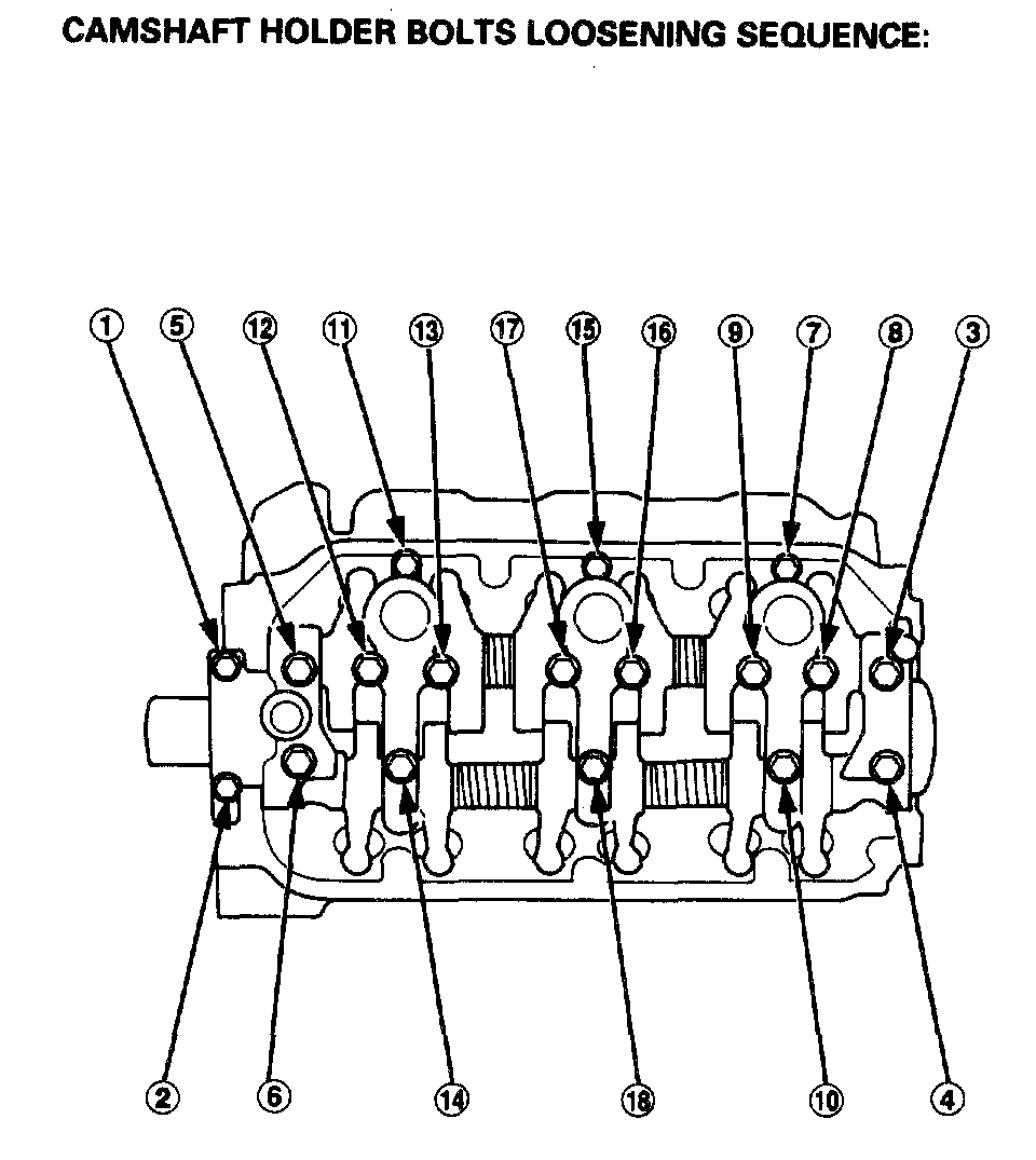

Here are the directions for removal of the rocker arms, which need removed to access the cam.
NOTE: Refer to rocker arm assembly removal. Identify parts as they are removed to ensure reinstallation in original locations. Inspect rocker shafts and rocker arms. Rocker arms must be installed in the same position if reused. When removing or installing the rocker arm assembly, do not remove the camshaft holder bolts. The bolts will keep the holders, springs and rocker arms on the shaft.
Removal
pic 20
NOTE:
- To prevent damage to the valves or rocker arm assembly, unscrew the camshaft holder bolts two turns at a time in a crisscross pattern.
- When removing the rocker arm assembly, do not remove the camshaft holder bolts. The bolts will keep the camshaft holders, the springs and the rocker arms on the shahs.
