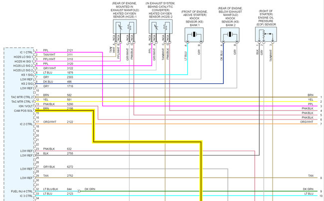

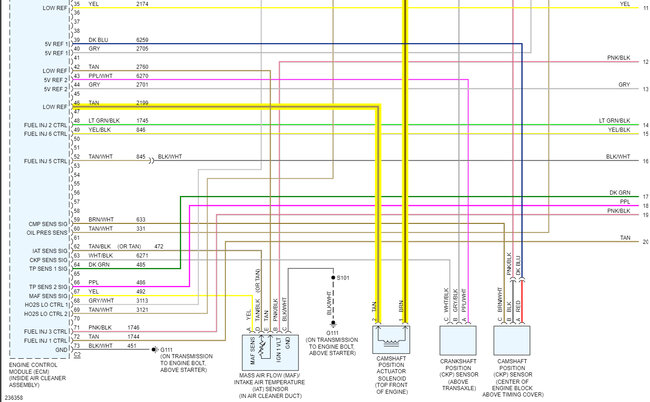

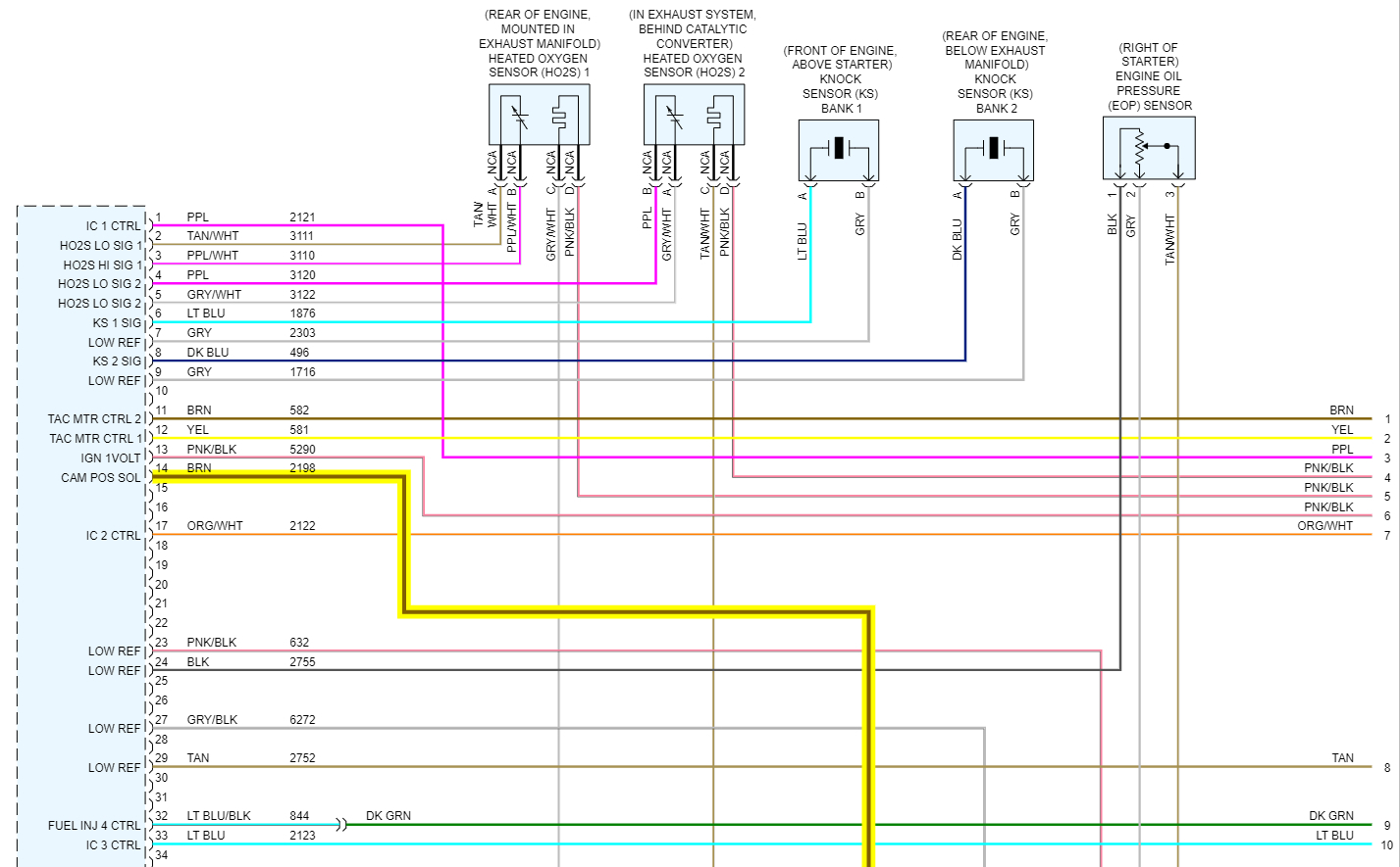

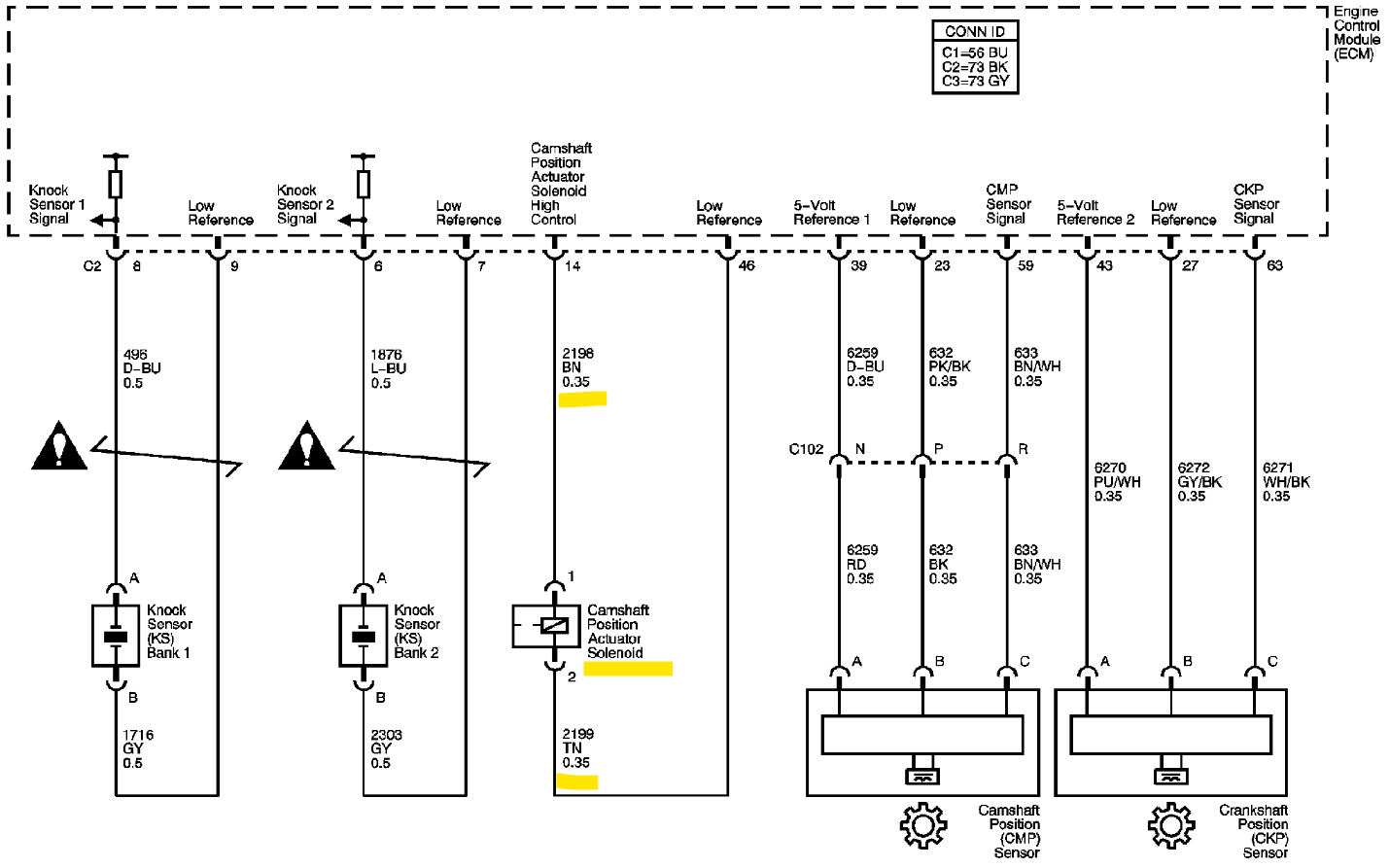

I have been trying to locate the camshaft position CMP actuator solenoid control circuit bank 1 the wiring part. I can't seem to find it, can you please help me?

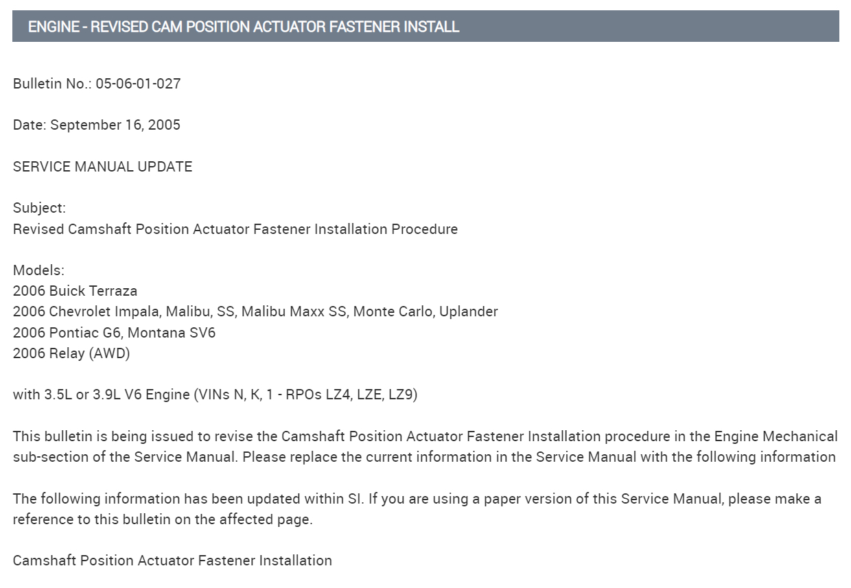

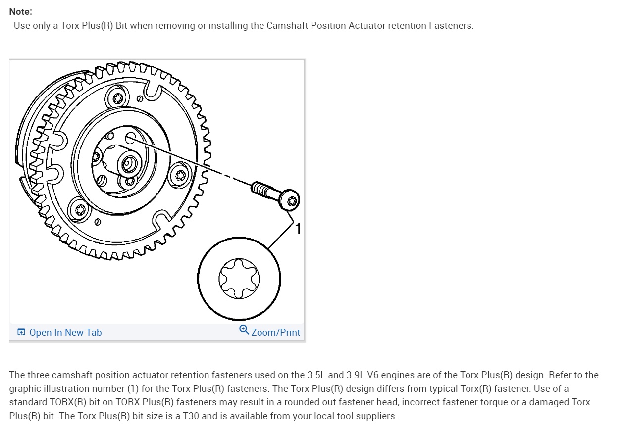

Hello, is this a Flex Fuel vehicle, and are you getting a particular engine code?

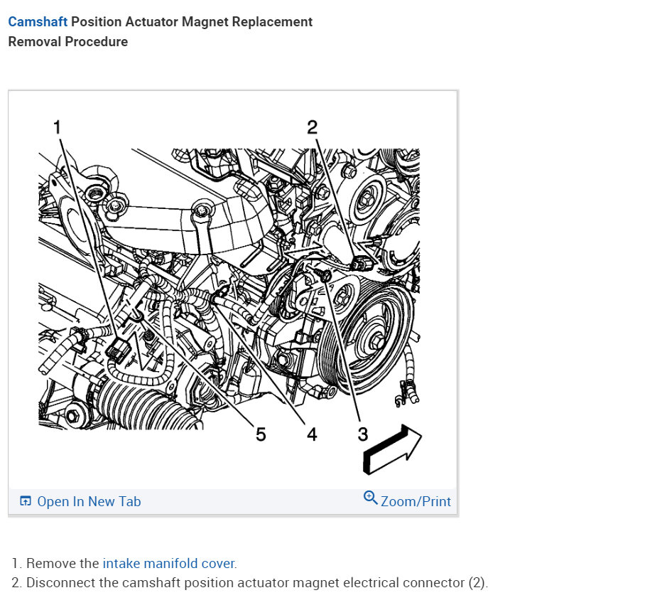

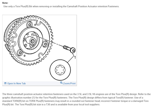

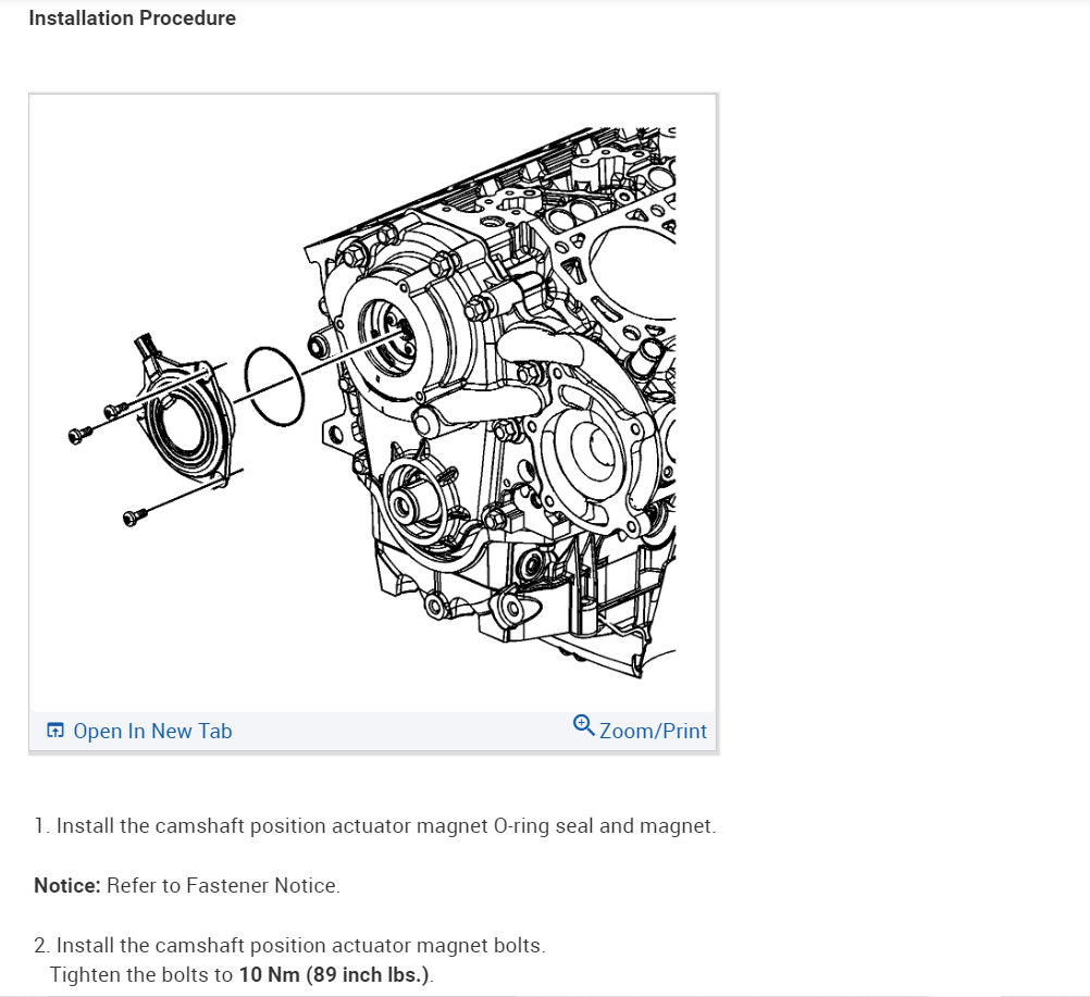

These are the wiring diagrams for the camshaft position actuator solenoid.

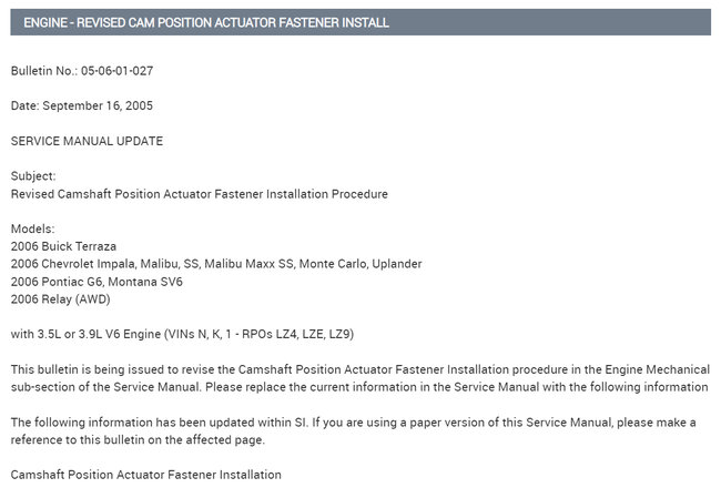

There is actually a Technical Service Bulletin on this issue, pages 3 and 4 below.
Diagrams 5 to 8 show the rest of the system.

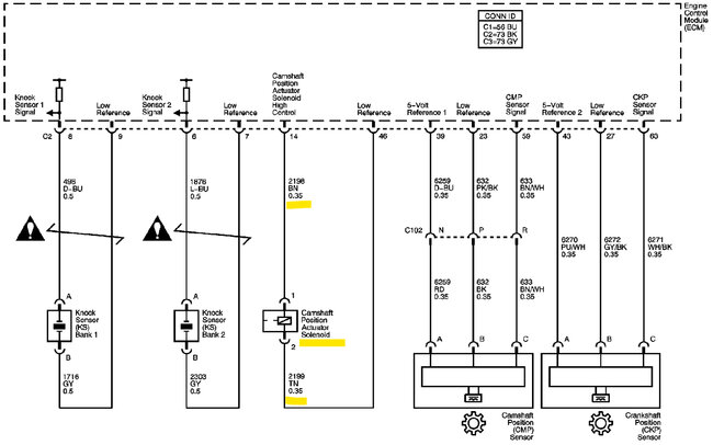

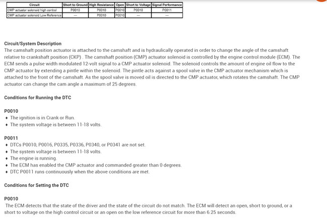

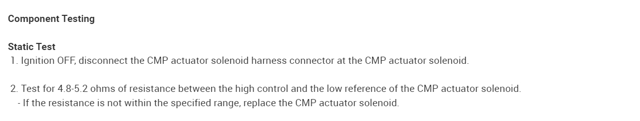

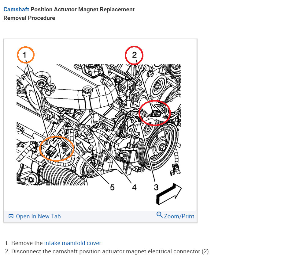

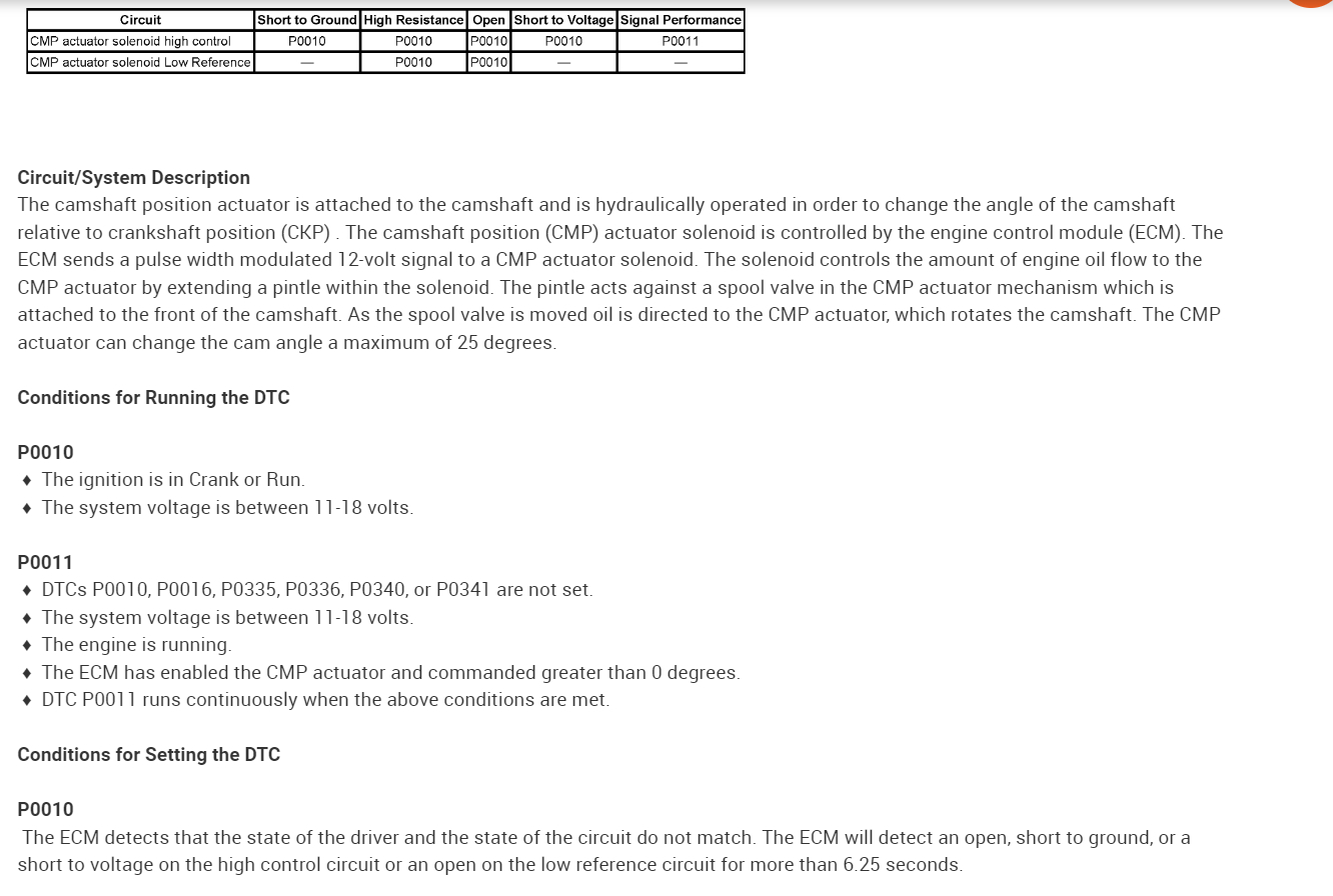

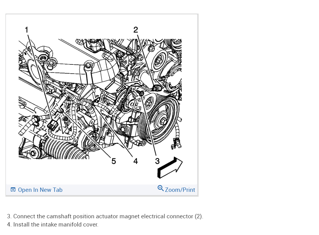

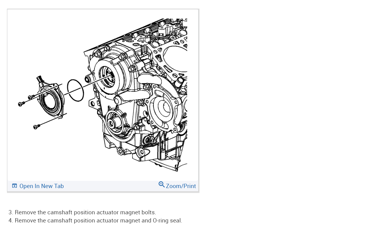

I have a code p0010 on the car listed above camshaft position CMP actuator solenoid control circuit. I'm just trying to find location of what do the wiring look like .
Oct 28, 2022 at 6:52 AM
AL514
  • 5,702 POSTS

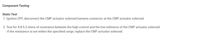

Okay, here is the code information, the code setting criteria and resistance testing of the actuator (pages 1 to 3). in the fourth diagram, the cam actuator plug is either number 1 or 2, it's a 2-wire harness plug and the wire coloring, one is brown and the other is tan.
