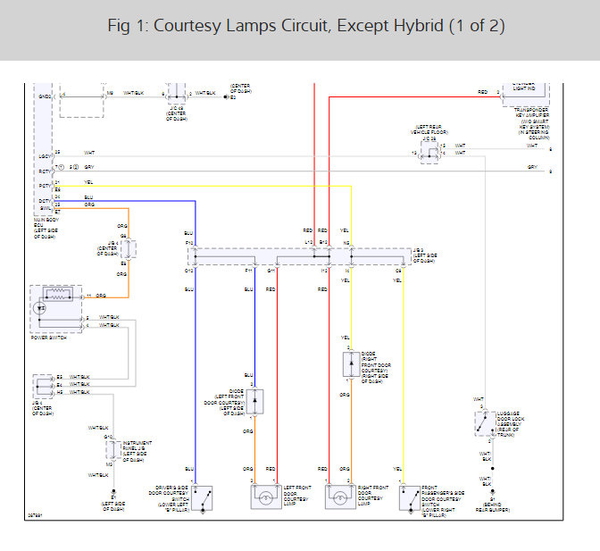

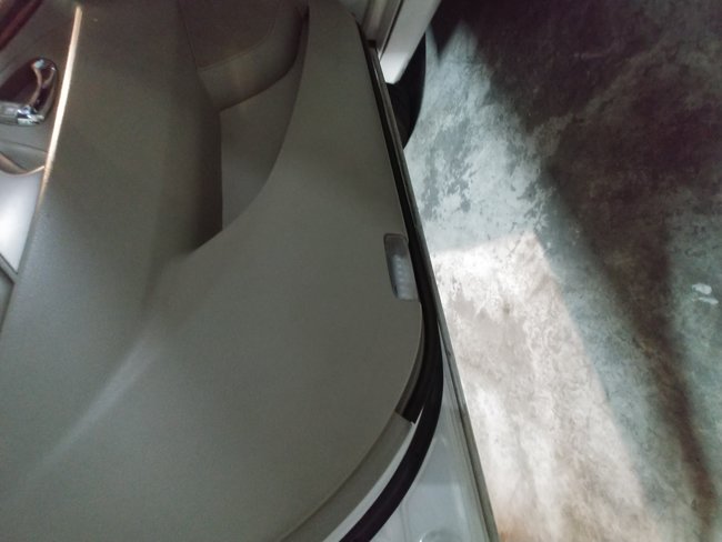

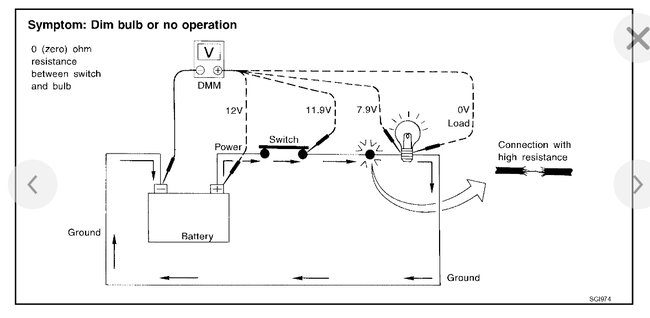

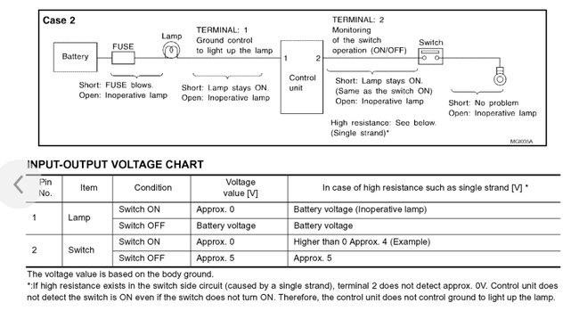

I've a problem with one side of the door courteous light. Swap the light bulb with other doors, it is working but when swapping back with the door. It is no working.
Therefore, suspect there must be a wiring issue or something else. It was working before this. Using a multi-meter to measure, it shows around 2v instead of 12v on the other doors.
Appreciate on guidance to troubleshoot.

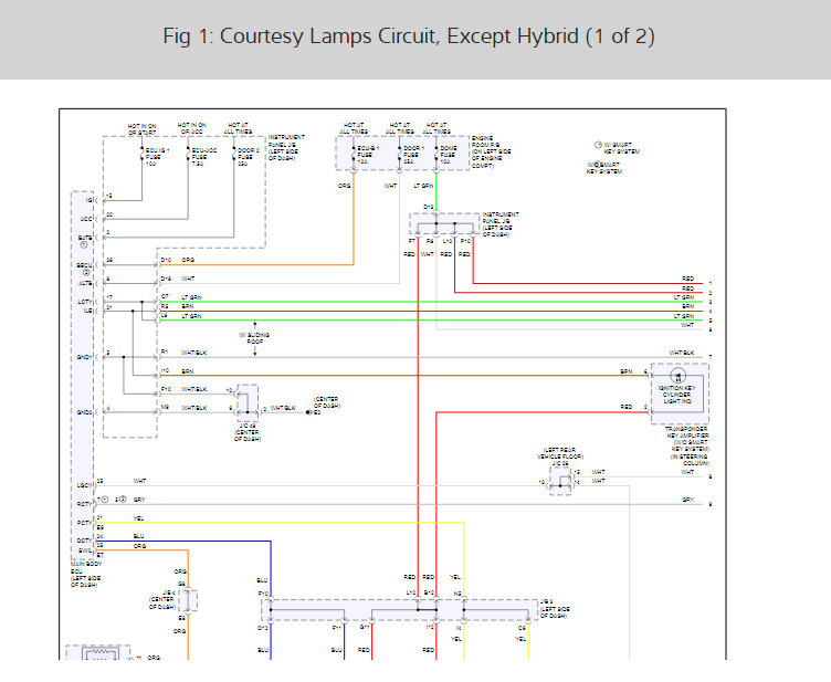

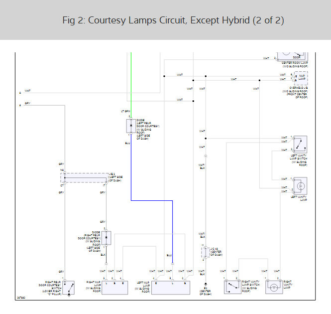

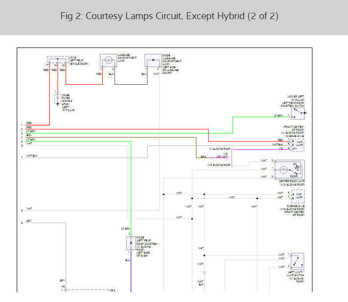

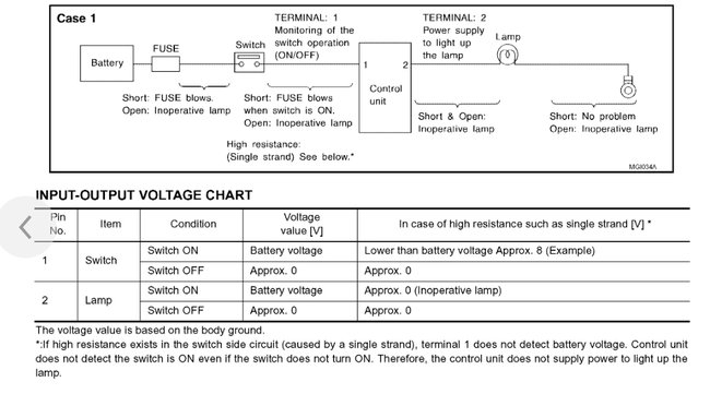

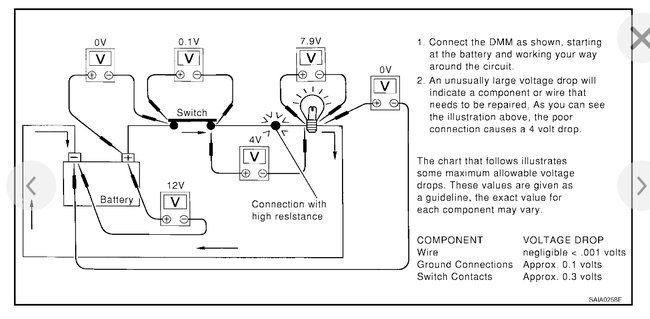

You have got unwanted resistance somewhere in the electrical circuit for the light. In the diagrams down below I have included a wiring diagram for the interior lighting circuits as well as a guide for how to find problems in an automotive circuit using the preferred method called "voltage drop". Please go through these guides and get back to us with what you are able to find out.
Thanks,
Alex
