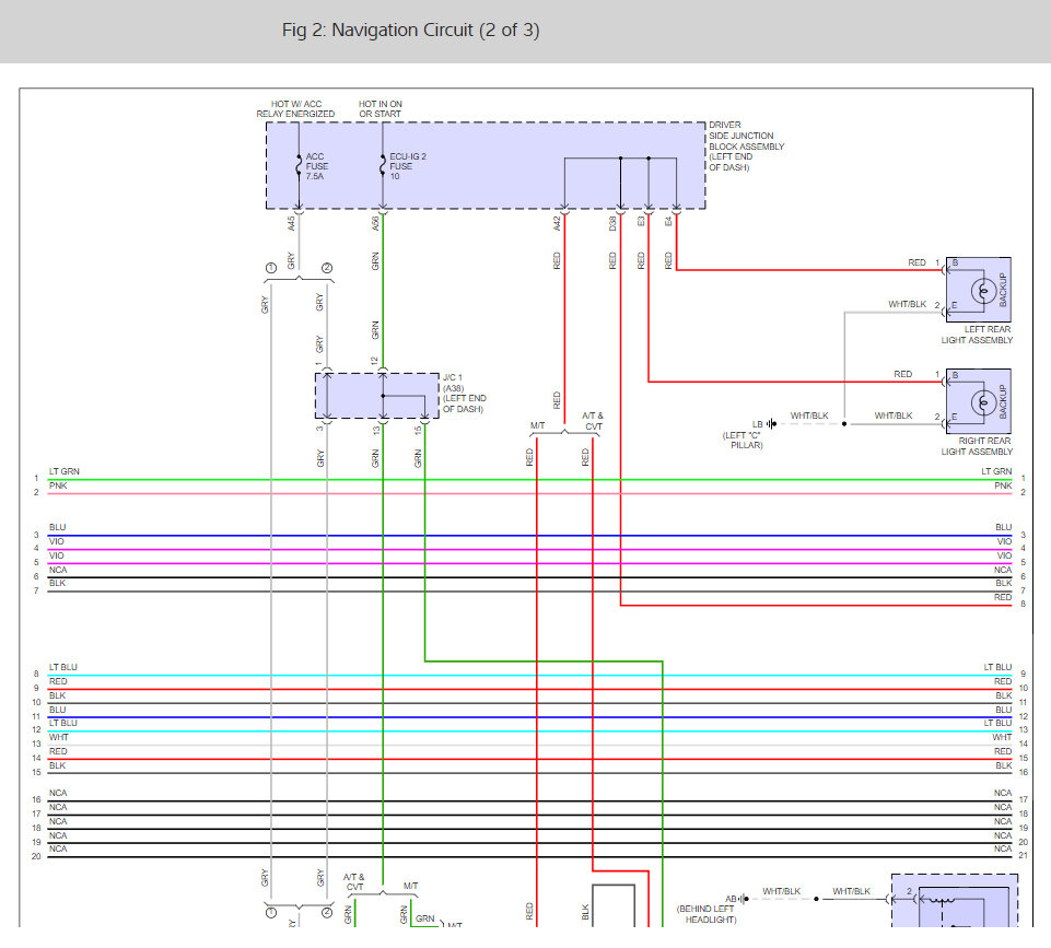

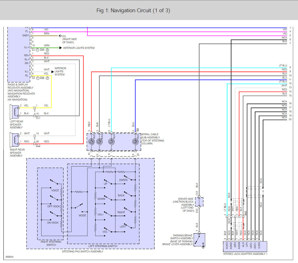

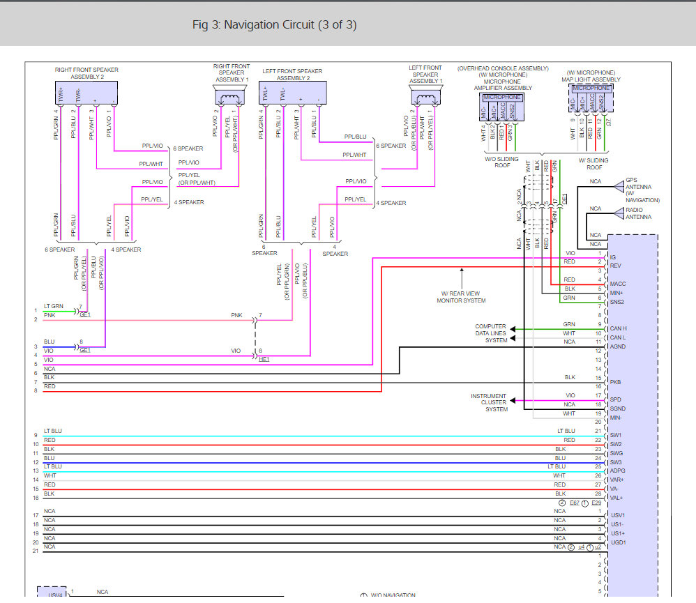

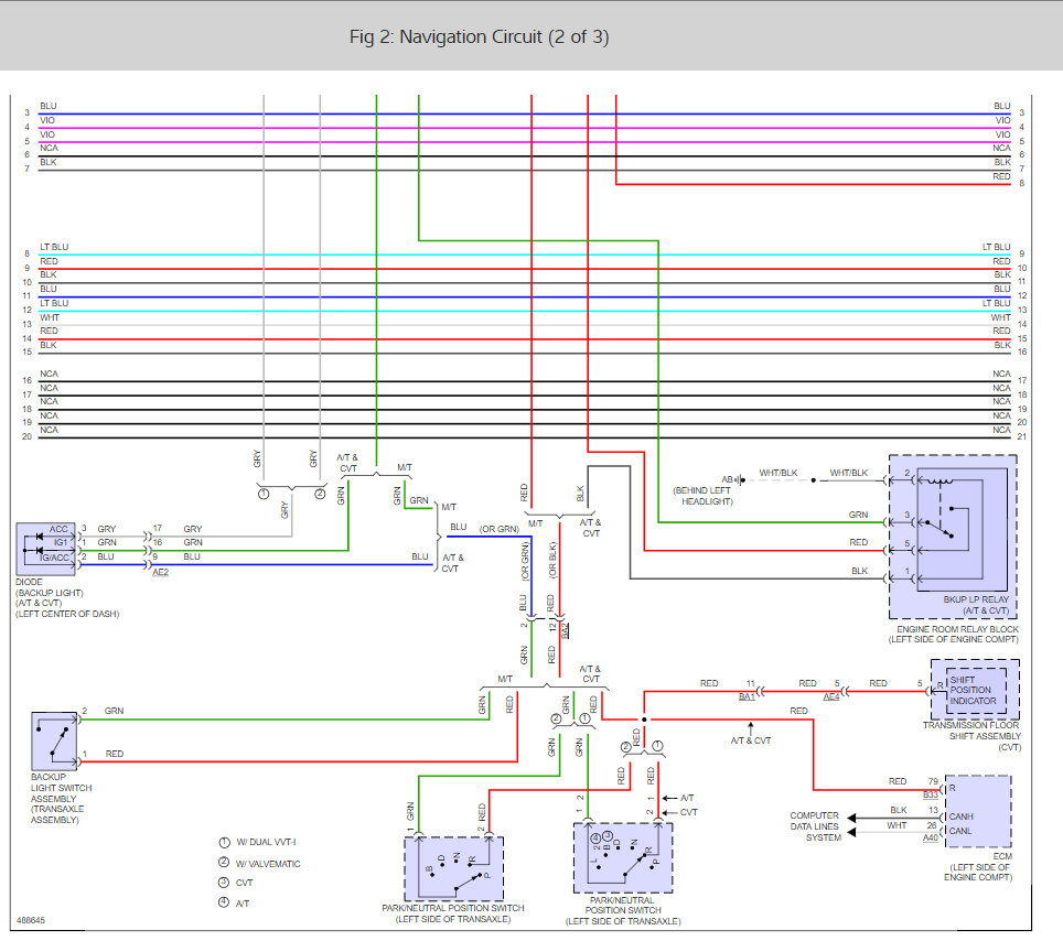

When put for gear reverse the camera does not display on screen. How to fix it?
Aug 21, 2017 at 9:08 AM
Experienced Mechanic
55,561 POSTS

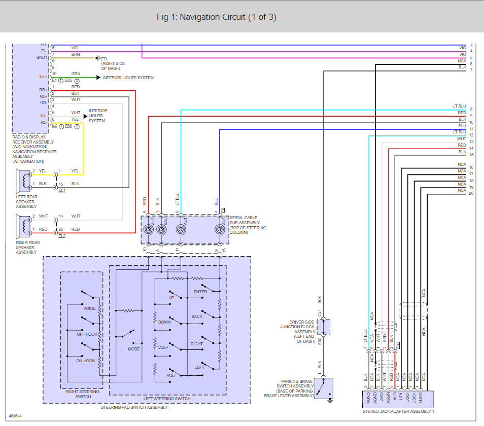

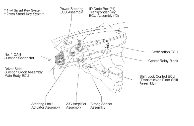

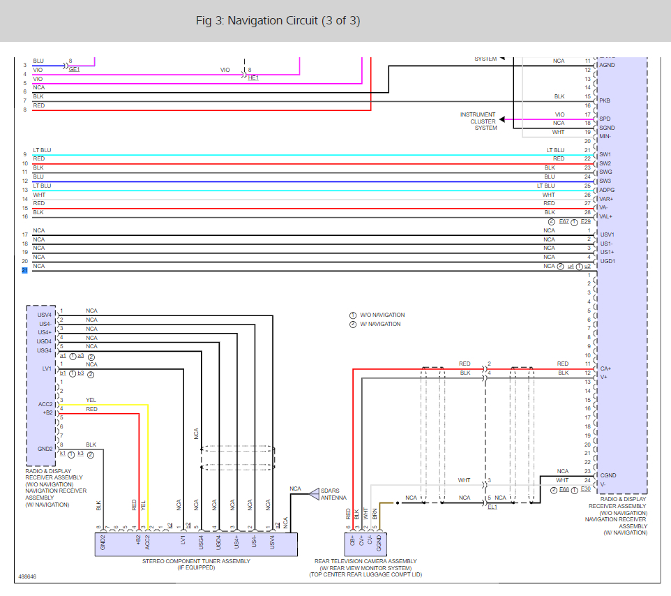

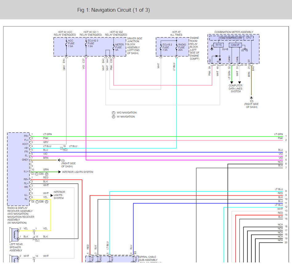

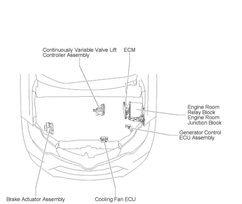

I would start by checking the fuses. the system could have had a surge which knocks out the fuse.
Here is a guide and some diagrams (below) that will help us get the problem fixed:
and
Images (Click to enlarge)
