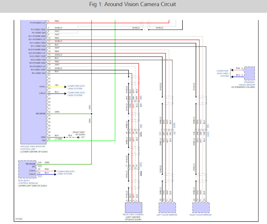

It sounds like the around view monitor control unit had a voltage surge when the new battery was installed or when the car was jump started which happens. I would replace the around view monitor control unit to fix the problem, but to be sure you should do a CAN scan which is easy. You can get a CAN scanner (Controller Area Network) from Amazon for about $36.00.

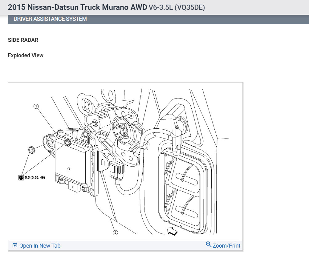

I have included how to change the around view monitor control unit out in the images below.
SIDE RADAR
Removal and Installation
REMOVAL
1.Remove the rear bumper fascia. Refer to "Removal and Installation" See: Rear Bumper > Removal and Replacement > Removal and Installation.
2.Disconnect the harness connector from the side radar.
3.Remove the nuts and remove the side radar.
INSTALLATION
Installation is in the reverse order of removal.

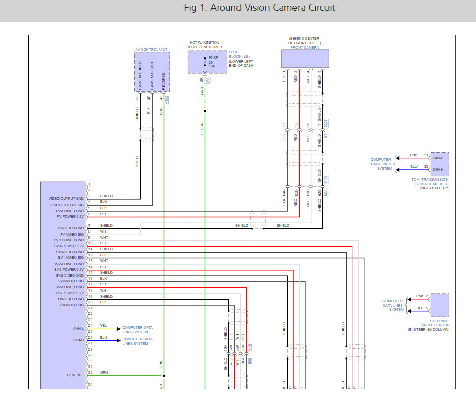

Here are the wiring diagrams for the cameras so you can see how the system works. Check out the images (below). Let us know what happens and please upload pictures or videos of the problem.

Looking at it the image I provided is for the side radar, the main unit is interrogated with the screen module. I don't have a price on this unit, but I would see if there was a used one available on Ebay. Let me know what happens.

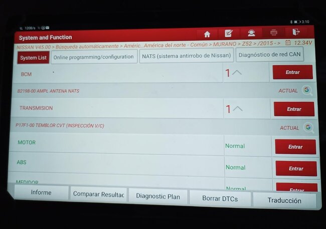

Just thought I'd mention that a dashboard light illuminated after changing the camera monitor. I couldn't leave the car so will take it back to the mechanic next week. He said he'll fix the problem at no charge. The monitor is functioning great.
I have a screenshot of the scanner. It shows the code is under BCM and is B2198-00 AMPL ANTENA NATS. Is the fix as simple as going into the scanner and shutting off the light on the dashboard?

He must have initialized the camera, I don't see the screen shot though?

I just uploaded the screenshot, but it's not showing up. I'll try again.
