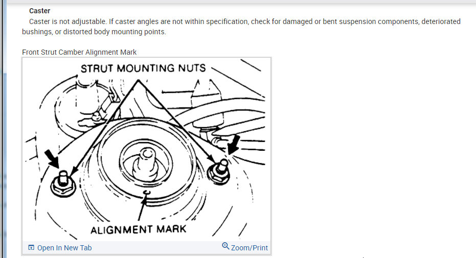

Since toe alignment was done and the steering rack was centered, the car has been driving straight down the road without pulling to the left or to the right until recently when I heard the tire skidding on normal pavement. The tires are being cupped or scalloped towards their outer edge, and the rubber is being peeled off in thin wire-like strips. That's less than 2 months of little and normal driving (a total of few hundred miles).

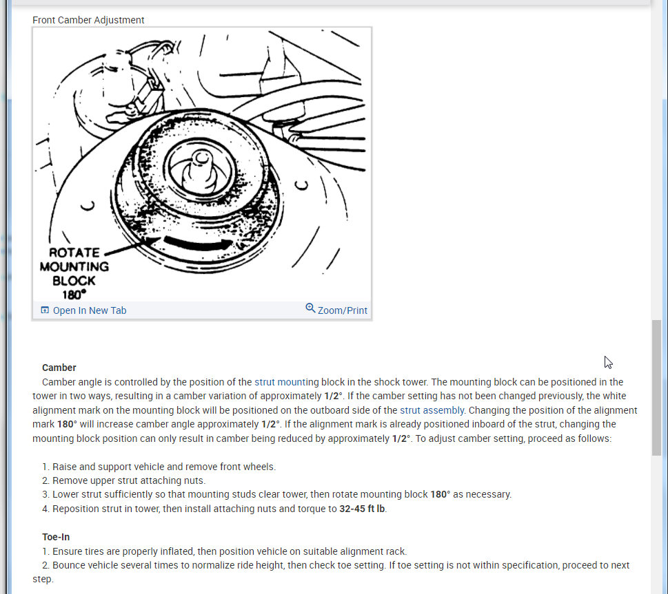

Before me noticing any misalignment or tire wear problems, I had planned to overhaul the front wheel-brake-suspension system. In fact, I just received the parts, but I am hesitant to proceed with this now even though replacing the front suspensions may take care of the problem. So, I am trying to understand and diagnose it before I replaced anything. I think this is most likely Camber misalignment. The wear is all around the outer edge of the tires (the front ones). After rotating the tires, the front ones that were in the rear developed the same exact wear in a matter of one week. I know the camber on this car is 1/2 degree increase or decrease.
1.But how do I know where the original marks were? I don't see them on the strut mount brackets. How do I know what direction to rotate the brackets to correct the camber misalignment (it says "rotate it by 180 degrees")? But when looking at the camber diagram for this car, I feel that the setting if still in the original position then it maybe at its extreme 1/2 degree positive camber and turning the mount bracket by 180 degrees to the left will give the tire an inner edge wear instead. I don't feel confident as to how to proceed here? The problem was compounded when an alignment mechanic looked at the rear beam visually, and told me "that needs replacement." He didn't speak much English, but I think he was pointing towards the rear axle beam. I didn't notice problem with the rear tires. But anyway, I can't find rear wheel axle beam anywhere online or at any of the auto parts stores. But when I searched for Kia or Mazda parts of the same, I got the part I am looking for (visually). I am not certain how (and where) to order the ford aspire part though.
2. Do you have any advice? Interchange guide (maybe?) because I can't get my hands on an interchange guide for the rear wheel system? I don't think it is wise for me to replace the undercarriage wheels, brakes, axles and suspensions only to find out the chassis is bent or something to that effect.
3. Should the car then be taken to a body shop first to ensure "square" chassis? Would that be un necessary at this stage? Or to be taken to an alignment shop to evaluate bent or problematic wheel and or suspension system?

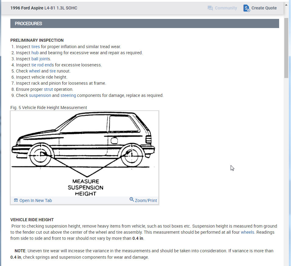

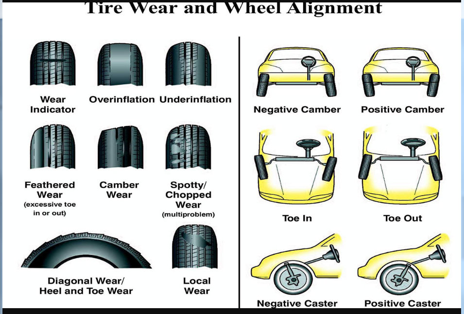

All great questions. I think the best course of action is to have an alignment performed by a knowledge shop and not just someone that is going to make the numbers green on their screen and ship the vehicle.
The reason is, you need to have some evaluate what is happening to the tires and then adjust the alignment so this is not continuing to happen.
I doubt you will be able to adjust this type of suspension without having it hooked up to a machine to tell you what the actual measurements are.

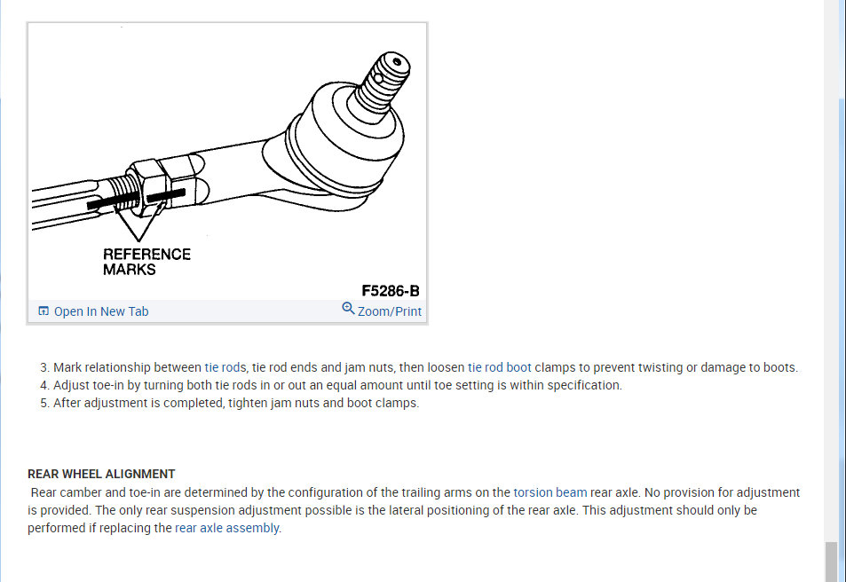

I attached the process below if you would like to review it.
Lastly, I don't think you need to have the frame checked unless the alignment is correct and the tires are still cupping.
Take a look at this and let me know what questions you have. Thanks

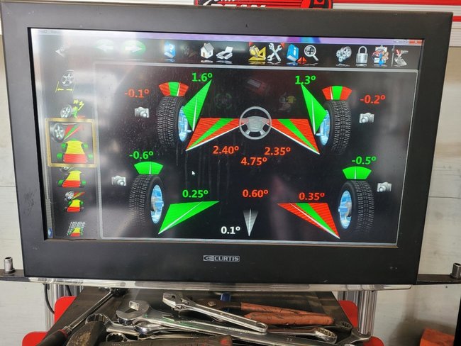

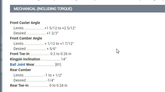

Now, I have done front toe alignment the old way many times before, and I seem to get it really good every time (but not without trial and error). This one is something else. Here is my understanding of the results NTB gave me. Please correct me where applicable because I tried to ask and couldn't get answers.
1. I cannot correct Caster on this car, so I am going to leave it alone until I replaced everything undercarriage

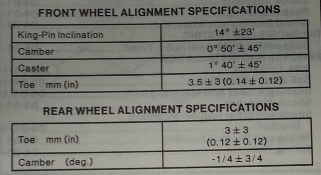

2. Camber: the reading shows -0.2 degrees on the right and -0.1 degrees on the left. The manual states 0 degrees 40 minutes +/- 45 minutes (I understand this to be +0.08 degrees to +1.58 degrees interval; this means the camber cannot be negative or leaning towards the center and must be leaning outward away from the center by 0.08 to 1.58 degrees). In this alignment image, I learned the camber is incorrectly leaning towards the center on both sides (contributing to additional outer edge tire wear), and it needs to be adjusted (which I will do when I replace the suspensions). Either I am totally off or these numbers need to be halved if the numbers are for total camber? I doubt I am correct but I tried.
3. Looking at this image, the toe-in numbers are way out of spec: the manual for this car states 0.14 +/- 0.12 inches (again I am assuming these numbers are total toe-in) meaning the toe on each side (as well as the total toe) must be positive. In this case, I learned that the wheels are toed in almost equally but to the extreme (+2.35 degrees on the right and +2.40 degrees on the left). Now, these are in degrees and the specs 0.14 +/- 0.12 are given in inches. So, I went ahead and calculated the angles equivalent to these numbers, and I get the front wheels have to have positive toe-in between 0.26" and 0.02" or +0.57 degrees and +0.044 degrees (again that's total toe-in). Since the right toe is +2.35 degrees, it needs to be reduced to somewhere between +0.57 and +0.04 and divided by 2 or between +0.29 and +0.02 degrees. Likewise, the left front toe is +2.40 degrees and needs to be reduced to the same or between +0.29 and +0.02 degrees. Am I close?

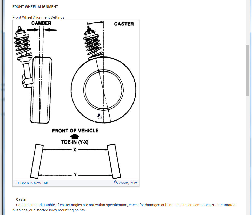

Wow. What an update. I appreciate you posting that for all others benefit but you are on top of it and don't need much help other then confirmation that you are correct.
If your tire wear was cupping/scalloping/feathering on the outer edges that this a toe issue. So you are exactly correct on how much to adjust the toe. This can be done the old school way with a tape measure and patients but I always prefer to use the alignment machine. The last one that I had done, I actually contacted the owner of the shop and asked told them my experienced and asked that I could work with the kid that was doing it. Basically I stood to the side and he adjusted it as we talked about it.
I attached some other documents that will help with this as well.
Please let us know how this turns out.
