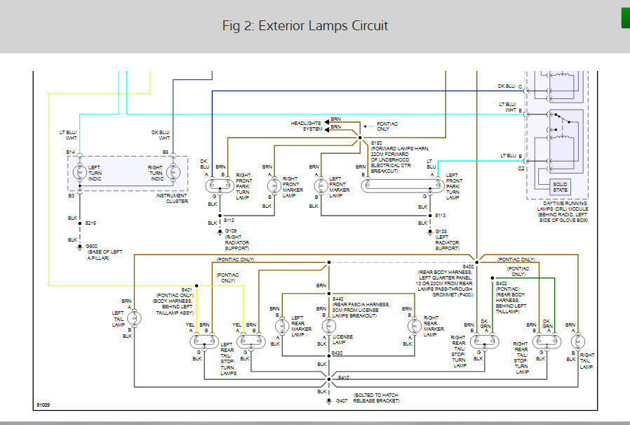

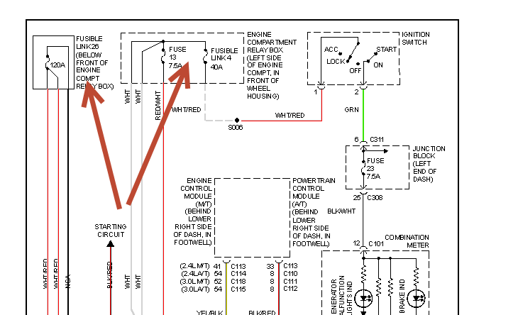

Hi i have the v6 3.8L engine. My turn signals don't work,the hazard lights work both front and rear. i see the lights blinking on the cluster but when i turn on the turn signals on the cluster it doesn't even light up. the front and rear turn signals don't light up either. Can anyone help?

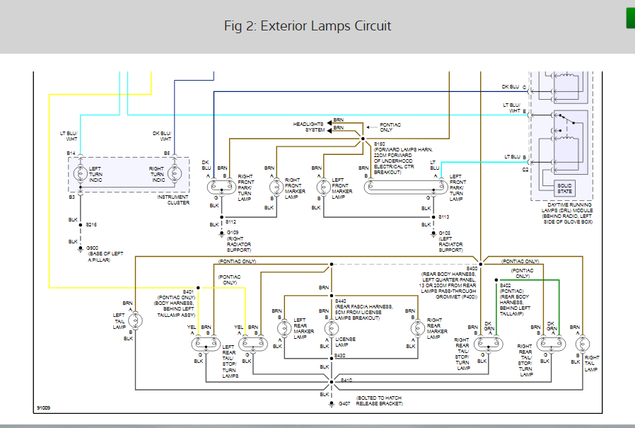

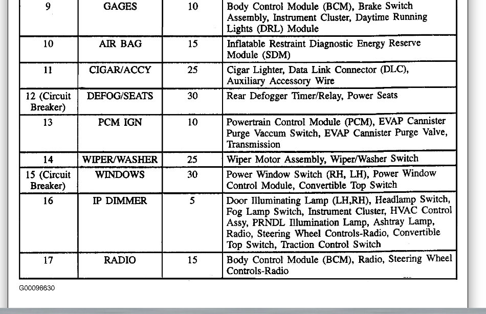

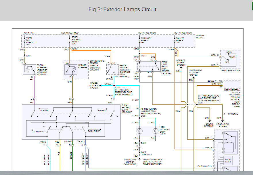

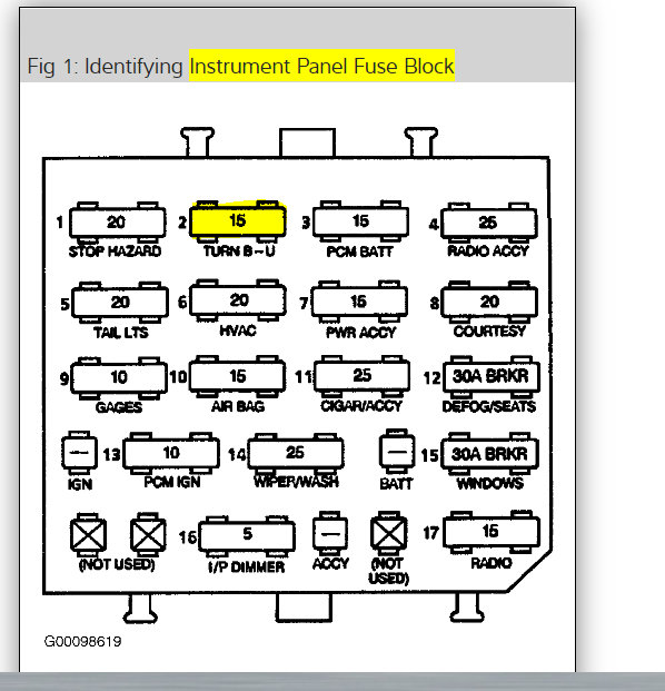

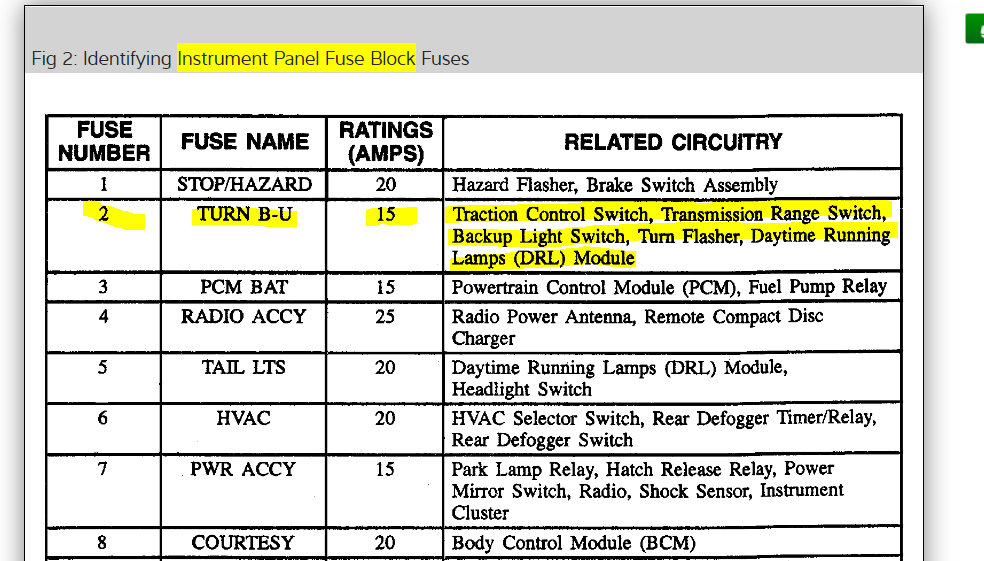

This could be a problem with your vehicle's Turn/BU Fuse #2 of the I/P fuse panel which is located behind the left side of the dash. In the diagrams down below I have included a wiring diagram of your vehicle's Exterior Lighting Circuits as well as a diagram and callout of your vehicle's I/P Fuse Panel. Here is a link for you to go to, if needed, for how to check a fuse.
Please go through these diagrams and get back to us with what you are able to find out.

Got it thanks! Actually i found the issue it was the blinker relays underneath the steering wheel were bad then i got some from the junk yard and now it works! Thank you!!

Your turn signals are on a different fuse from the hazard lights. Check the fuse its the 20 amp one on the top row.

check fuse #2 (20 amp)if that fuse and the signal switch and bulbs are good along with relay flasher than it must be a wiring issue, that is all thats left on the signal circuit.
