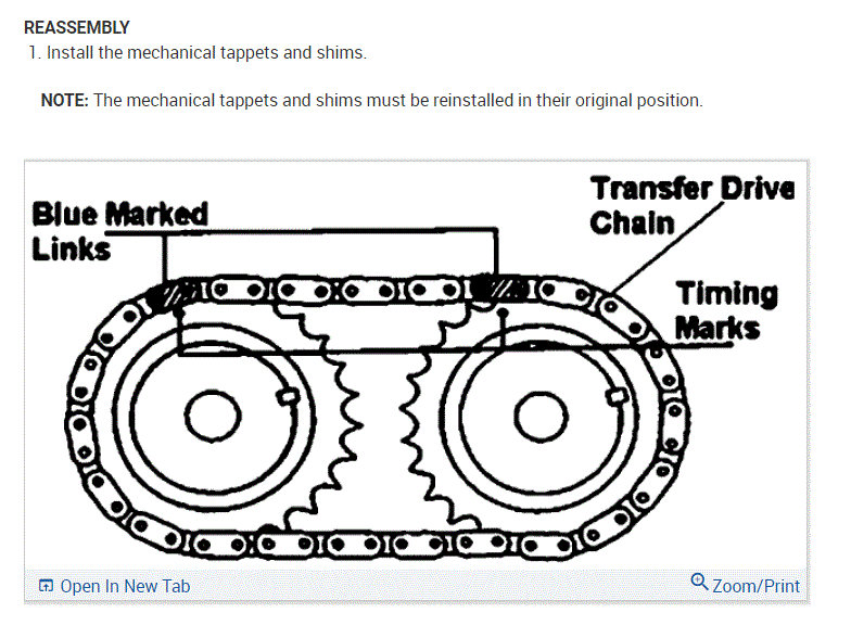

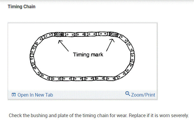

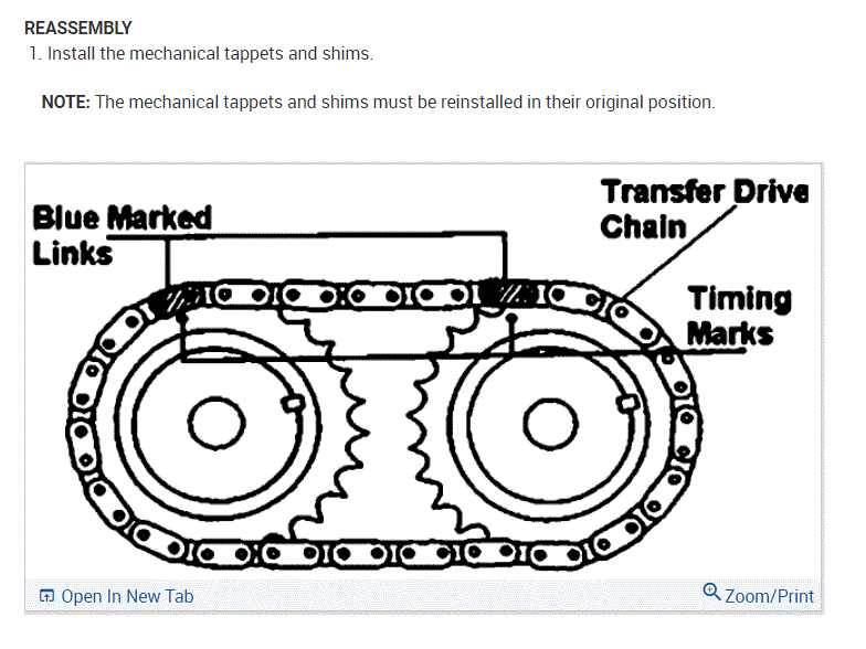

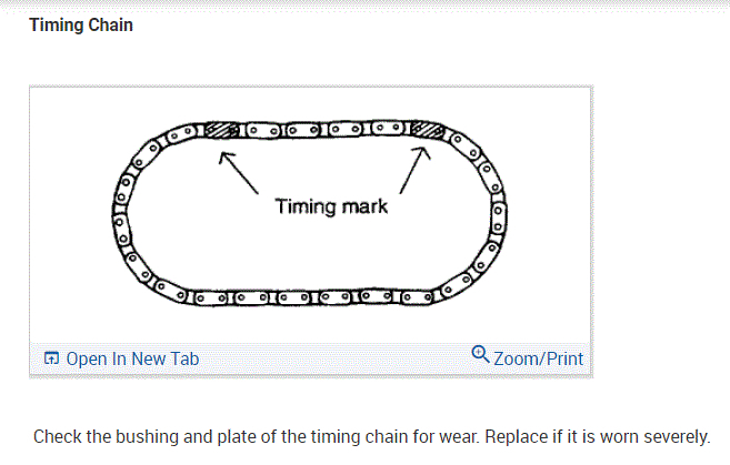

I need a picture of cam shaft timing marks and how they should go.

Take a look at the pic below and let me know if it helps. These pics are the best I could find.

That's the one I was looking for. Ordered a refurbished head off of eBay and when I got it there was not a chain on it. Wanted to double check that I put it on right. Thanks
