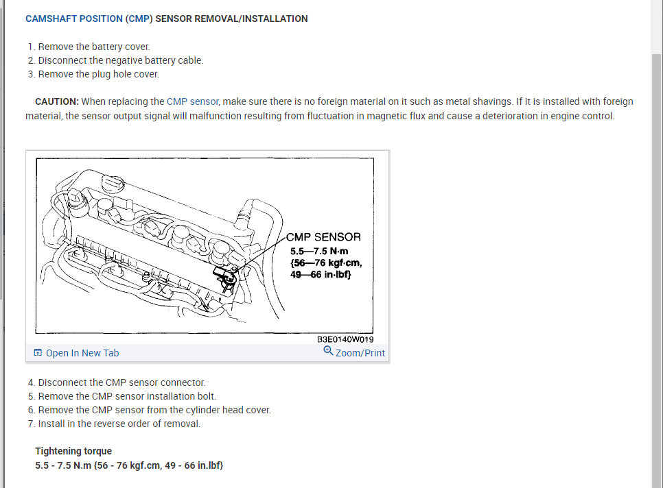

Can i know the position of the cam sensor on the car listed above 1.25l?
Thanks
Jun 20, 2021 at 8:45 AM
Unfortunately we don't have a manual on this engine as it was not offered here in the USA so we need to start with getting some pictures of the top of your engine so that we can see if we can locate it.
Below you will find the the info on the cam sensor on the engine that is offered here in the USA. I suspect the cam sensor is located in the same general location on your engine.
Please let us know about this and we can go from there. Thanks
