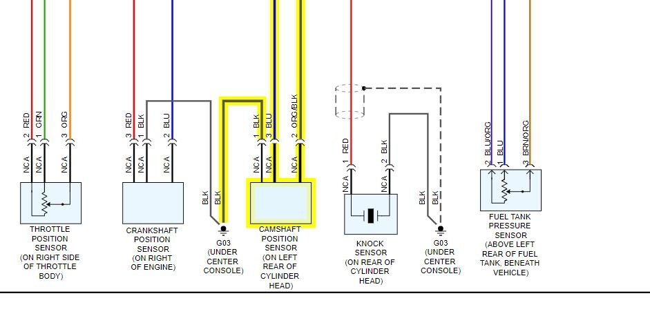

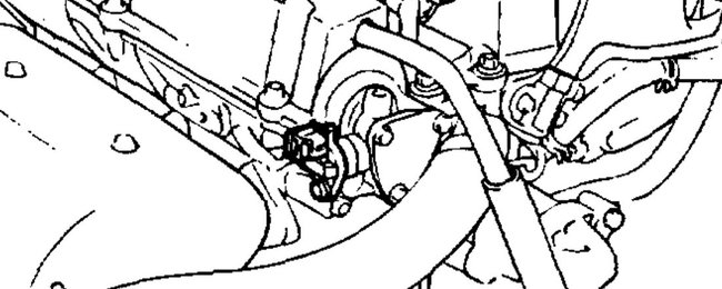

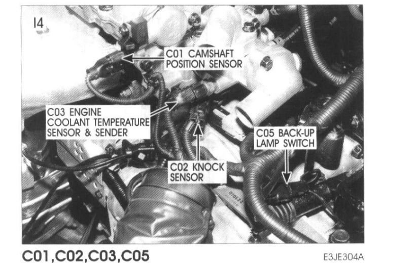

The wiring for the cam shaft sensor should be in what position? we have a blue which is hot orange wire in the middle and black wire on the bottom but the replacement plug show a red for the top black for the middle and green bottom. all the wiring diagram shows the blue top orange center and black bottom. can any one tell me in which order it actually goes?
Apr 4, 2020 at 2:28 AM
Good afternoon,
I attached a diagram and a picture of the orientation of the sensor and the wiring for you. Check out the diagrams (Below). Let us know what happens and please upload pictures or videos of the problem.
