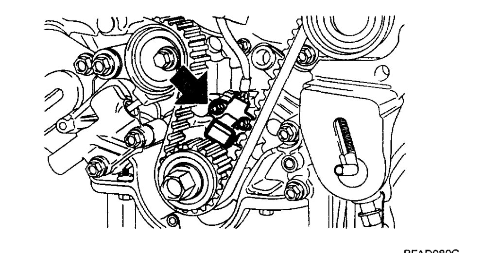

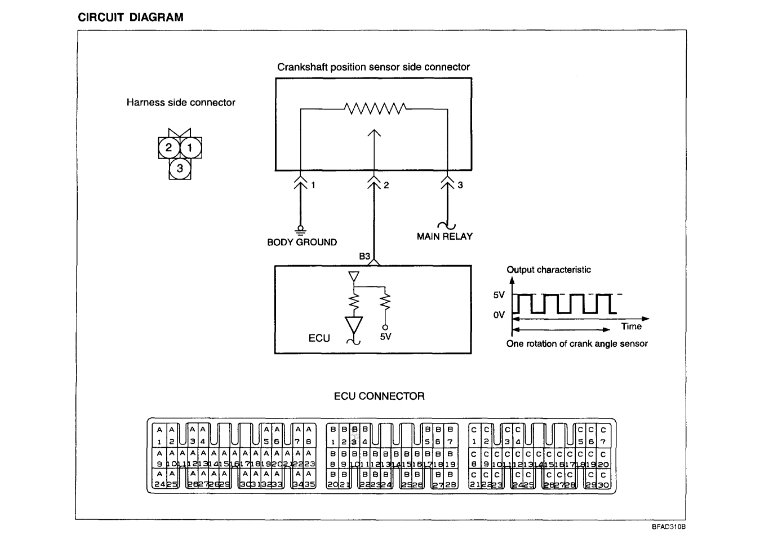

Not a cam sensor. This code is for the crank sensor.
Does the tachometer move up a little while the engine is cranking?
P0337 - Crankshaft Position Sensor (CKP) Circuit Low Voltage
KIA Motors does not provide testing procedures for this DTC.
The crankshaft position sensor is a Hall-effect sensor that senses the crank angle (piston position) of each cylinder and converts it into a pulse signal. Based on the input signal, the ECU computes the engine speed and controls the fuel injection timing and ignition timing.

I would not assume it needs to be replaced. I would have it checked first. It could be wiring or even a timing belt issue. I would have it properly diagnosed before replacing any parts.
