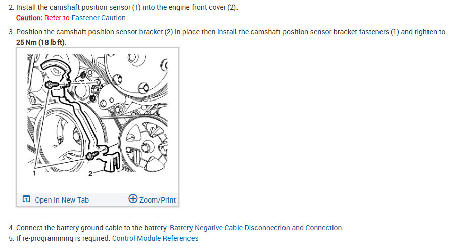

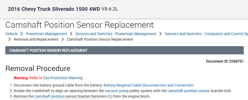

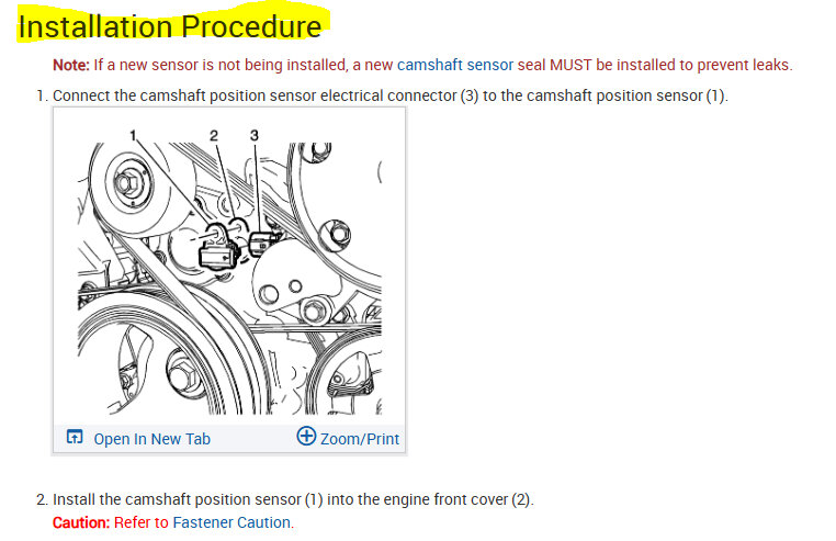

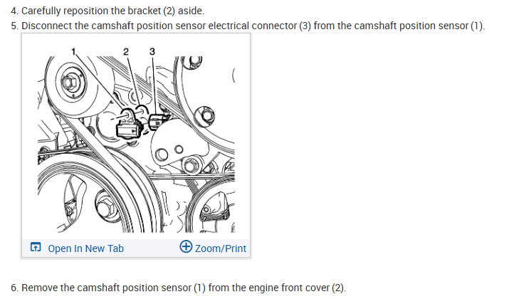

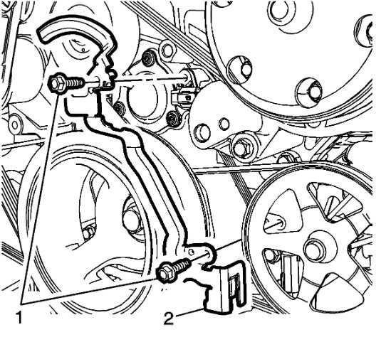

I’m having a very hard time figuring out how to locate the cam shaft position sensor on my truck. I need to replace it myself but cannot find it.
Dec 6, 2024 at 4:06 PM
  • 110,194 POSTS
The sensor is located above the crankshaft pulley. See picture two below. As far as replacing it, I attached the directions for the removal and replacement.
Take a look through things and let me know if you have questions and if this helps.
