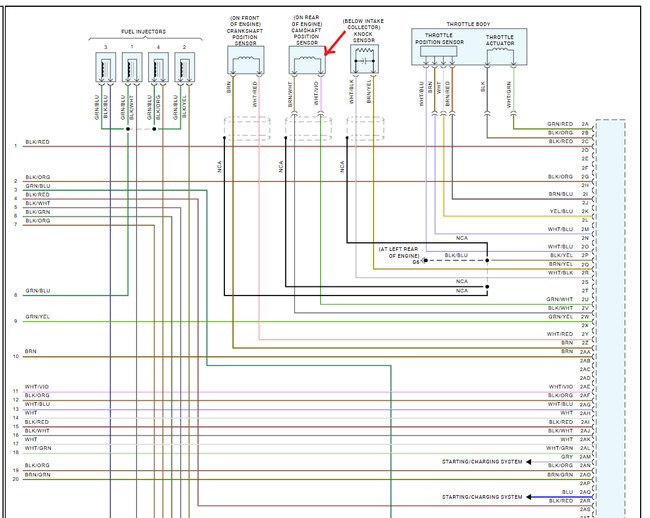

Camshaft position sensor from the sensor to the ECU I need the wire colors?
2005 MAZDA 3
150,000 MILES • 2.3L • 4 CYL • 2WD • MANUAL
HARPO1020
Camshaft position sensor wires lost I don't know where to find them I need to know when they come from the ECU what color they are and then to the camshaft position sensor.
Aug 18, 2025 at 4:37 AM
  • 55,224 POSTS
Sure, here you go but can I ask if you have a camshaft code? This guide can help you with the testing:
Here are the camshaft sensor wiring diagrams as requested. Check out the images (below). Let us know if you need anything else.
