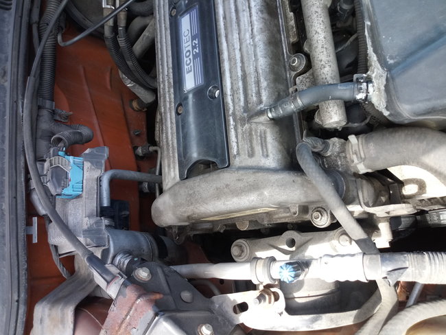

I looked but didn't see anything in that area. i also uploaded a picture.

I looked but couldn't find the sensor.

you need to remove the coil housing cover (the top piece).

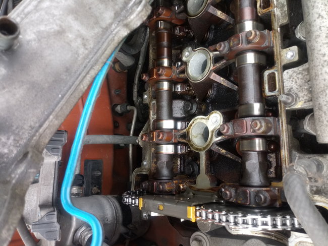

Still no luck unless i'm still in the wrong location. I added a photo so you can see what i'm looking at.
May 25, 2021 at 3:25 PM
  • 54,832 POSTS
thanks. yep, it is not there. can you look toward the rear of the engine or send a pic please?

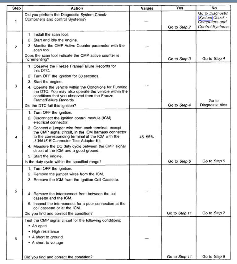

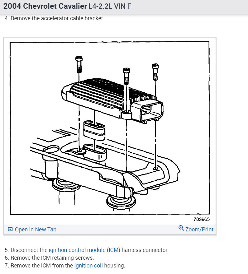

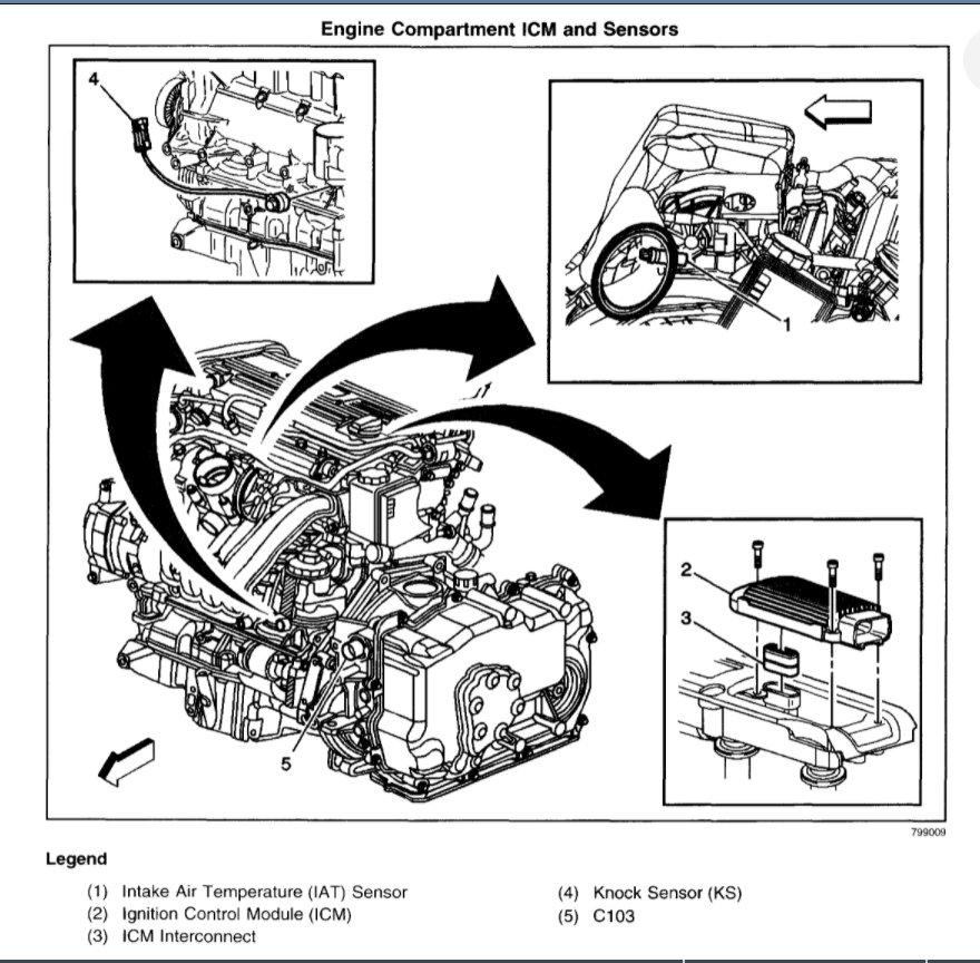

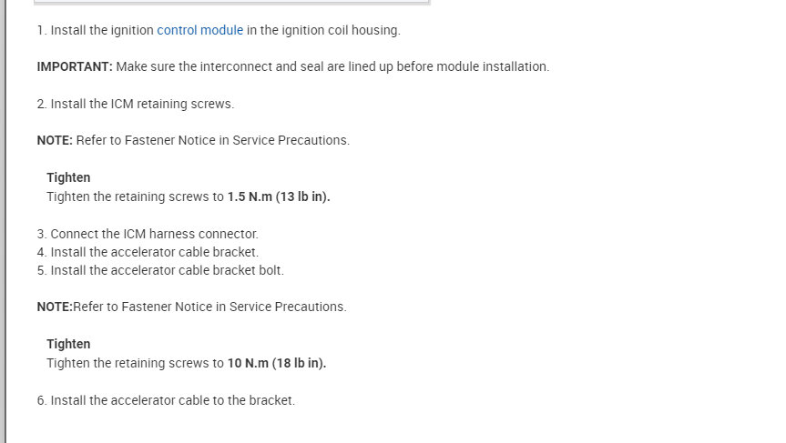

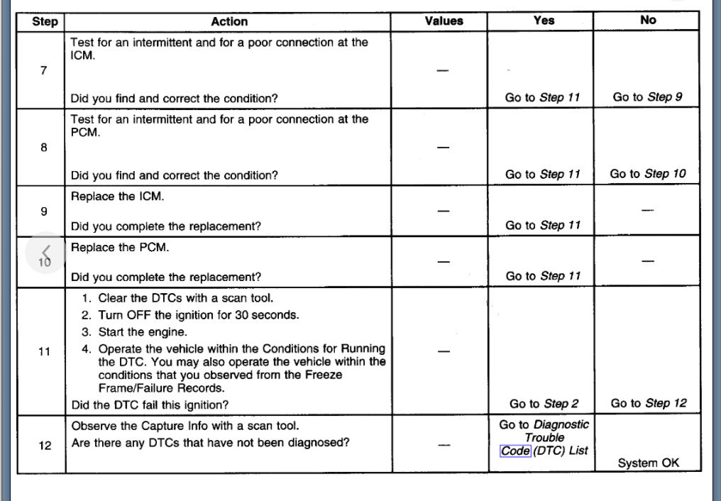

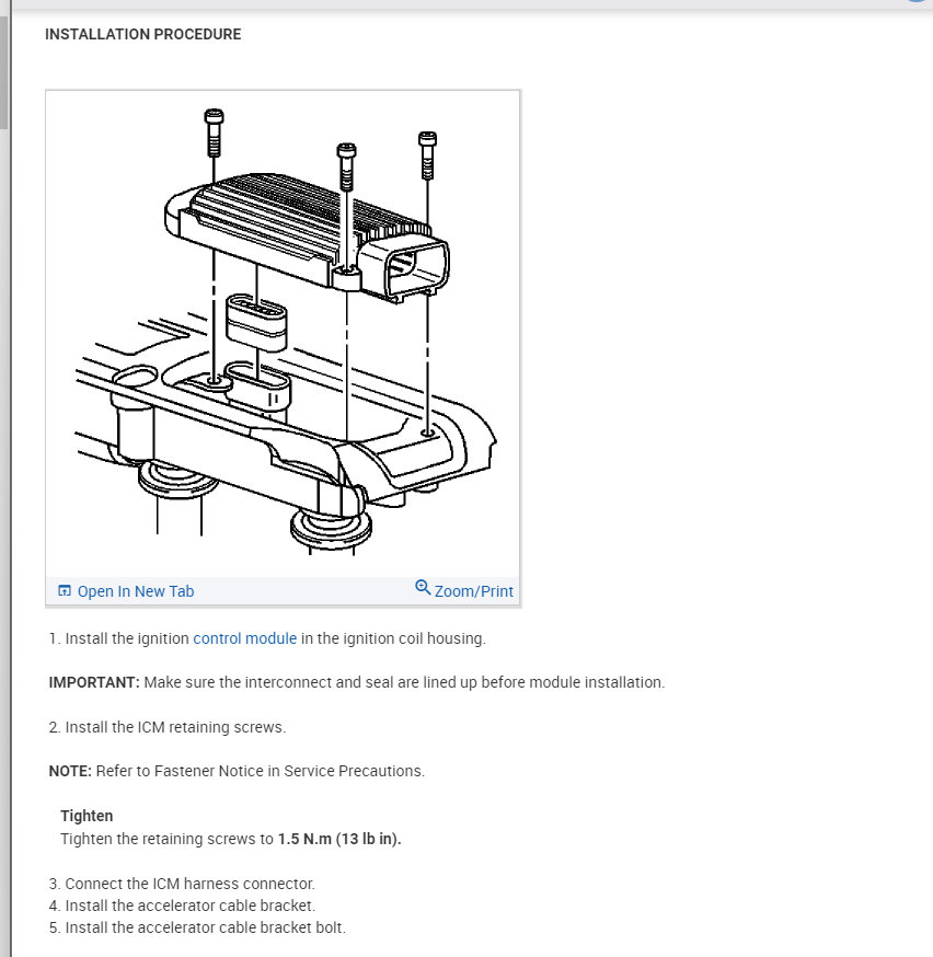

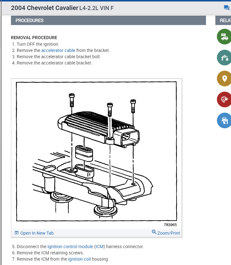

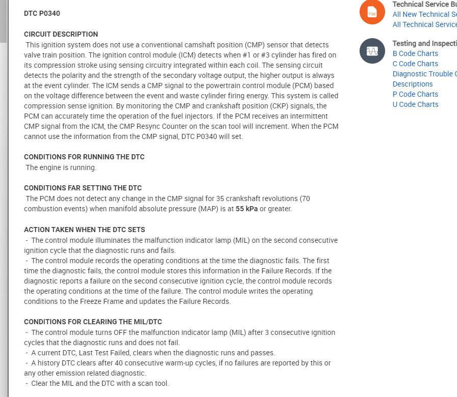

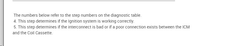

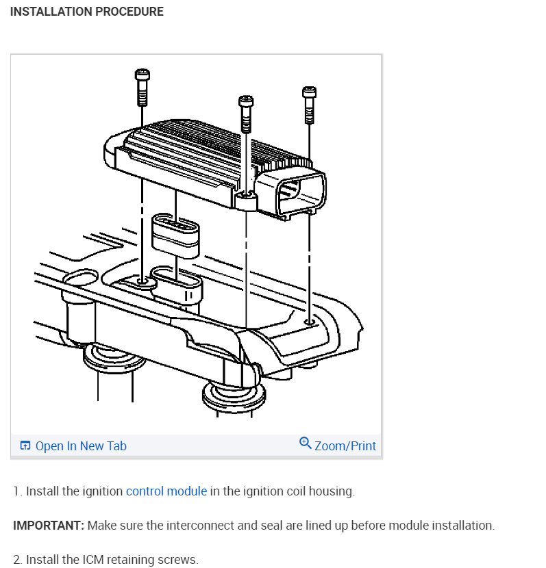

Just to jump in on this one. The CPS is part of the ignition control module on this engine.
I am attaching the info below on how to find this but also the testing for this code because it may not be the ICM as the issue.
So, I would suggest running through this test and see what results you come up with.
Let us know what questions you have.
Thanks

Thanks Kenny, "The CPS is part of the ignition control module on this engine"
