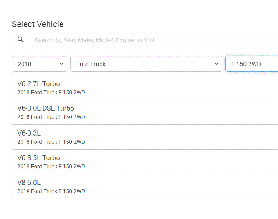

Trying to locate the camshaft sensor bank 2 sensor B. Please help! TIA
Dec 28, 2021 at 12:26 PM
  • 110,244 POSTS
I need to know which engine is in the truck. There are several that were used. See pic below.
Dec 28, 2021 at 12:32 PM
DYMOND24
V8 5.0.

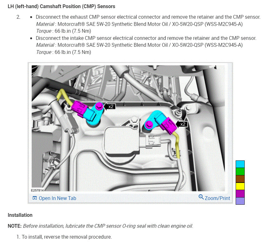

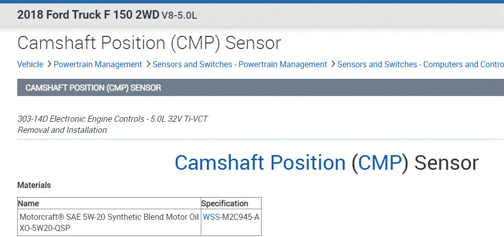

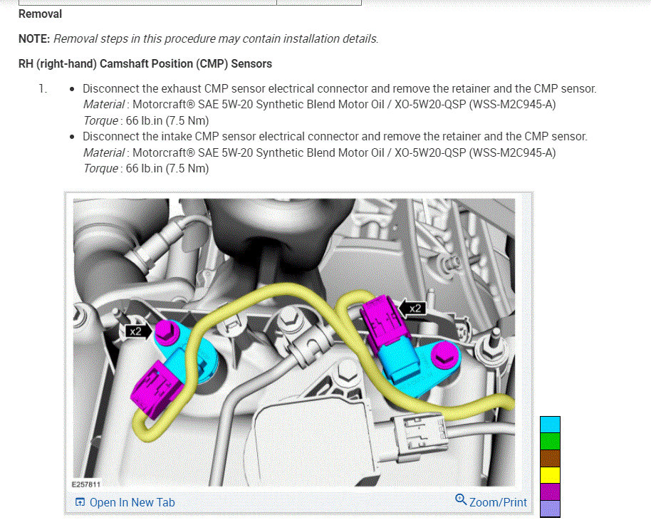

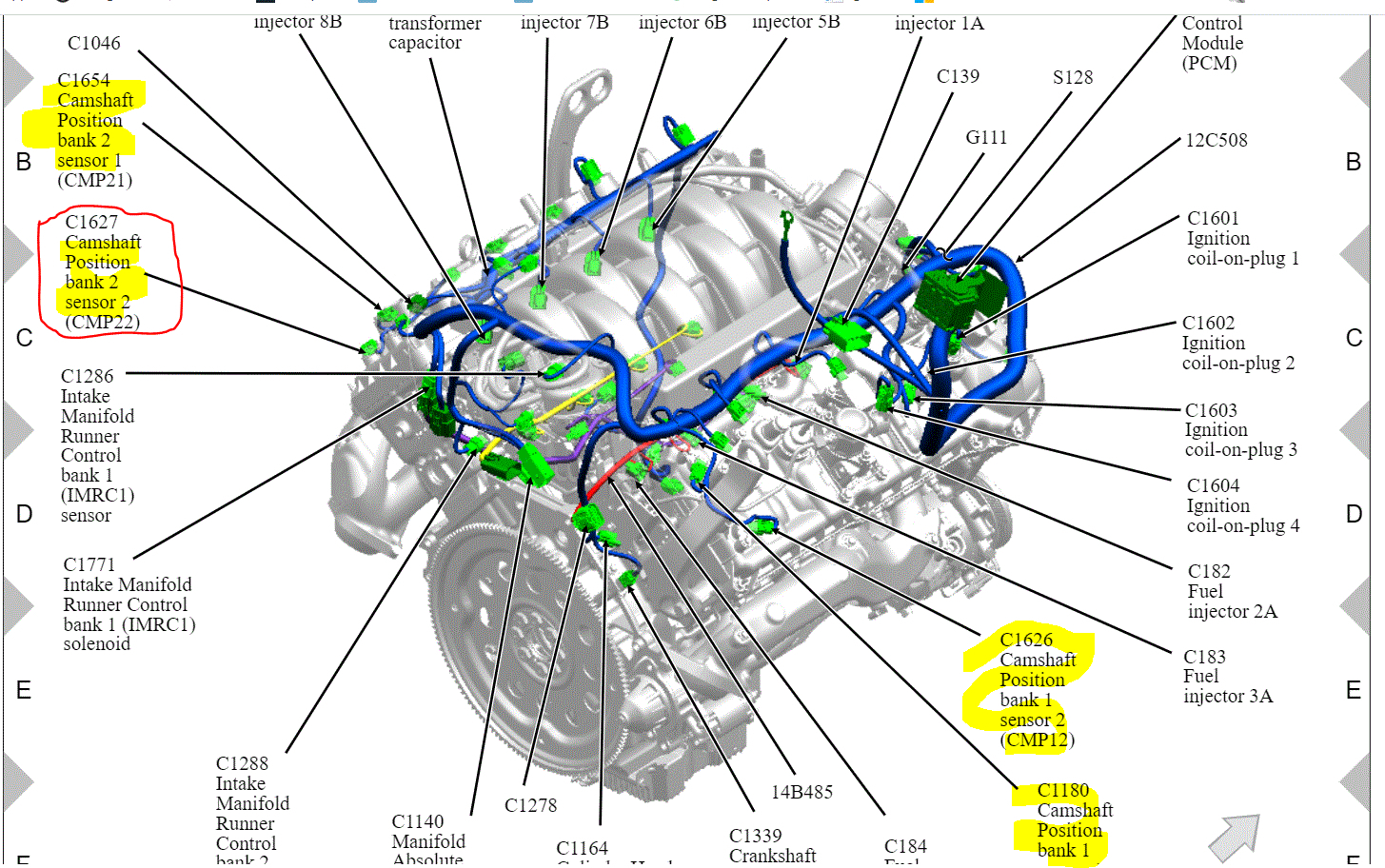

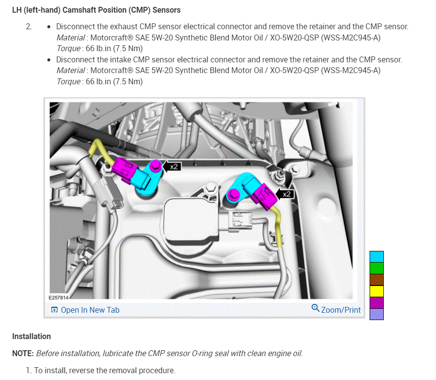

If you look at the pic below, I highlighted all 4 cam sensors. I highlighted and circled the one you are asking about. (See pic 1)
The remaining pics are the directions for the removal and replacement of the sensor.
I hope this helps. Let me know if you have other questions and if this solves the problem.
