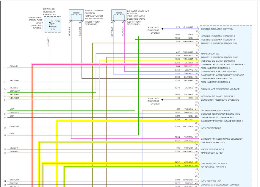

need description of wires for cam sensor pigtail.
Mar 18, 2023 at 1:24 AM
  • 110,194 POSTS

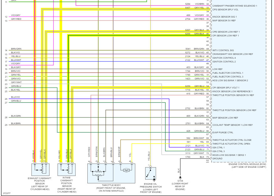

I'm not sure exactly what you are looking for, but I did attach the wiring schematic related to both the intake and exhaust camshaft sensors.
I highlighted the wiring between the sensors and the powertrain control module so you can follow them easier.
Let me know if this is what you needed.
See pics below. Note: I had to cut the page in half to make it readable for you. I did overlap them so you can follow from one to the next.

Thank you much! On the 3-wire connector I'm getting 5.1v on pin A, Pin B is ground, and pin C is reading 5.2v. Well either pin A or C should run 12v. I wasn't sure which one is supposed to have 12v. The wire schematic should help greatly. Thanks again.
Mar 21, 2023 at 12:59 AM
  • 110,194 POSTS
The sensors receive a 5v reference. If they would get 12v, it would cause sensor failure.
Let me know if that is what you needed.
