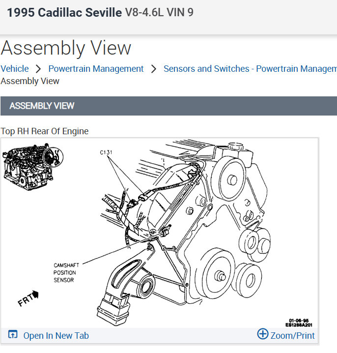

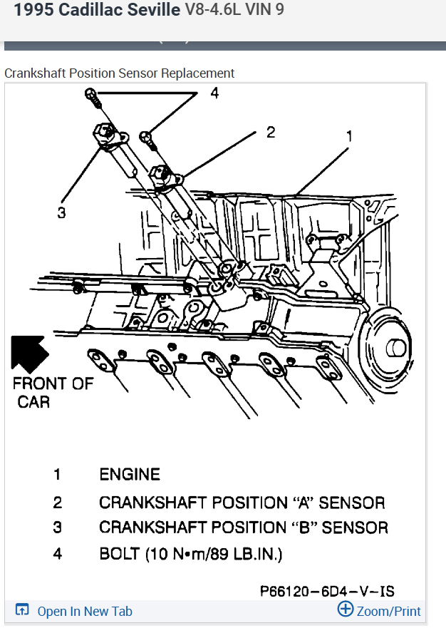

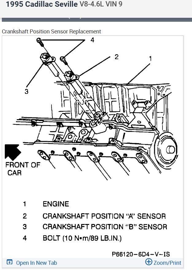

Where are the Camshaft sensor and crank sensor located?
1995 CADILLAC SEVILLE
191,000 MILES • 4.6L • V8 • 2WD • AUTOMATIC
BOB DAVIS2
Camshaft sensor and crank sensor locations?
Mar 23, 2025 at 3:02 AM
  • 55,402 POSTS
This engine has 2 crankshaft sensors and 1 camshaft sensor. The camshaft sensor is at the right side of the engine near the front of the valve cover, the two crankshaft position sensors are located on the front bank of the engine block between cylinders 4 and 6. Check out the images (below). Let us know if you need anything else.
Mar 23, 2025 at 9:10 AM
BOB DAVIS2
Do I have to take the valve pan covers off?
Mar 24, 2025 at 2:11 AM
  • 55,402 POSTS
No, the camshaft sensor is on the outside of the cylinder head.
