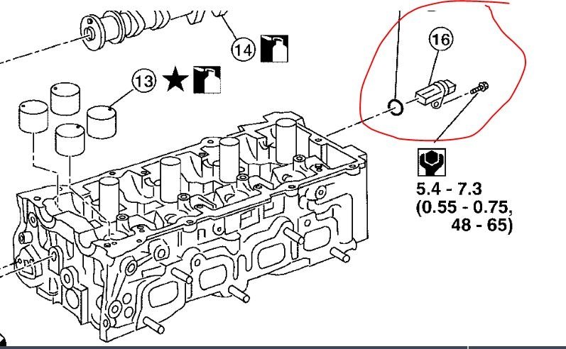

Interestingly, the cam sensor is nothing more than a magnet. It shouldn't make a difference. I attached a picture below and circled the cam sensor. Is that the part you are referring to? If it is, check the wiring at the plug. I suspect you have a broken wire that is making contact when the switch is 180° off. Or, you got a sensor that isn't for this vehicle.

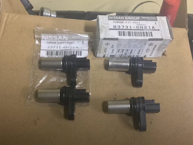

I really appreciate you taking the time to do this. I know it’s hard to solve problems remotely. Attached is the pic you requested. The sensor on the bottom right is the one that works. It was in the car when I bought it. When the car threw a P0340 code I changed it out and that’s when all this started. The one on the bottom left is the NAPA one. The other two are OEM. In testing them I found that the OEM on the top left and the one that works attract each other when put head to head. The other two repel the one that works. I don’t know if this makes any difference. I retested the plug and it’s okay. The one on the top right came in a kit of two identical sensors. (The other one is in the crank position and works good.)The one on the top left says crank sensor on the package but Nissan says it is the same as the cam sensor. All three new ones act the same as far as having to turn them 180 degrees. Thanks again for your help.

It's hard to tell. Like you said, they do look the same. I am going to get some advice from a friend about the magnets' polarity. I can't see how, but maybe that is the cause.
