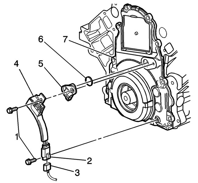

Where is the cam sensor located at on a the vehicle listed above V8 5.2?
May 16, 2019 at 10:42 PM
STEVE W.
  • 15,409 POSTS
Welcome back to 2CarPros. The CPS is on the front of the engine behind the front generator bracket. If you have a code for it I would look at the jumper harness first as the connectors get corroded.
