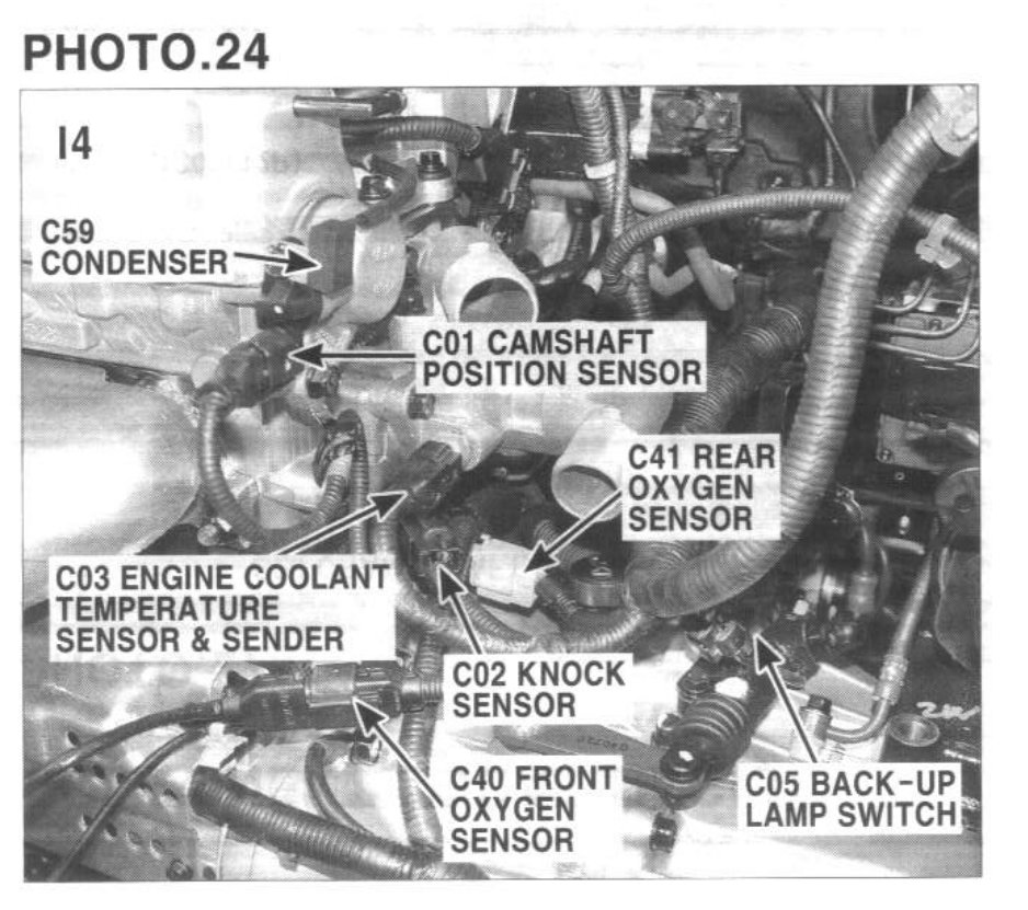

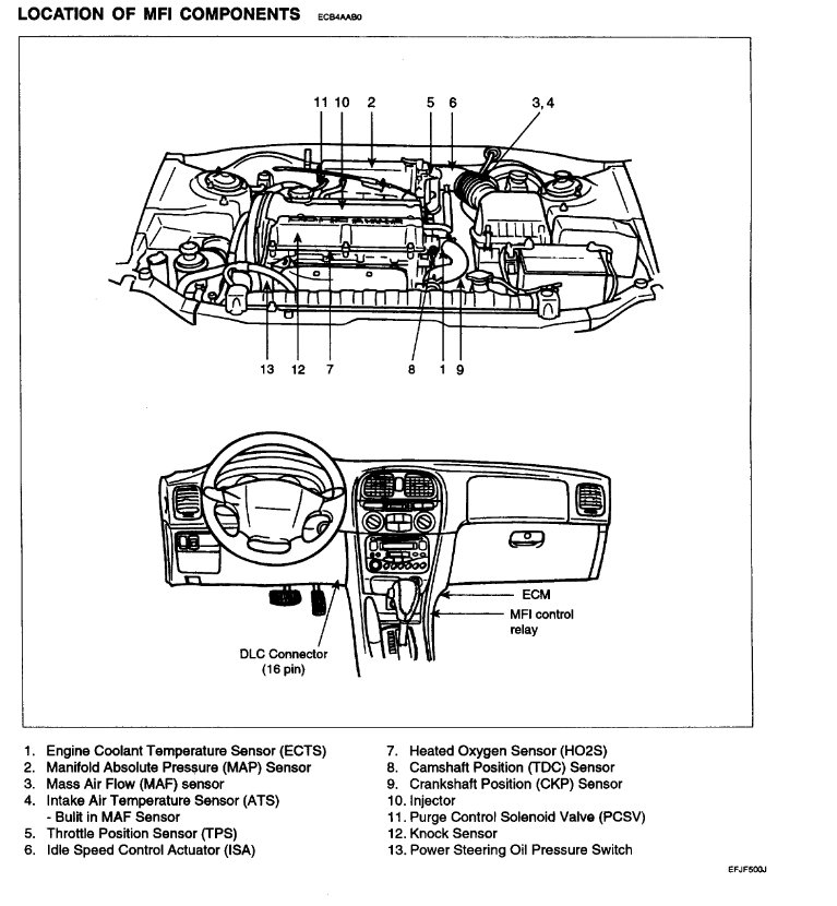

Where is the camshaft position sensor located?
2006 HYUNDAI SANTA FE
162,000 MILES • 2.4L • 4 CYL • 2WD • MANUAL
JIM MCGRATH
This car started but soon shut off after less than 5 seconds. So, we checked and got a P0342 code, which is a cam position sensor. Cleared the code and tried again with the same results. I found mixed answers, but it is still unclear as to where exactly this sensor is. I am hoping you can clarify this for me.
Thanks,
Jim
Sep 13, 2022 at 2:43 PM
  • 55,394 POSTS
Hello Jim,
Here is the location of the camshaft position sensor int he images below, click to enlarge the image. Please let us know if you need anything else to get the problem fixed.
Sep 14, 2022 at 3:41 AM
