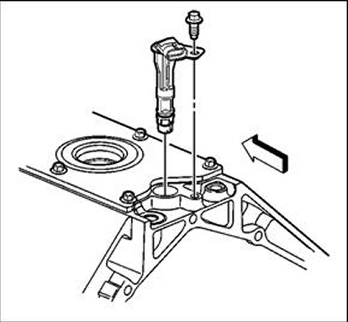

Truck will not start every time/coughs (small backfire). mechanic read diagnostic 'high voltage on or at cam sensor. Where is it located?
Dec 10, 2017 at 9:43 AM
  • 110,248 POSTS
Rear top of the engine. Check out the diagrams (Below). Please let us know if you need anything else to get the problem fixed.

This cannot be a 5.7 they did not offer 5.7 in 1999. only engines were 4.8,5.3,6.0 and 4.3.what is the eighth VIN number digit. double check and post back and I will answer your question.

could try calling the dealer and they could give you the part number. the camshaft position sensor is located at the back top part of the engine block, directly behind the intake manifold. post back with any other questions.
Sep 7, 2020 at 4:47 AM (Merged)
BRIAN 1
  • 1,030 POSTS
https://images.2carpros.com/forum/automotive_pictures/147643_cam_1.jpg

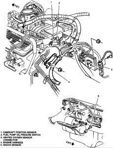

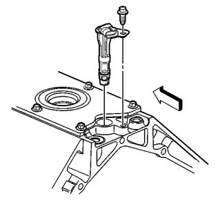

1997 Chevy Silverado V8 Four Wheel Drive Automatic
where is the camshaft sensor located
Sep 7, 2020 at 4:48 AM (Merged)
IMPALASS
  • 3,112 POSTS
Hello
First, to better assist you I need to know if this is your specific vehicle, is it a 1500, 2500 etc, and your specific engine by liter.example is it a 5.4L 6.0L 7.3L etc gas or DSL and what is the 8th digit of your VIN.

it is a 1997 z71 4x4 it has a 5.7L
IMPALASS
  • 3,112 POSTS
Hello
https://images.2carpros.com/forum/automotive_pictures/248015_1_49.jpg
