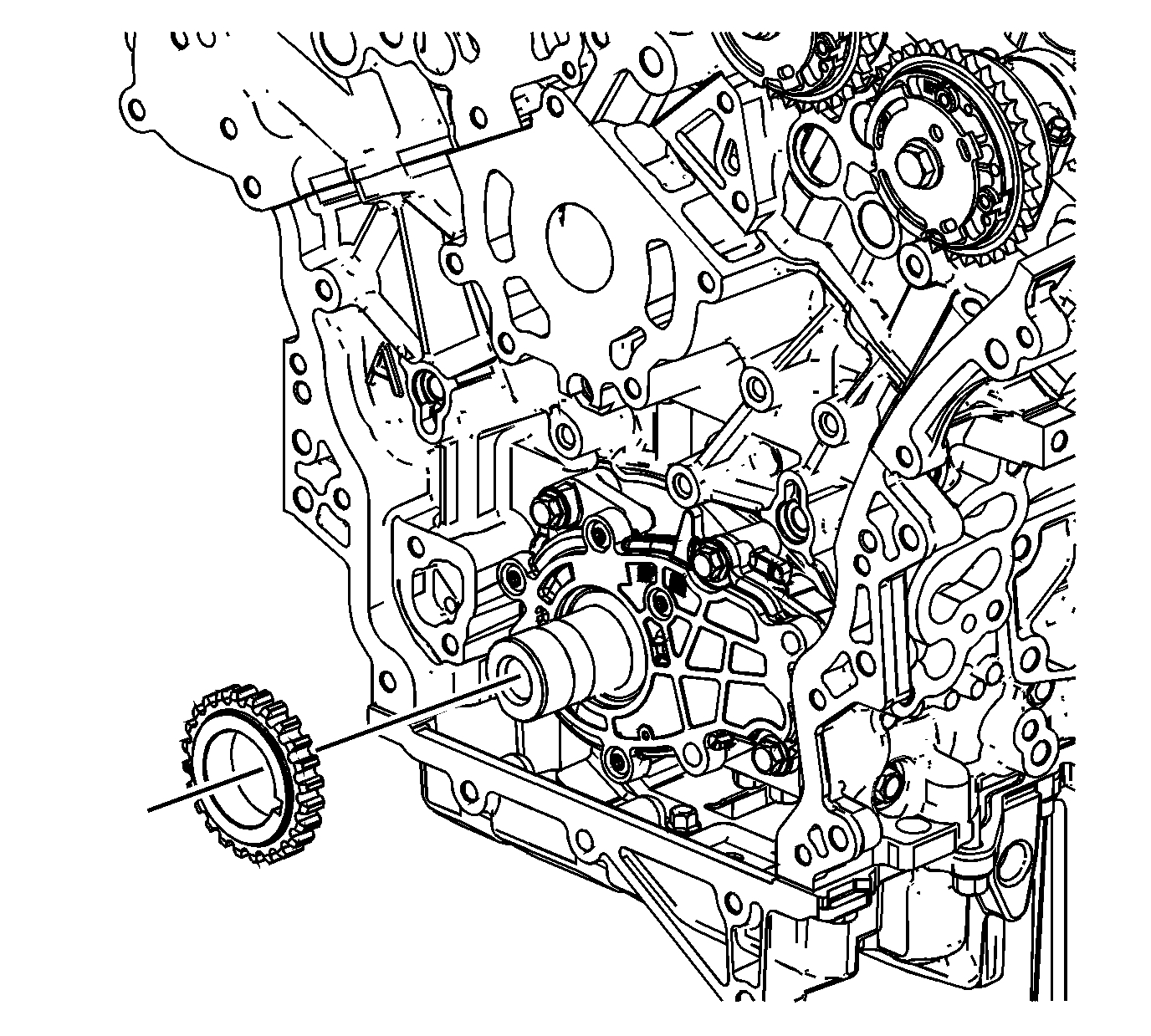

I am needing to order cam phasers for my vehicle listed above LTZ model. My problem is not knowing exactly which ones to order. I get my parts from Rock Auto, but I only see 3 of the 4 needed. What am I missing? Do I order 2 of the exhaust?
Left Bank; Intake
Right Bank; Intake
Exhaust
Aug 9, 2019 at 3:17 AM
  • 110,240 POSTS
Welcome to 2CarPros.
There is one for each cam, so there should be 4. I would recommend contacting them to confirm the exhaust actuator they are selling works for either side. As far as the timing chains, here are the directions specific to your vehicle:

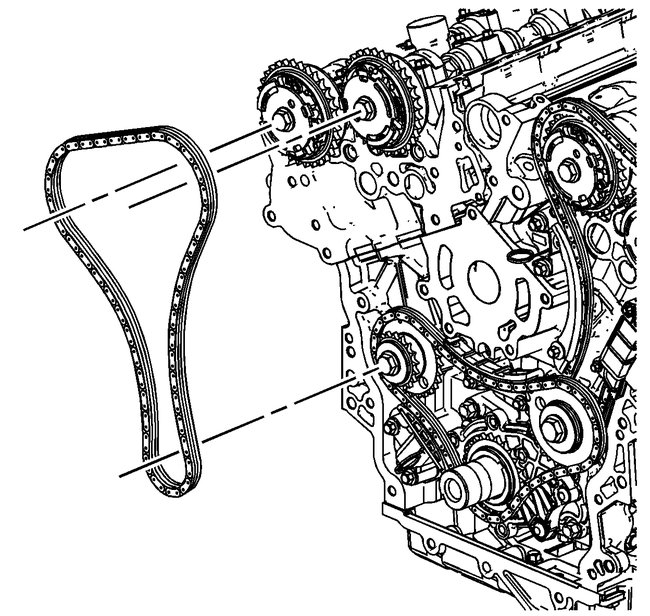

7. Remove the primary camshaft drive chain tensioner. Refer to Primary Camshaft Intermediate Drive Chain Tensioner Removal See: Engine > Overhaul.
8. Remove the primary camshaft drive chain upper guide. Refer to Primary Timing Chain Guide Removal - Upper See: Engine > Overhaul.
pic 1

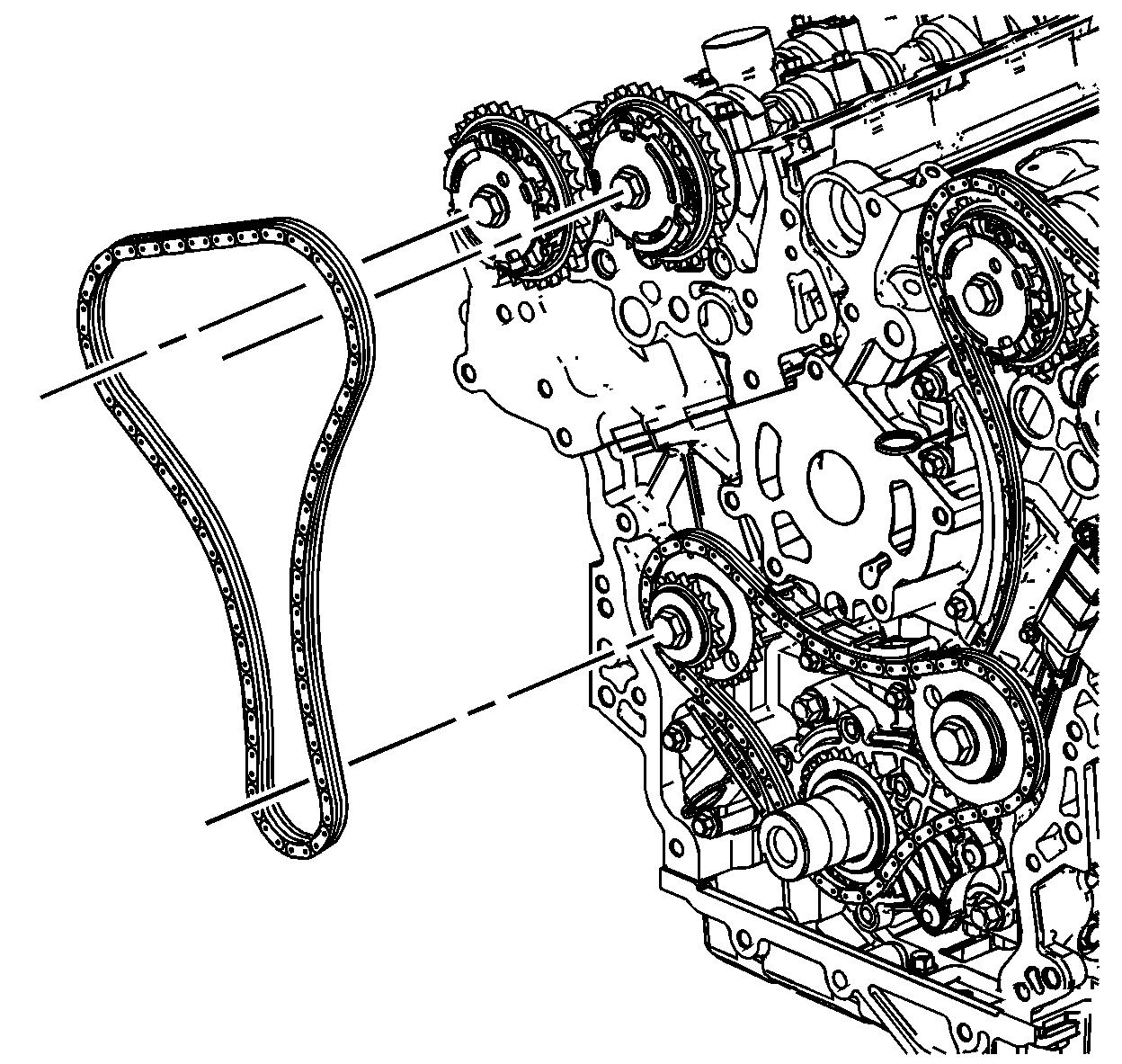

9. Remove the primary camshaft timing chain. Refer to Secondary Camshaft Intermediate Drive Chain Removal - Right Side See: Engine > Overhaul.
pic 2
10. Remove the crankshaft sprocket from the nose of the crankshaft.

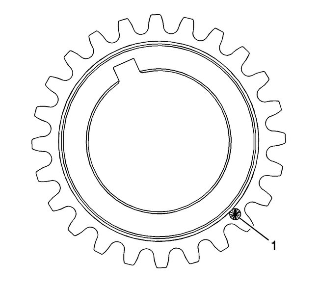

Installation Procedure
pic 3

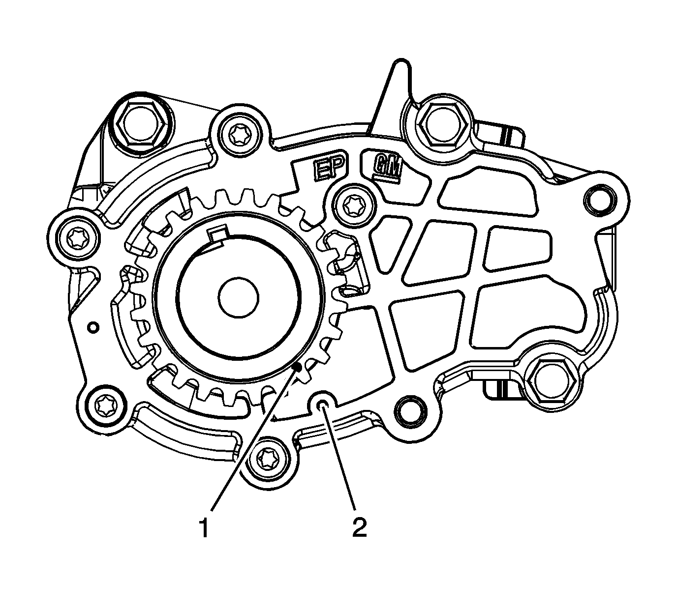

1. Ensure the crankshaft sprocket is installed with the timing mark (1) visible.
pic 4
2. Install the crankshaft sprocket on to the nose of the crankshaft.
3. Align the notch in the crankshaft sprocket with the pin in the crankshaft.
4. Slide the crankshaft sprocket on the crankshaft nose until the crankshaft sprocket contacts the step in the crankshaft.

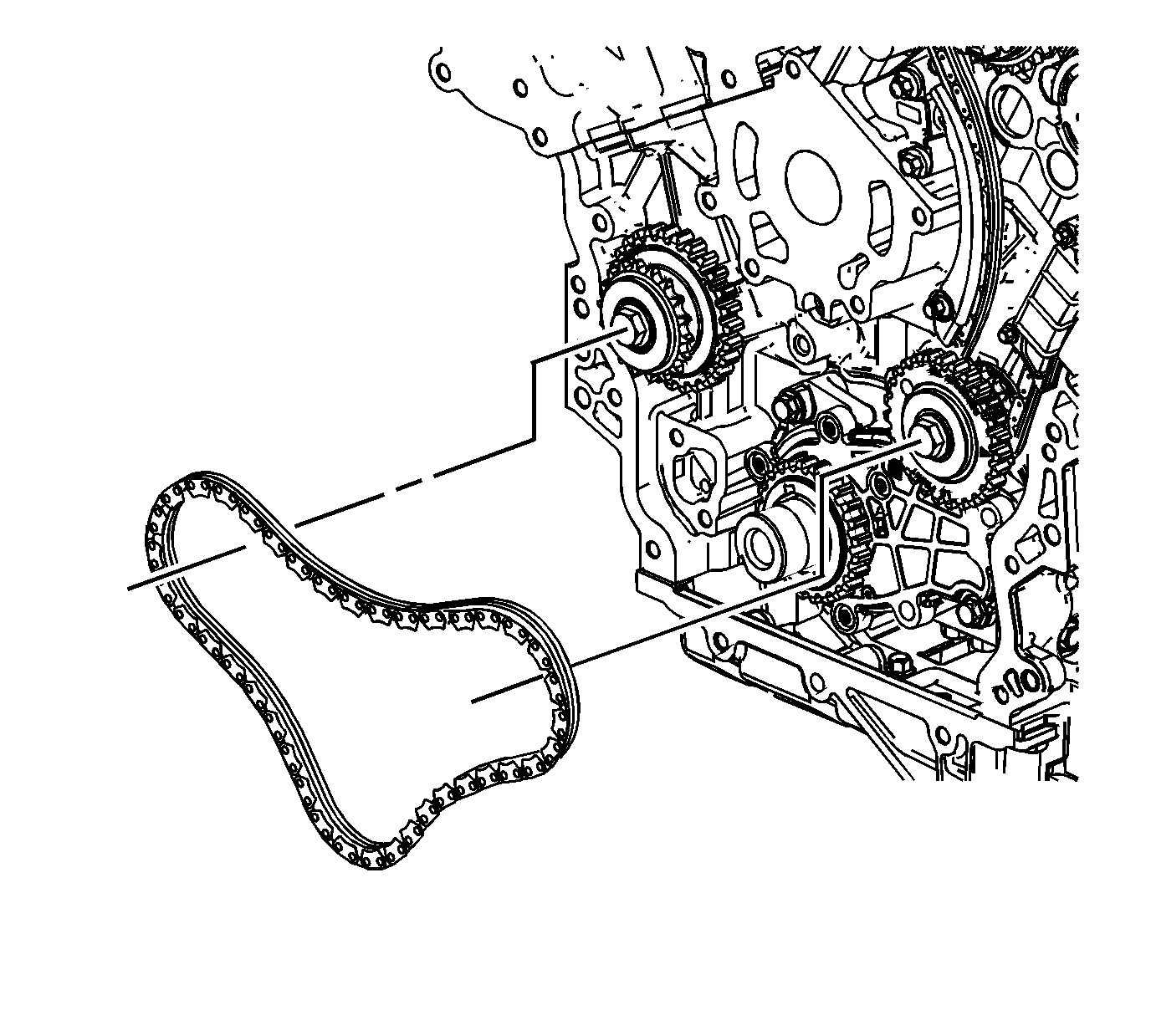

pic 5
5. Ensure the crankshaft is in the stage one timing position with the crankshaft sprocket timing mark (1) aligned to the stage one timing mark on the oil pump cover (2) using the EN 46111 - crankshaft rotation socket. Refer to Timing Chain Alignment Diagram See: Timing Component Alignment Marks > Components > Timing Chain Alignment Diagram - Stage One.

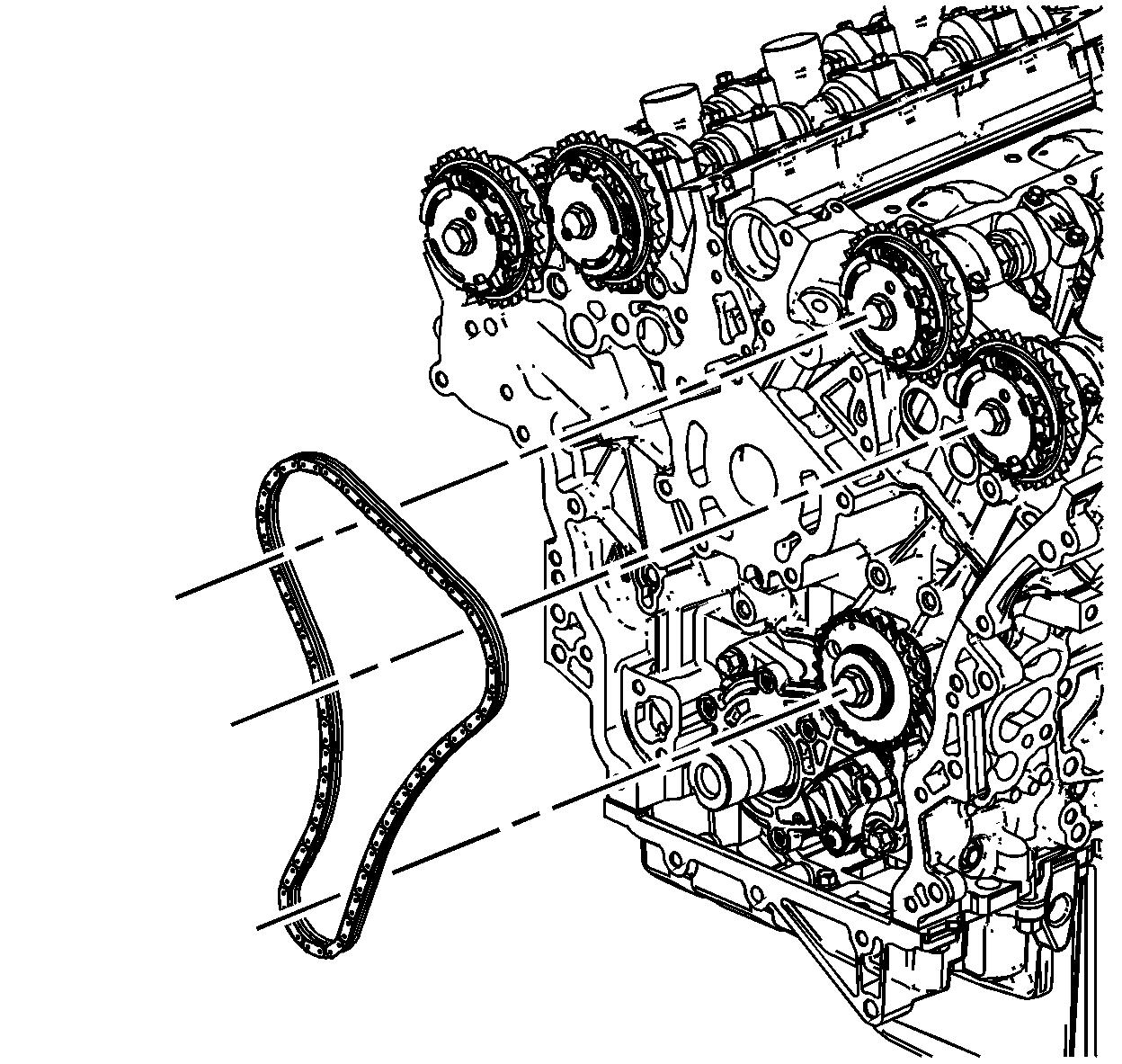

pic 6
6. Install the primary camshaft timing chain. Refer to Primary Camshaft Intermediate Drive Chain Installation See: Engine > Overhaul.
