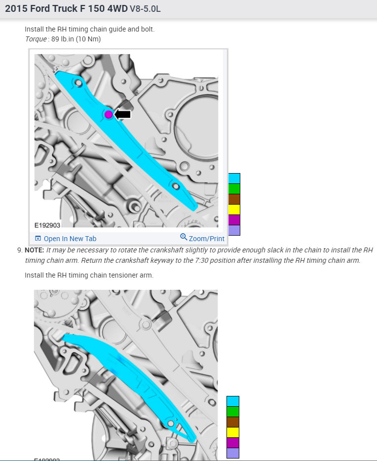

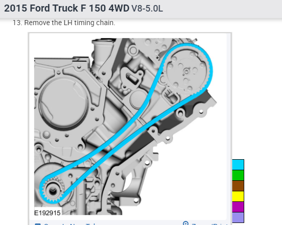

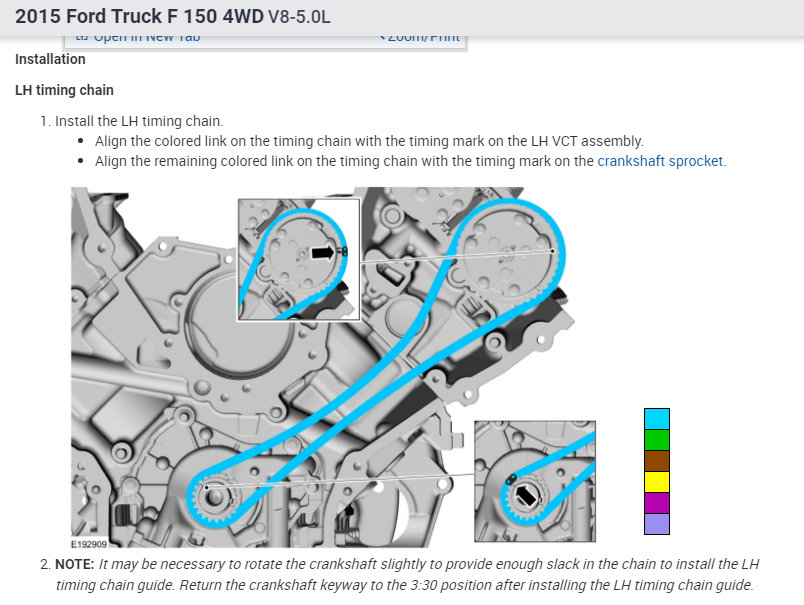

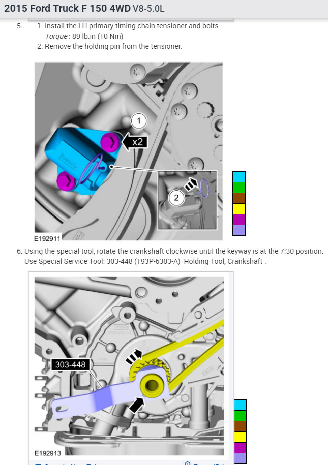

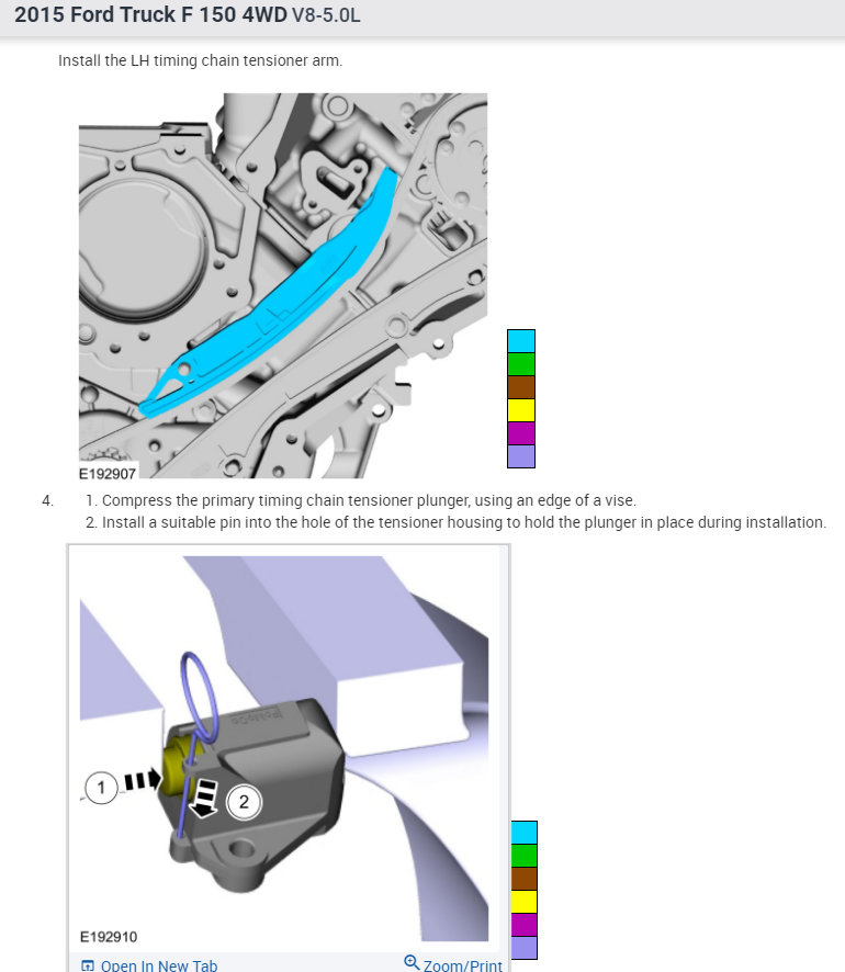

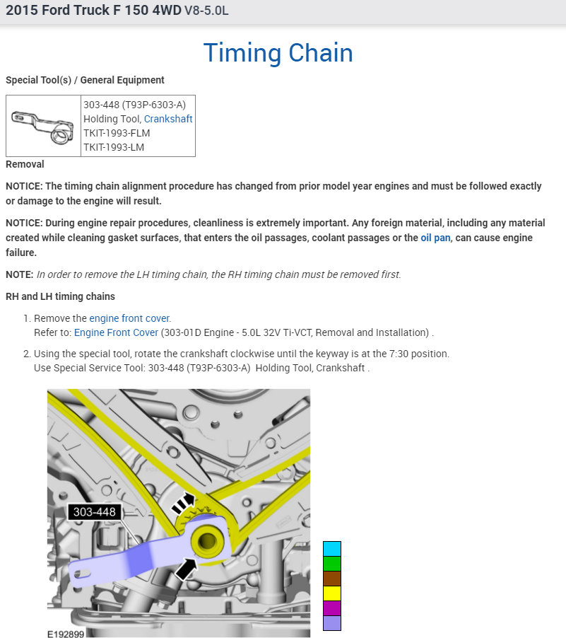

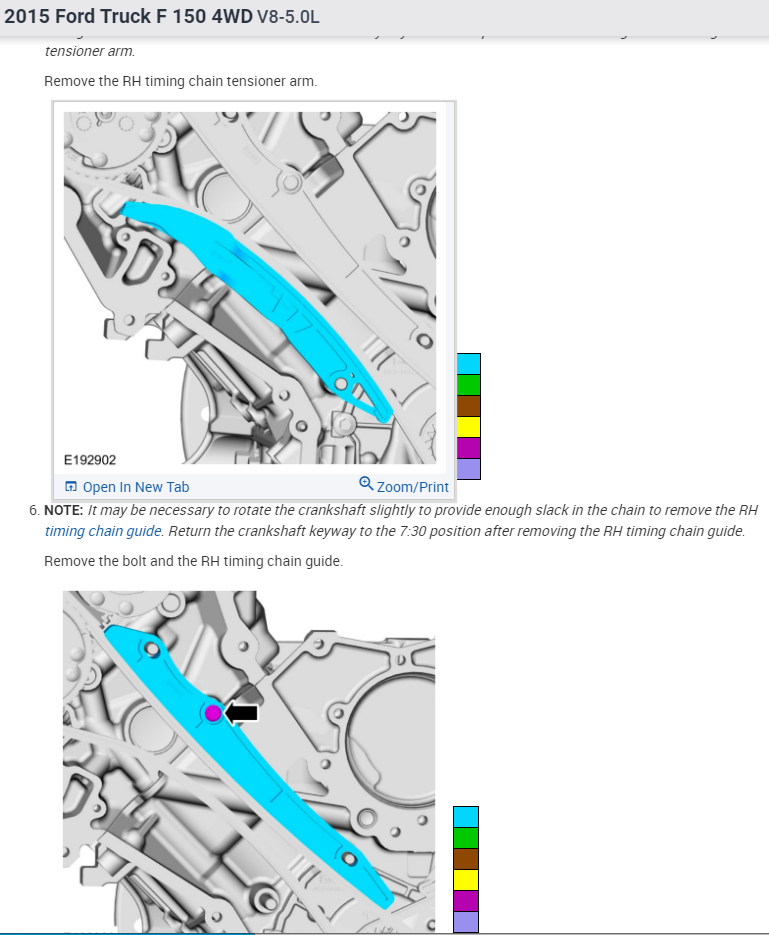

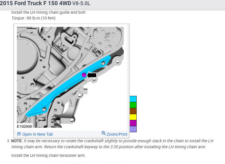

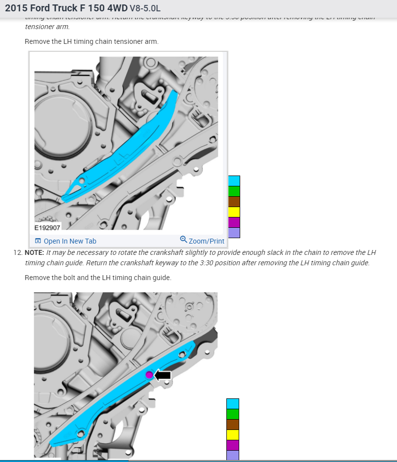

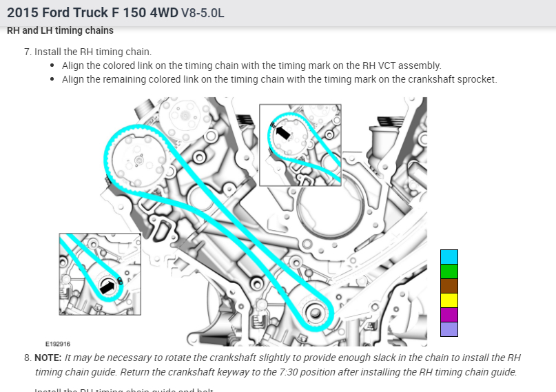

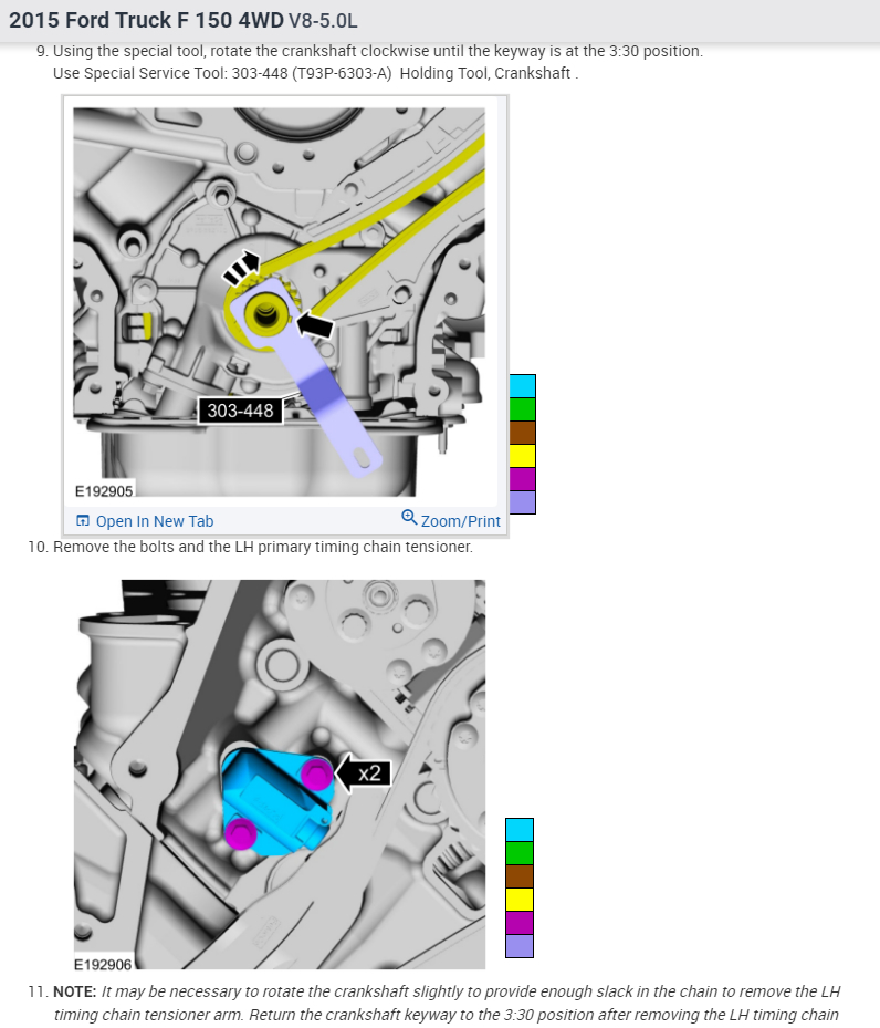

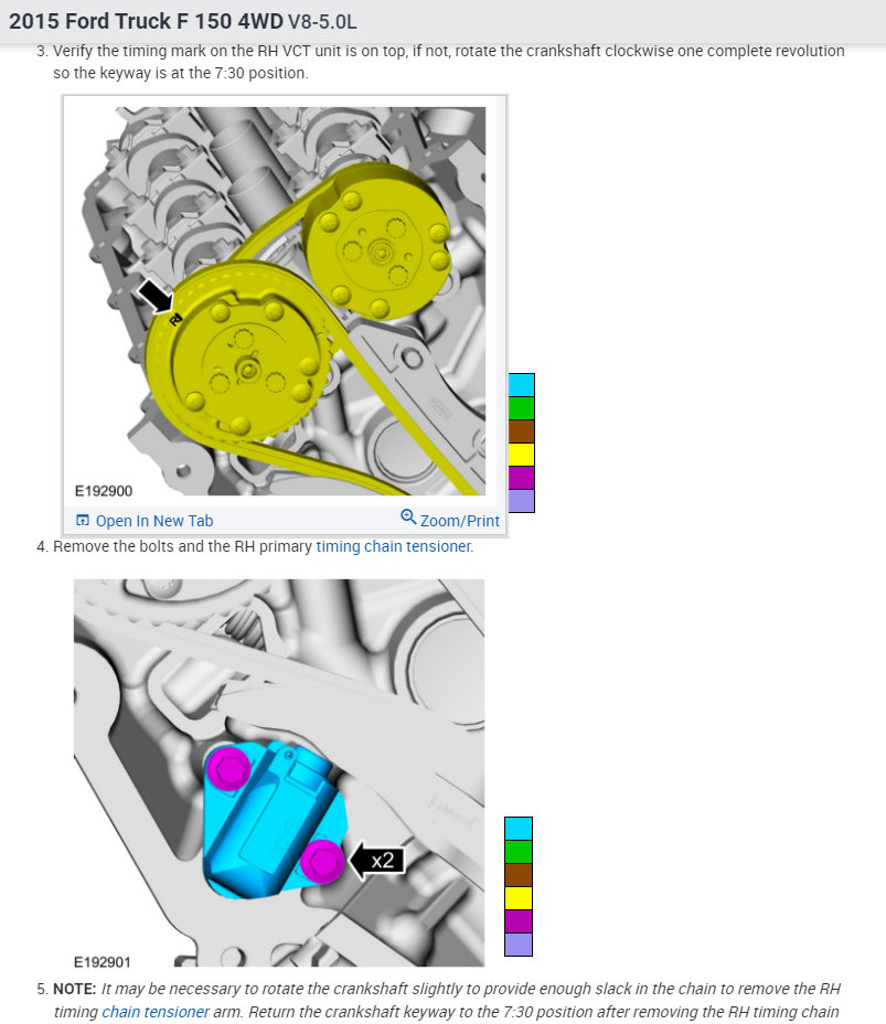

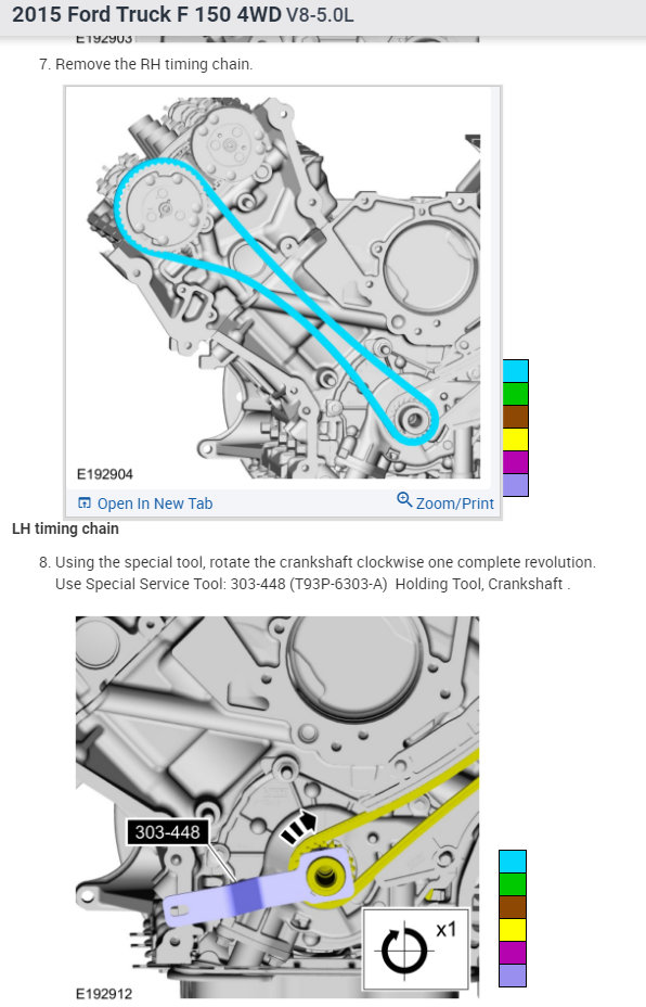

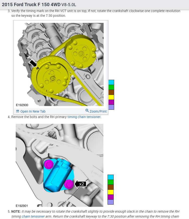

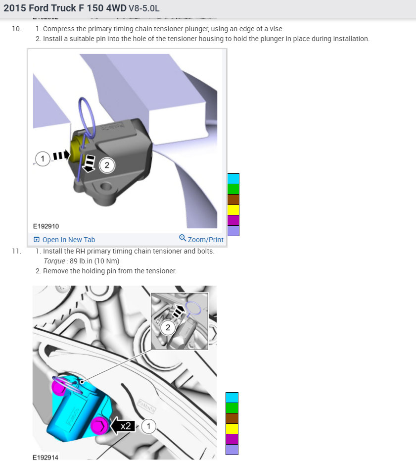

wanting to make sure phasers are orientated correctly on cams before orientating timing marks to finish primary chain timing.
Oct 14, 2021 at 8:52 AM
SQM
  • 6,383 POSTS
See attached the for the timing chain replacement guide. It has all the positioning and marks noted. Let me know of any questions. Check out the diagrams (Below). Please let us know if you need anything else to get the problem fixed.
