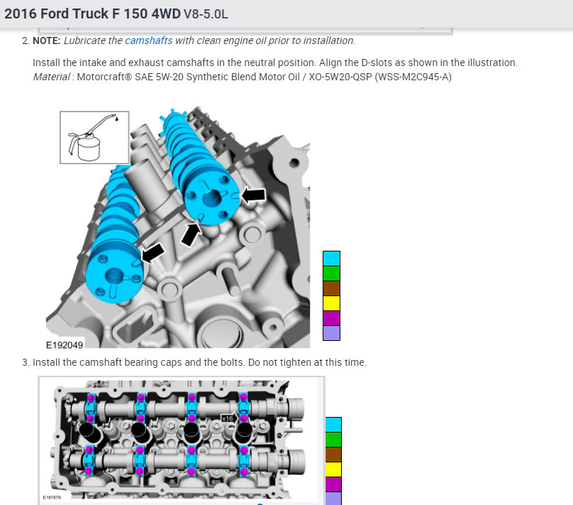

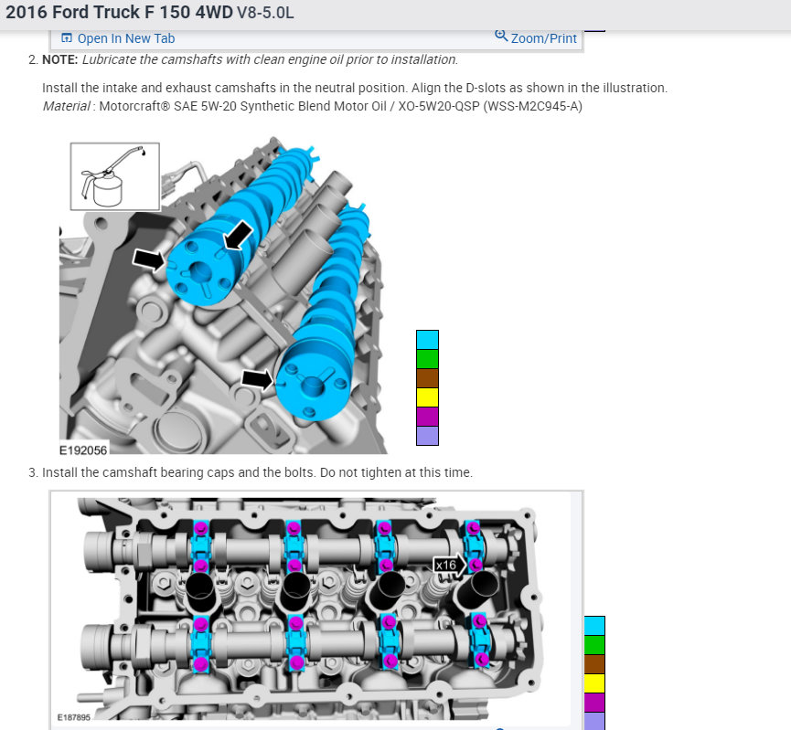

What orientation does each cam shaft need to be in when installing them into the head?

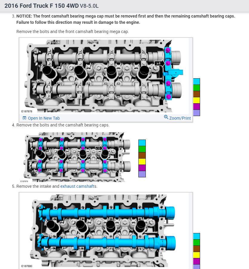

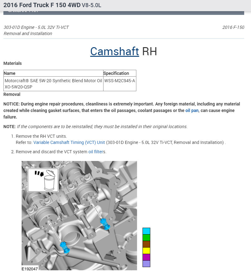

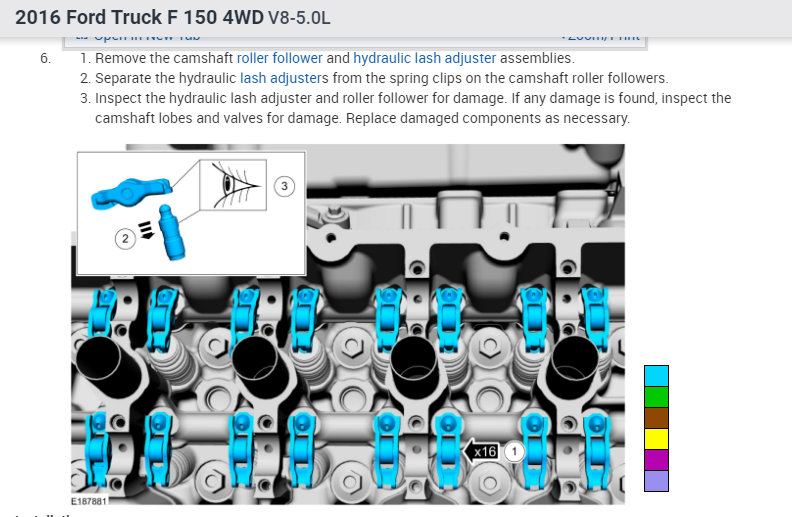

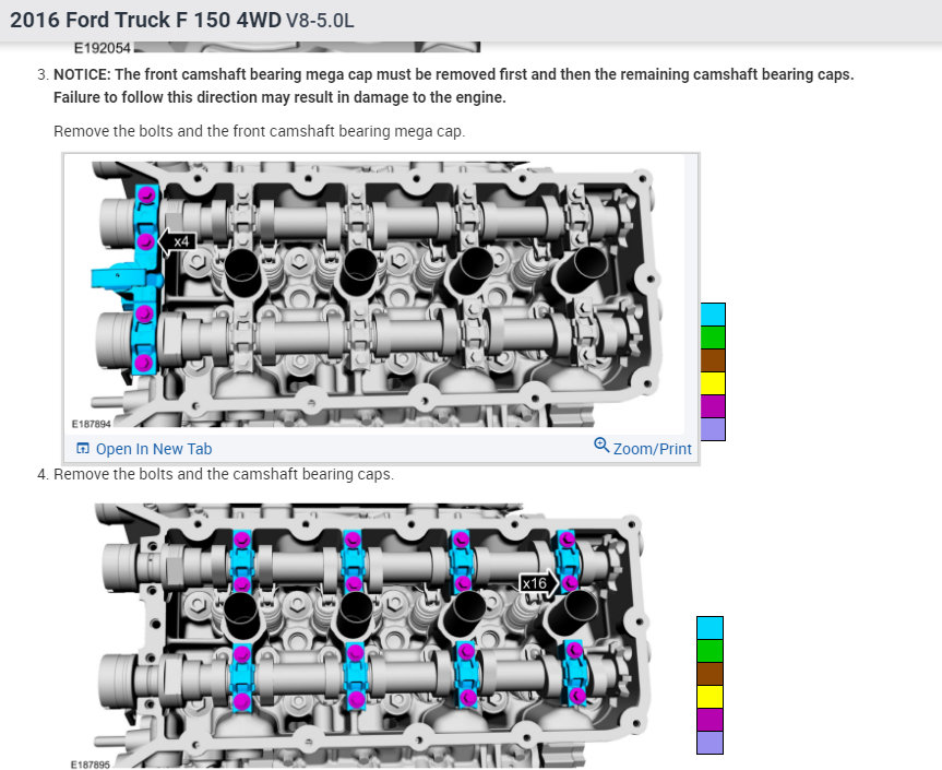

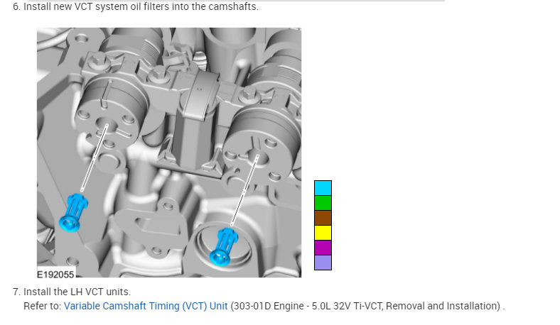

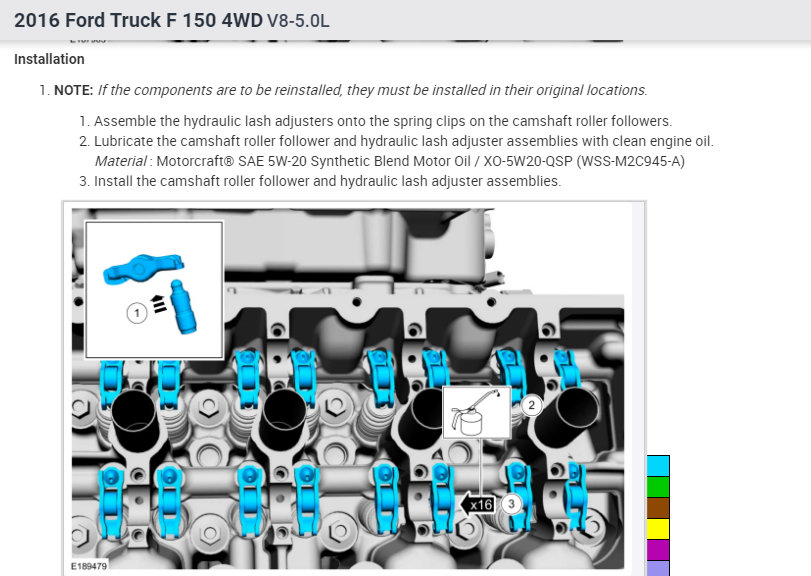

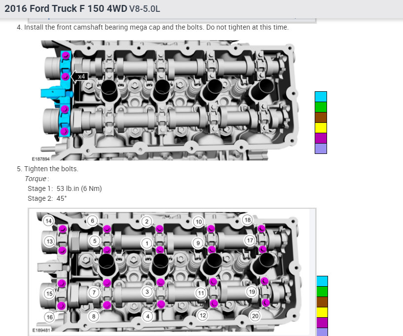

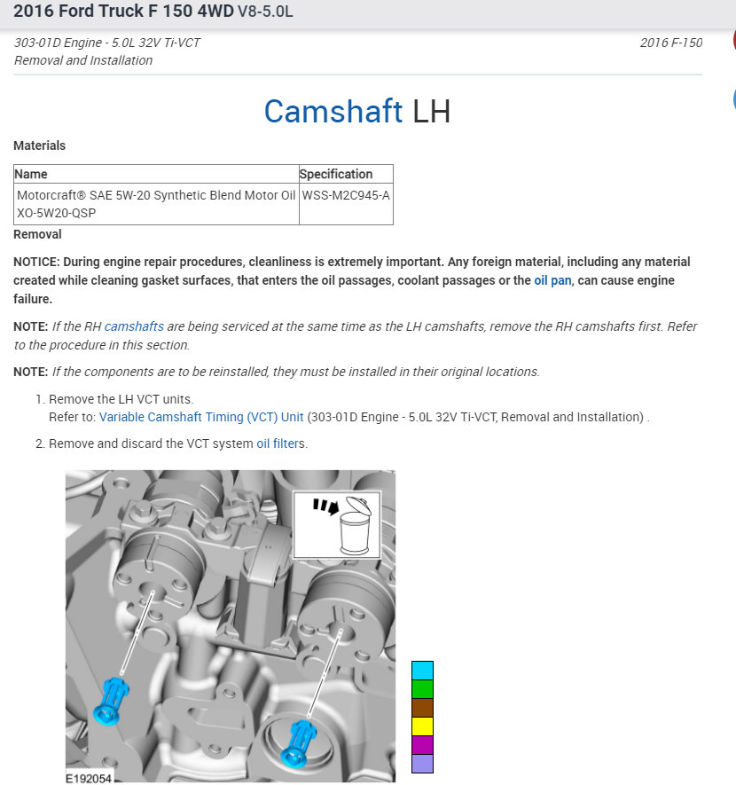

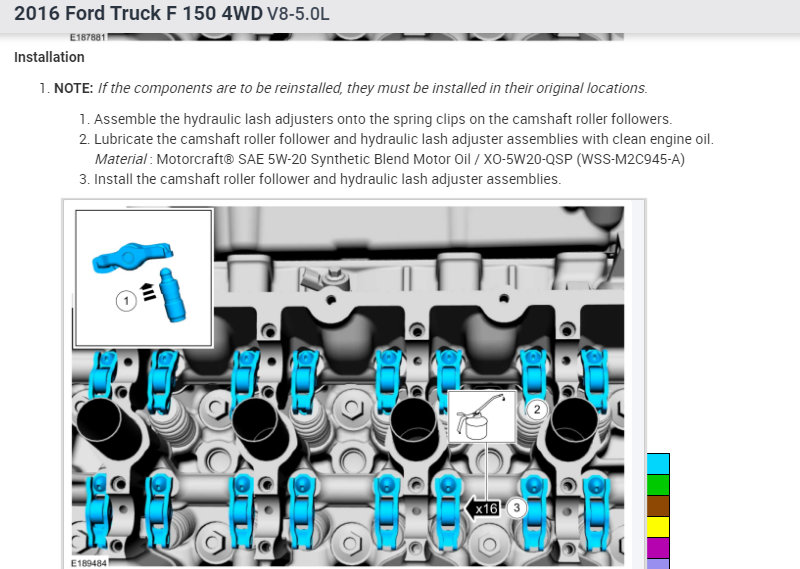

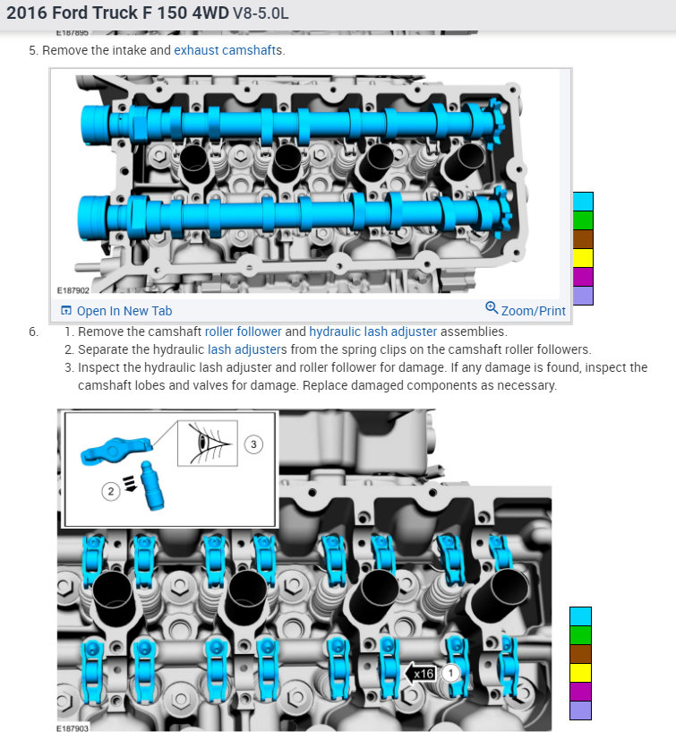

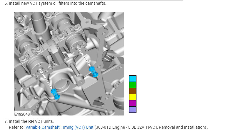

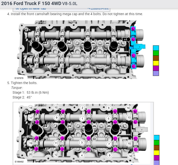

Look below for the camshaft replacement procedures.
It shows the position as well as the torque specifications.
Let me know of any questions.

This is perfect. Thank you!
