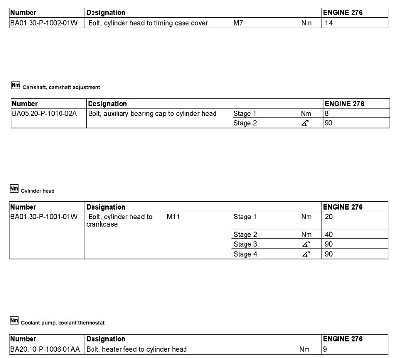

I have a buddy working on the vehicle listed above and needs to know what to set his torque wrench at to tighten the bolts back up. any help?

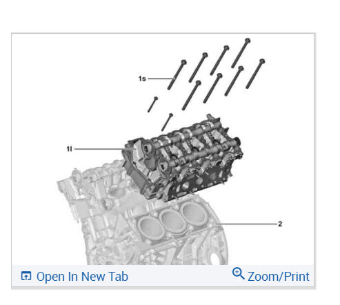

These look like torque to yield, so you will need a torque wrench capable of measuring degrees. This video will show you how:
https://youtu.be/JDN8MaekT2Y?si=fLqKNDdu_rRAci6r&t=896
Here are the torque specs for the cylinder head as requested. Check out the images (below). Please let us know if you need anything else to get the problem fixed.
