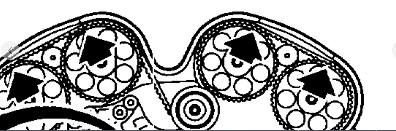

what is the right way to put the cam gear on to the cam?
Mar 21, 2018 at 9:29 PM
Good morning.
The gear will need to be installed with the mark on the gear for belt alignment on the outside so you can see it when you align the belt on installation. picture attached.
