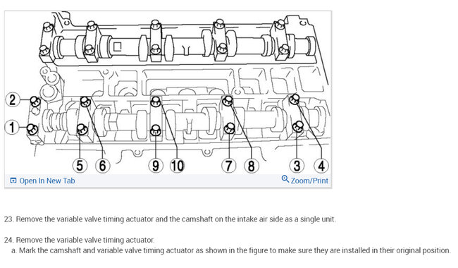

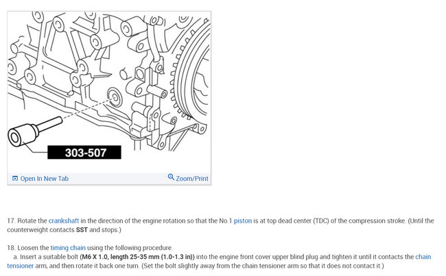

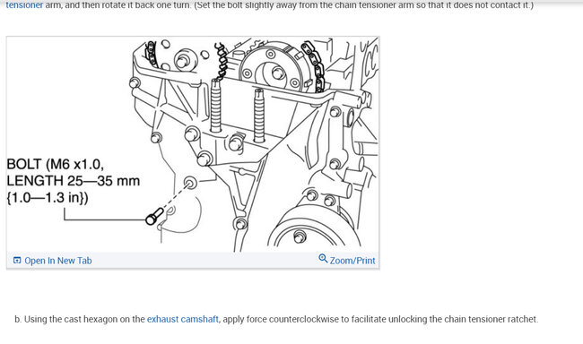

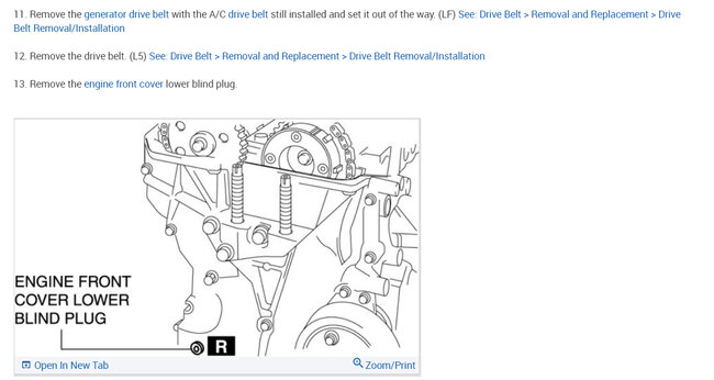

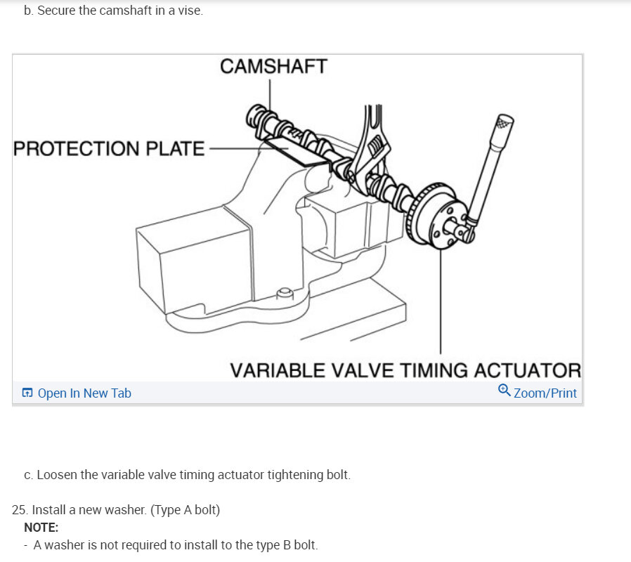

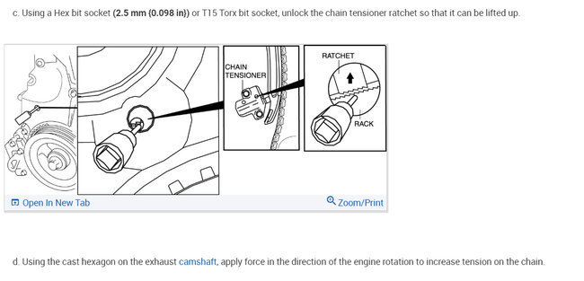

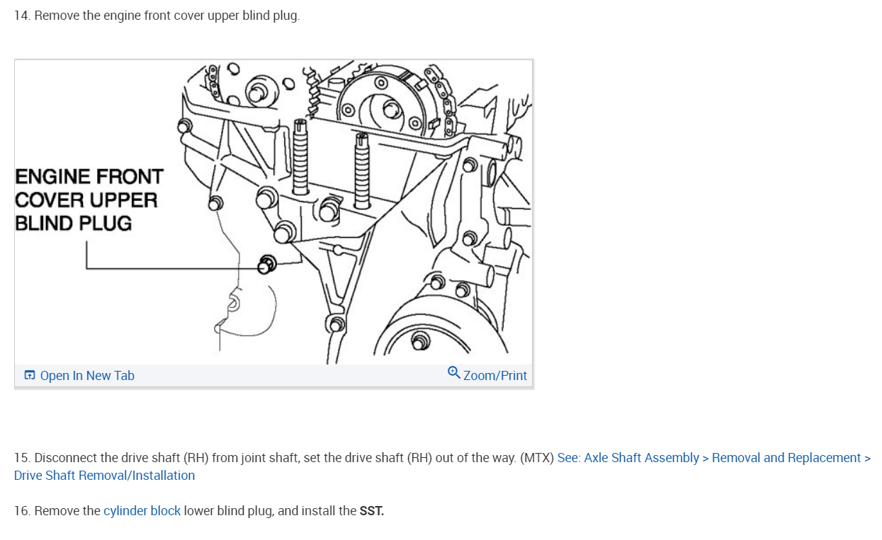

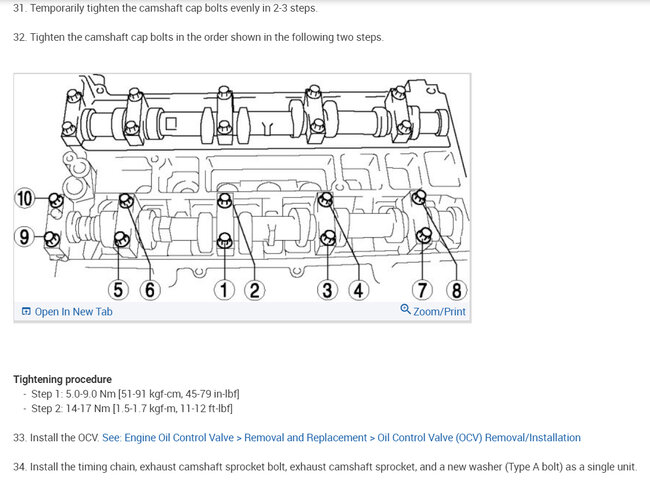

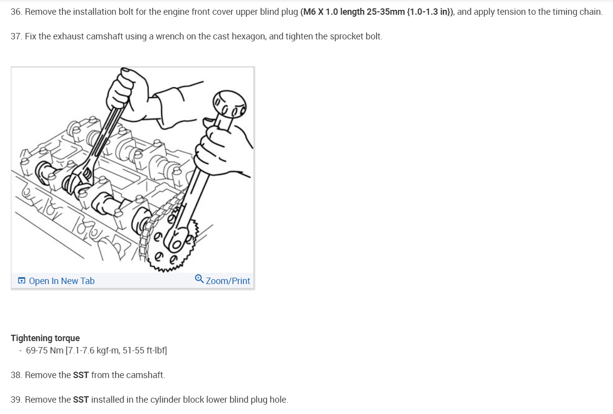

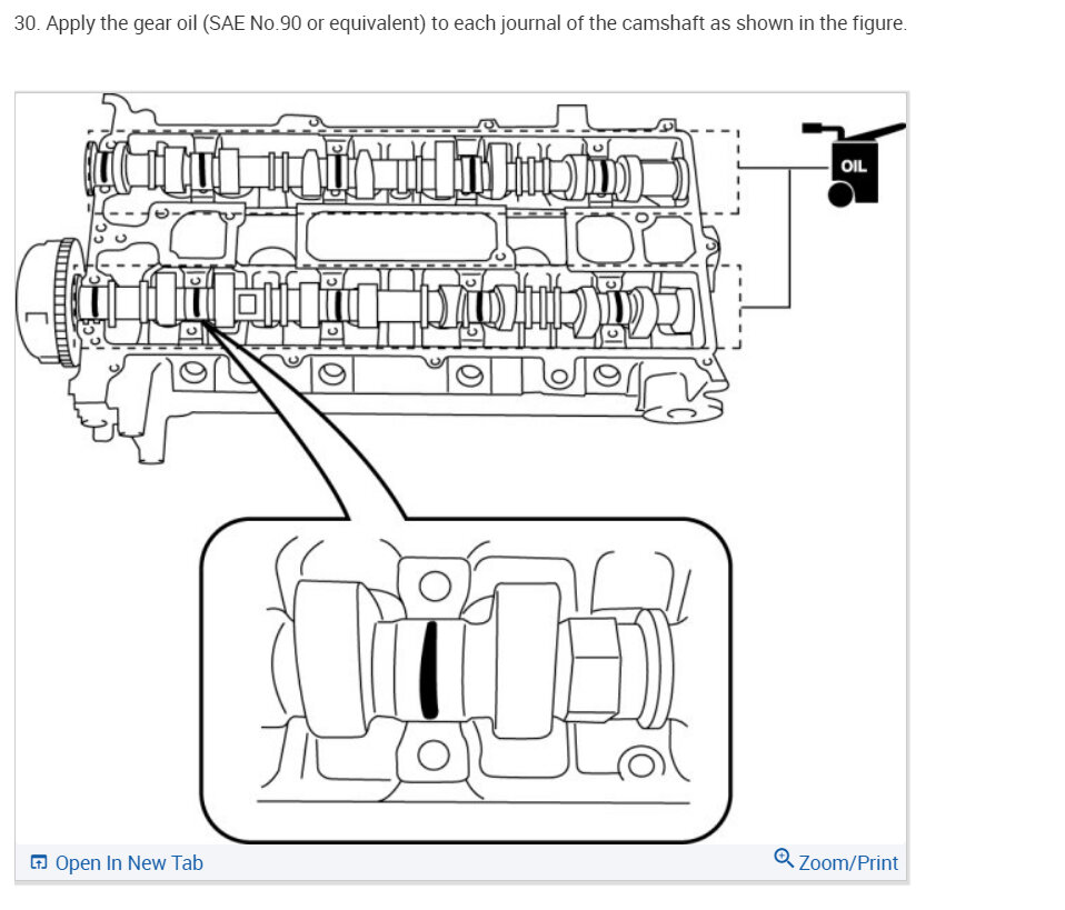

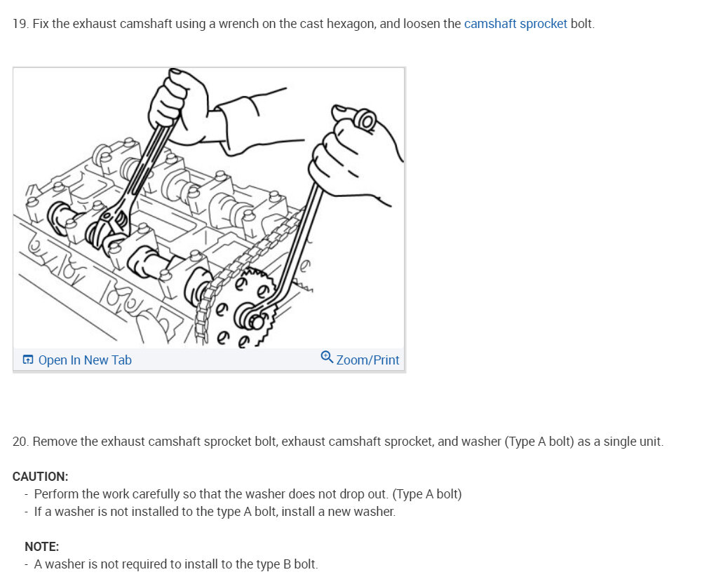

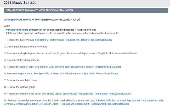

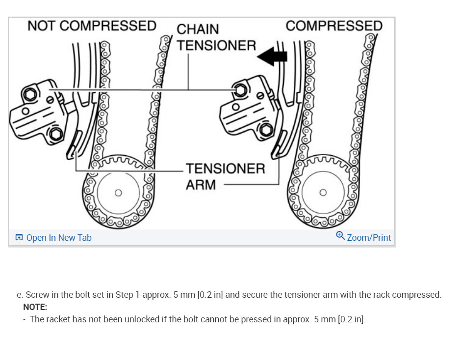

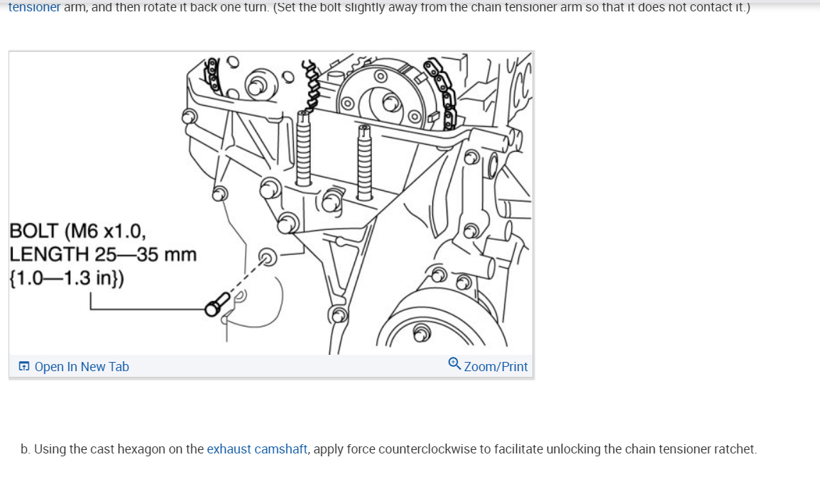

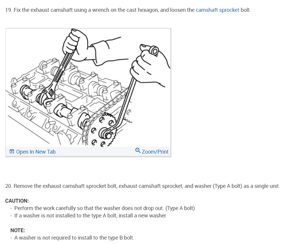

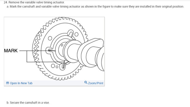

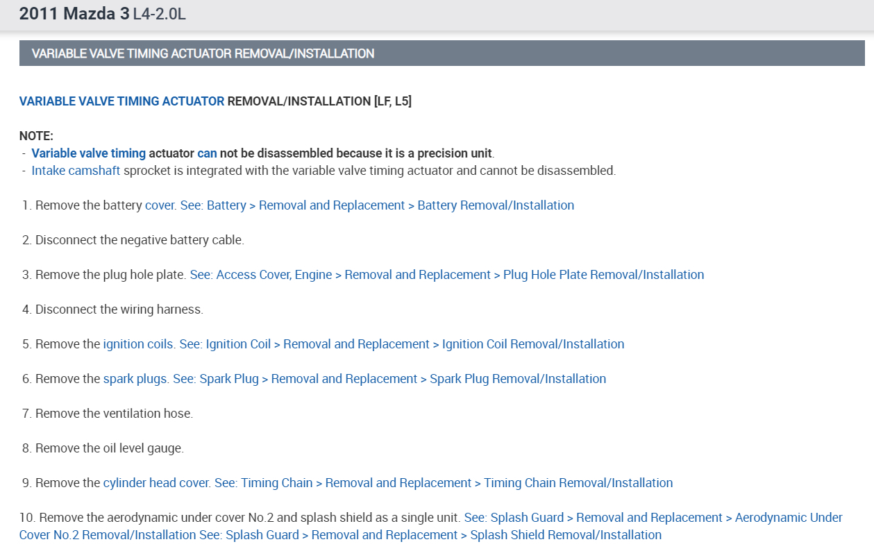

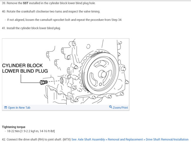

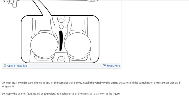

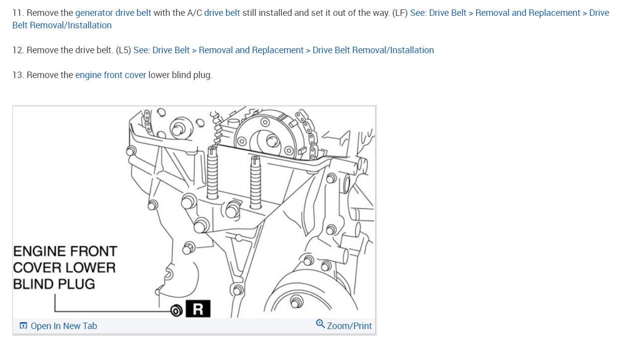

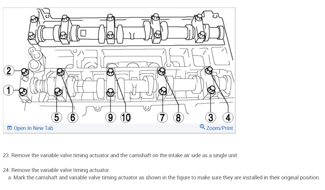

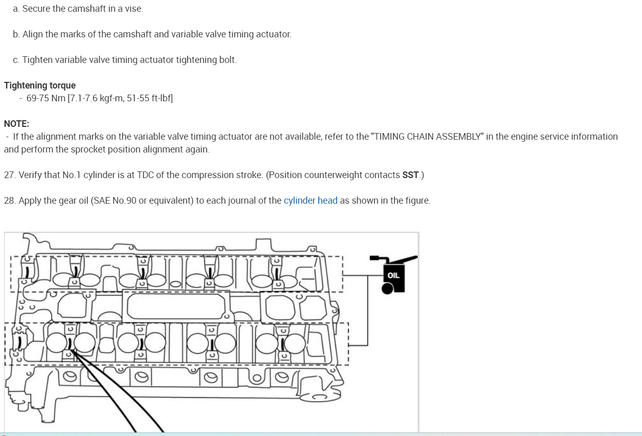

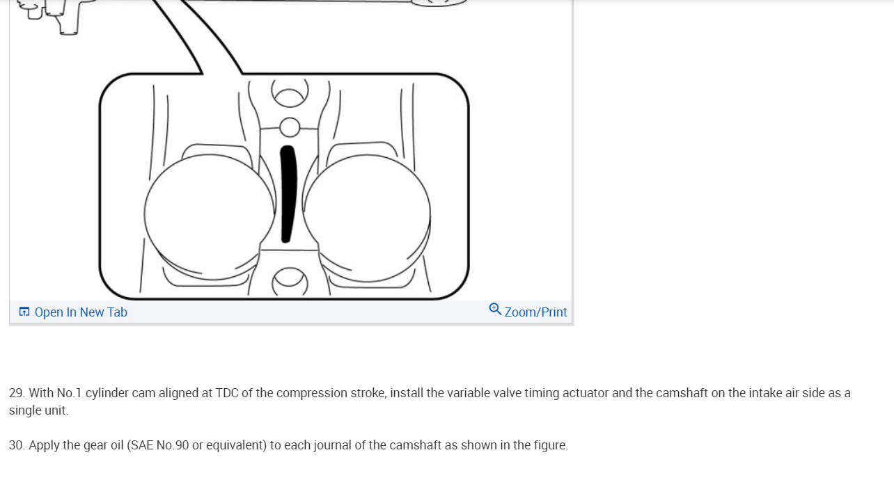

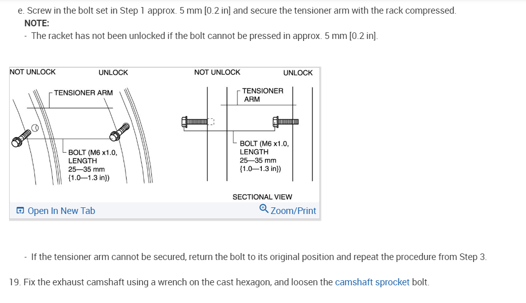

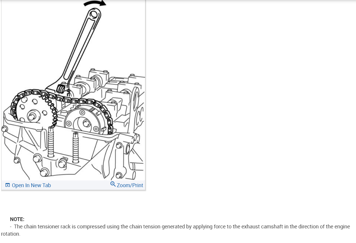

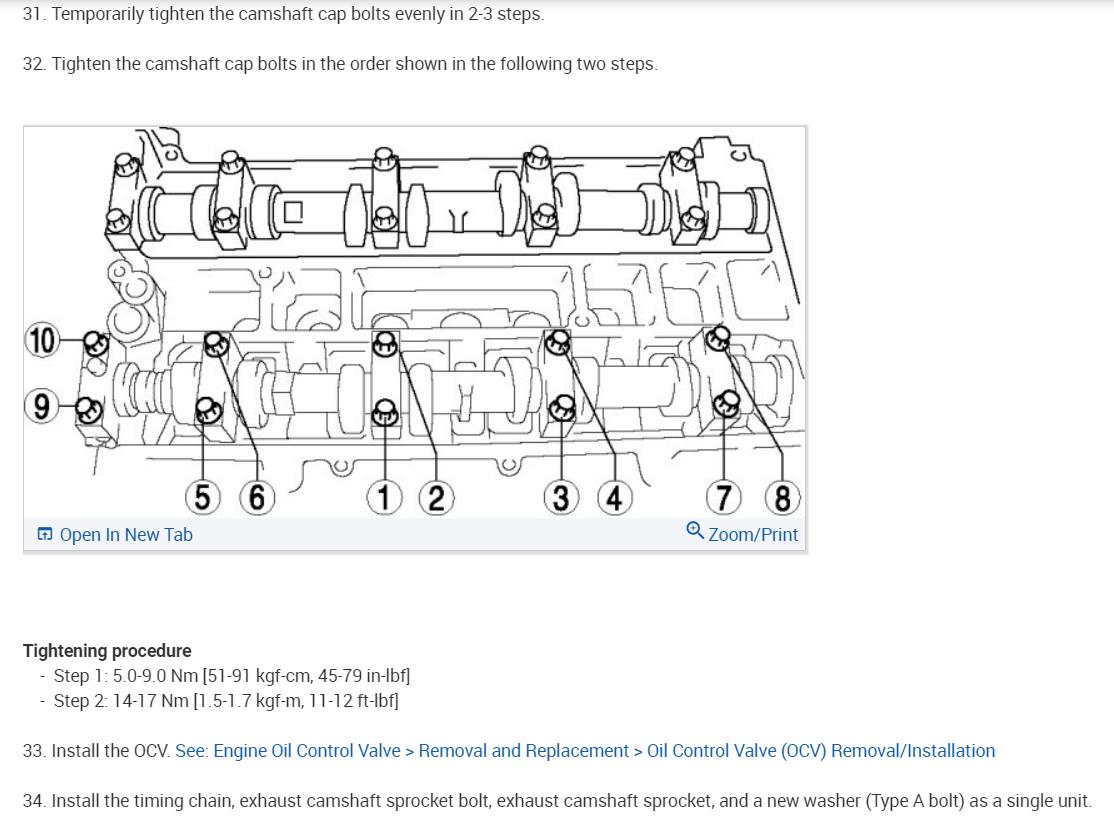

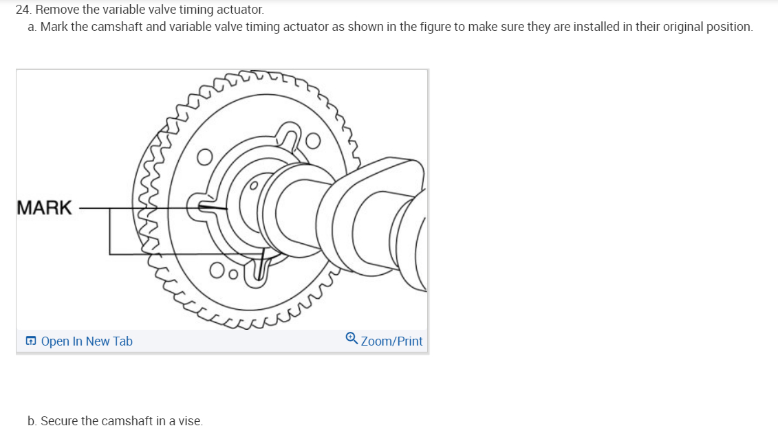

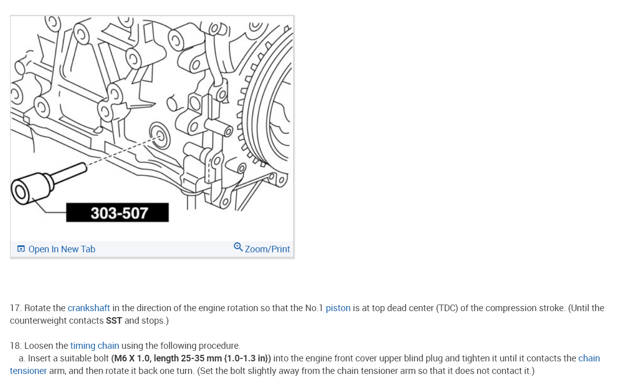

Me and my buddy are replacing the VVT gear, and the cam moved at one point when trying to pull the gear off. Does anyone know how to realign the cams and crank with the VVT gear?
Aug 17, 2023 at 6:11 PM
  • 54,837 POSTS

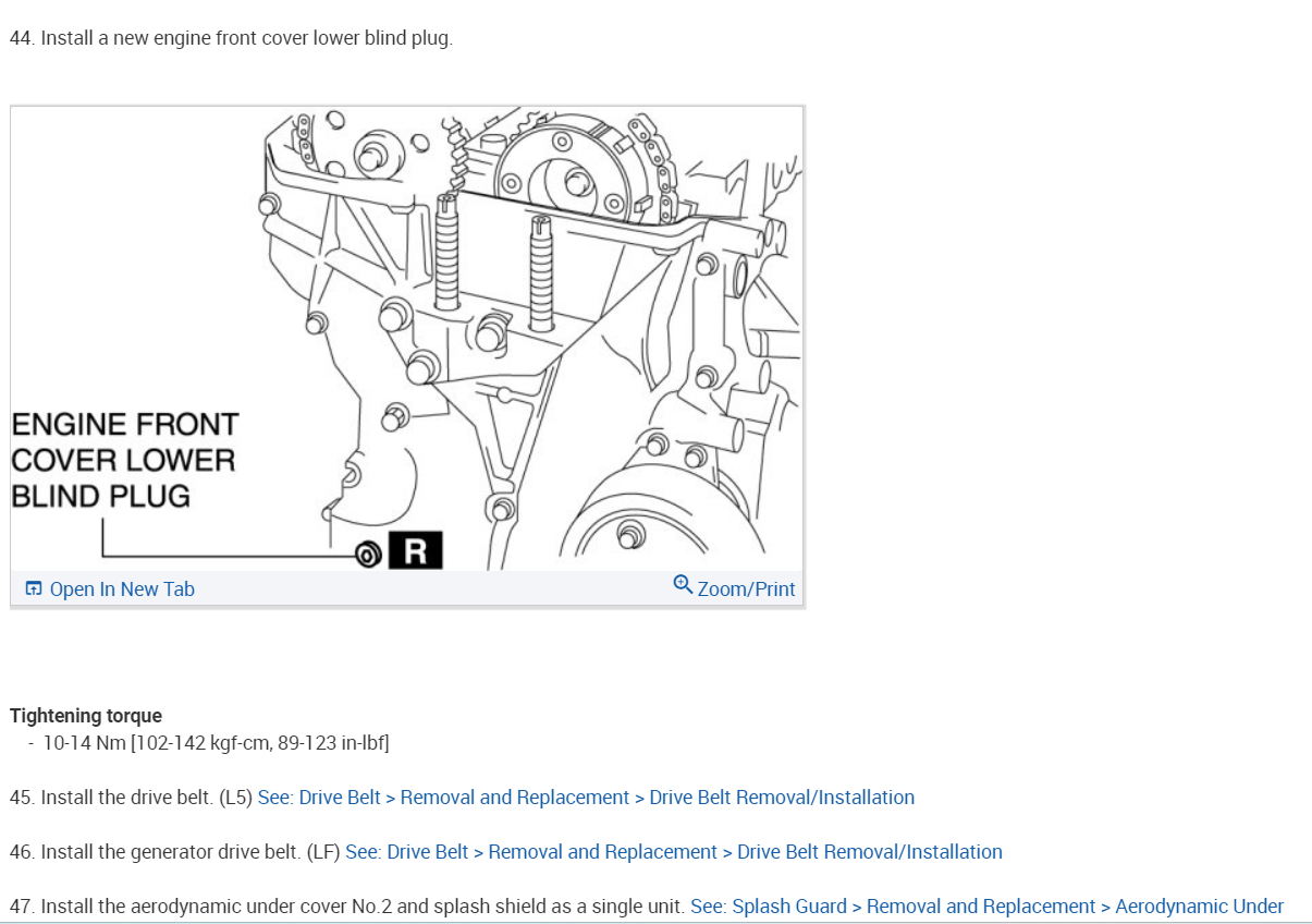

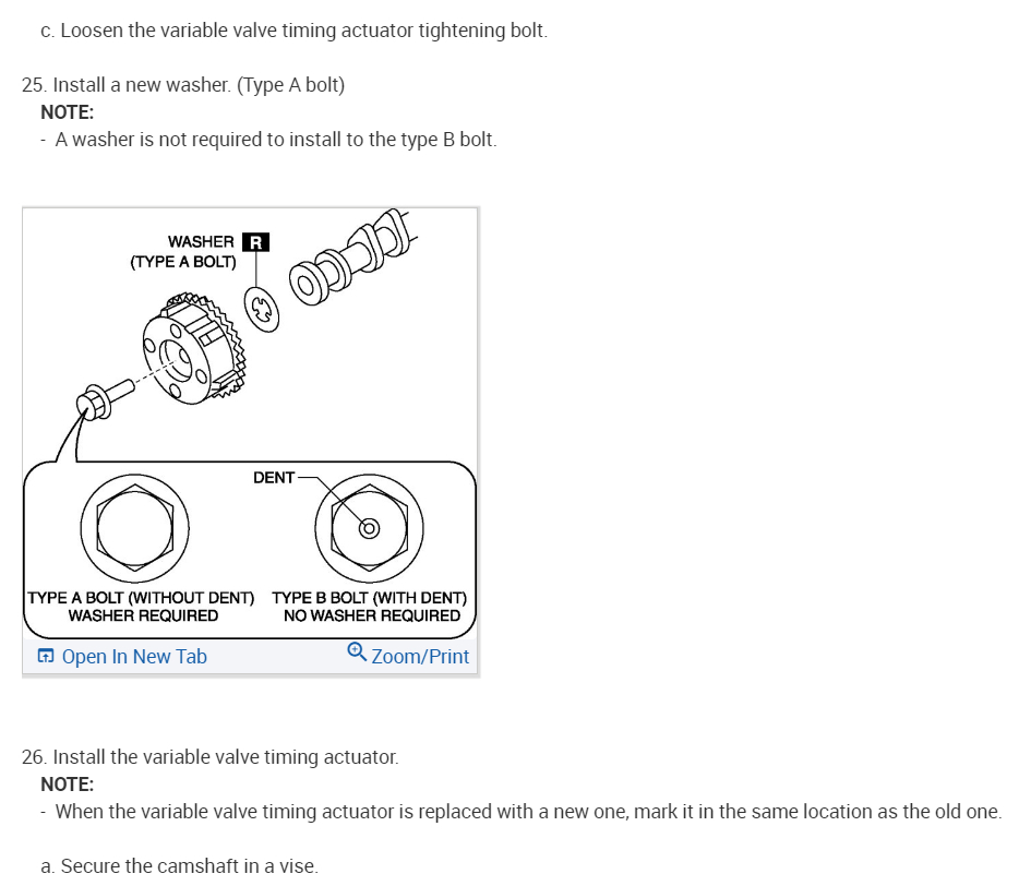

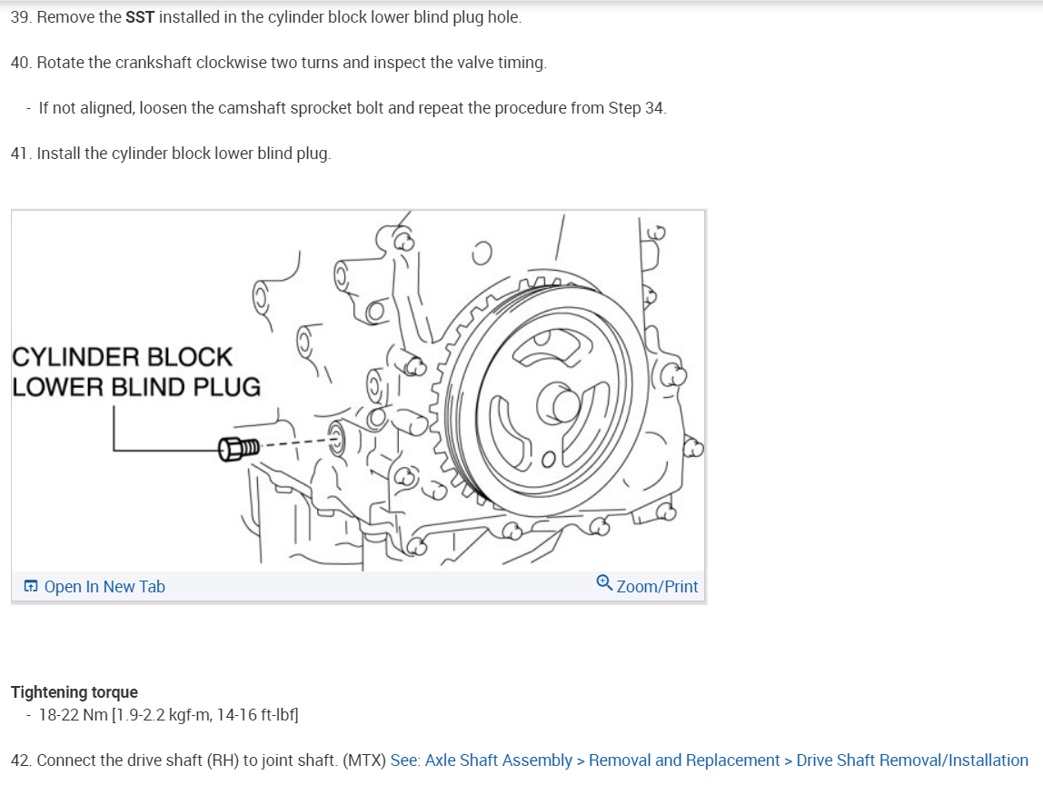

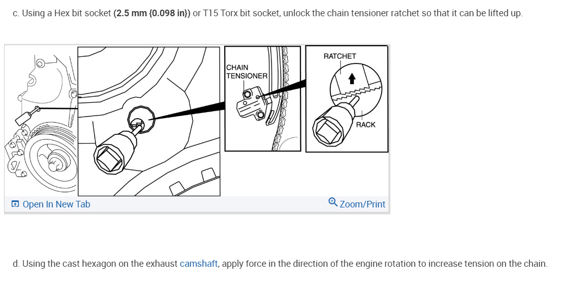

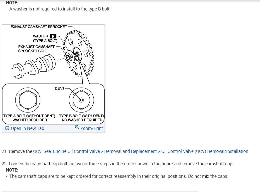

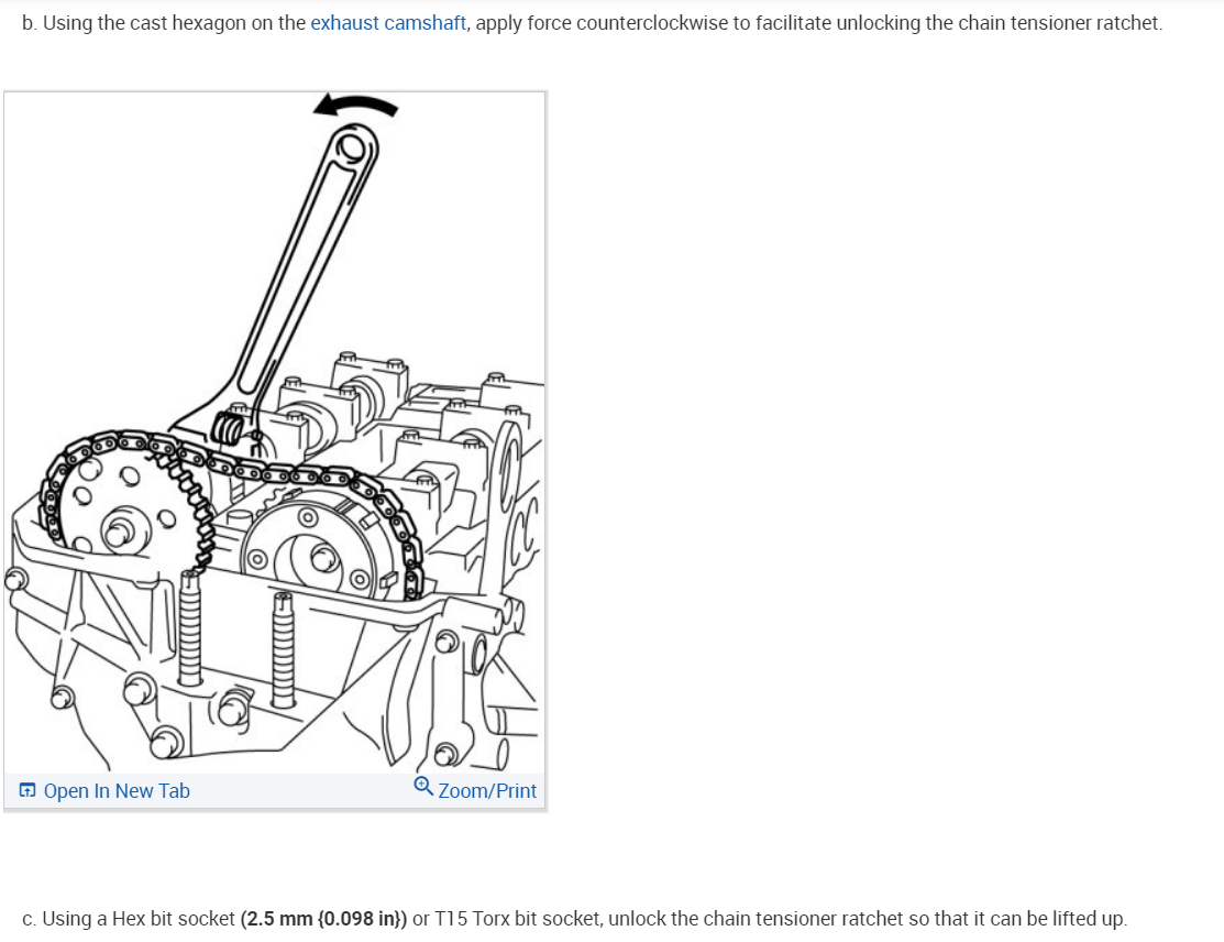

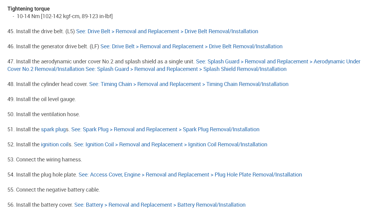

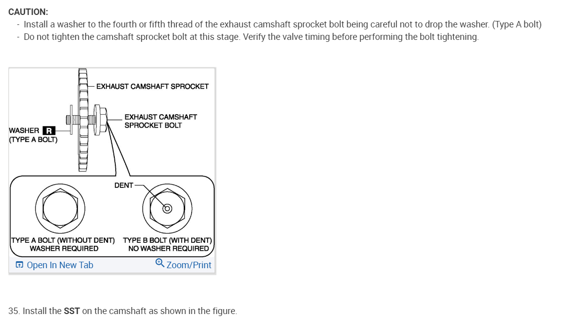

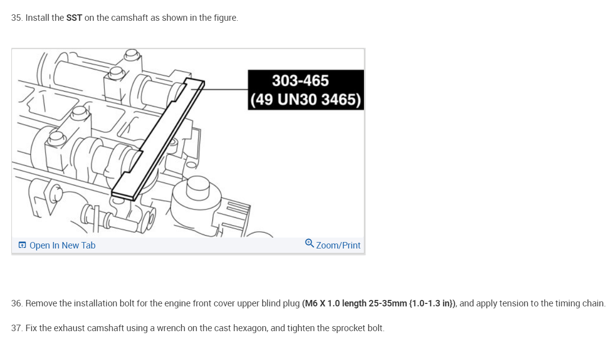

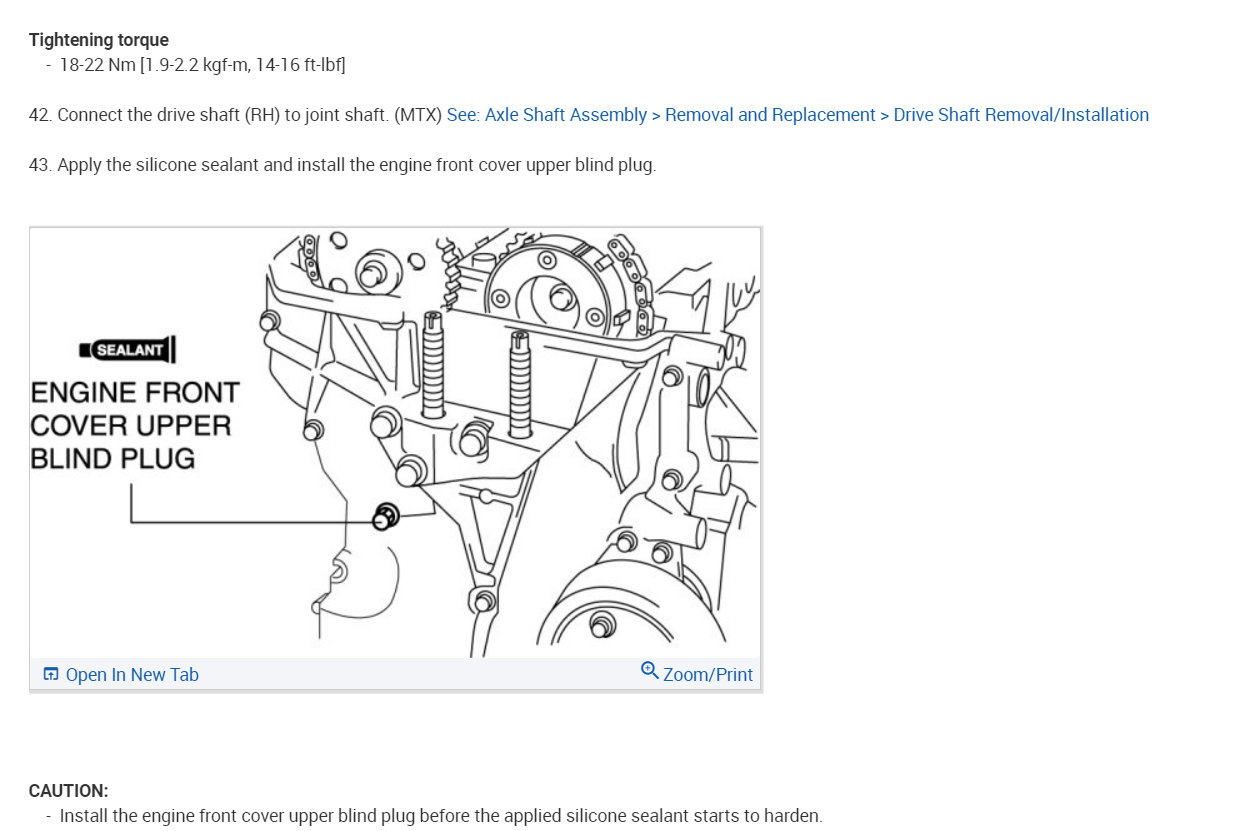

Yep, it is a procedure. here are the instructions on how to replace and retime the VVT actuator. Check out the images (below). Please let us know if you need anything else to get the problem fixed.
