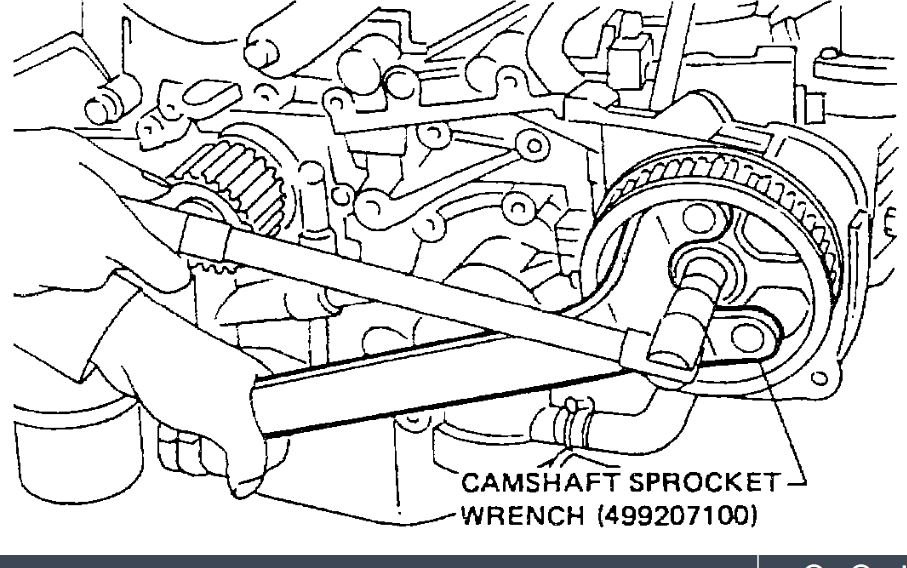

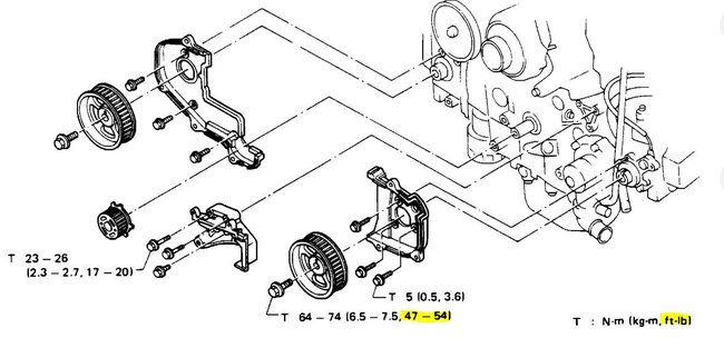

Looking for the procedure to hold and torque the cam gear bolt. and the bolt torque spec.

There is a special tool to hold the gear while torquing the bolt. It's simply called a camshaft sprocket wrench. I attached two pics below. The first shows the wrench I am referring to and the second indicates torque specs. I highlighted the foot pounds.
