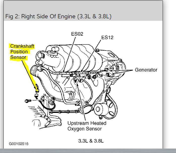

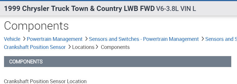

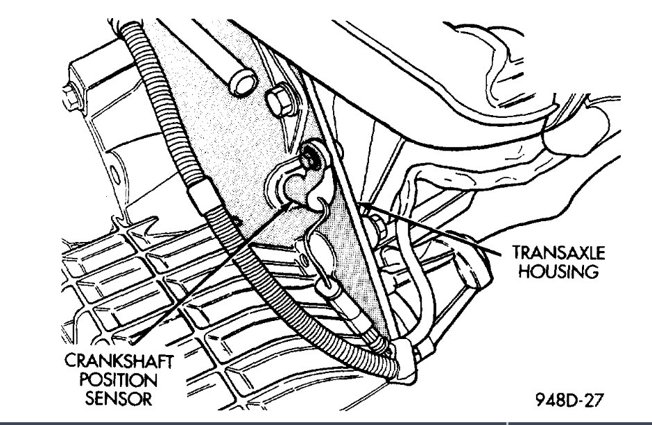

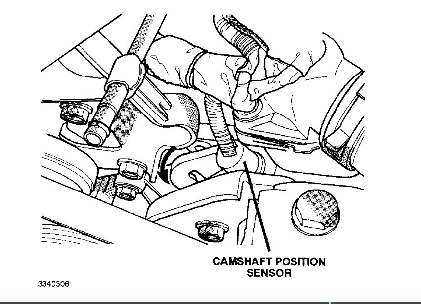

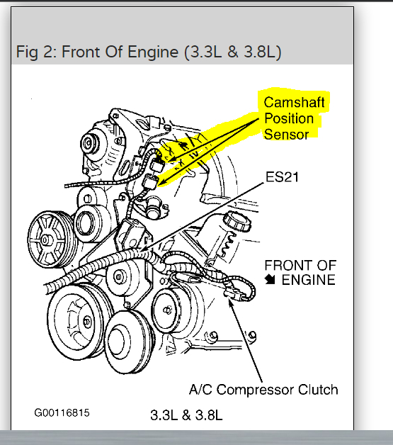

i would like to know were is the cam and crank sensor located at on my van.
May 30, 2019 at 11:25 AM
SCGRANTURISMO
  • 4,897 POSTS
I have included the information that you have requested in the diagrams down below. Please let us know if we can help you with any other automotive related questions. It's why we're here.

Thank you so much. I have located it and now I'm trying to see how can I get it out.
May 31, 2019 at 3:37 AM
DAMON G
  • 6 POSTS
This crankshaft sensor is hard to get out. any suggestions on how to go about getting it out?
May 31, 2019 at 7:13 AM
  • 55,423 POSTS
No it's not too bad. Can you please shoot a quick video with your phone so we can see what's going on? that would be great. You can upload it here with your response.
