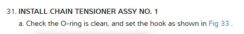

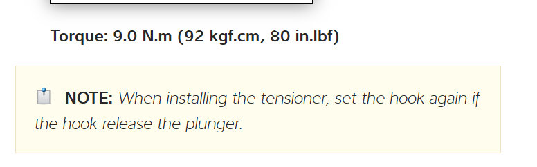

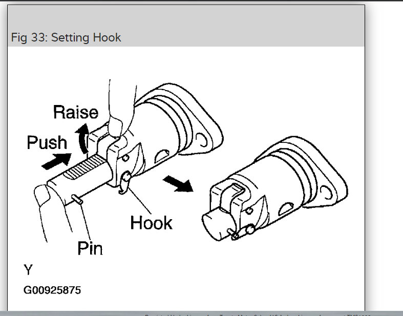

I'm not sure if this is the same information you have or not but I have included what I've got on installing the timing chain tensioners in the diagrams down below. Please go through this guide and get back to us with what you find out.
Thanks,
Alex

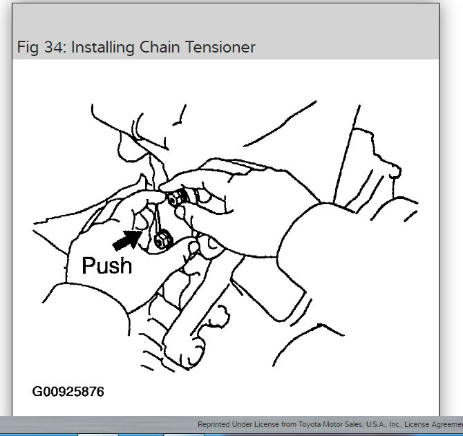

Hi Alex, thanks for the reply. Yes, that is exactly what I have. No matter how many times I reset the tensioner it always releases before I get it seated even half way into position. From videos I've watched it should slide in about 90% of the way pretty easy and the last 10% needs a good firm push to seat the o-ring and tensioner the final bit.

Okay, I have never done this on a PT Cruiser before, before, but there has to be some way to give yourself some slack in the chain without moving your timing marks. Maybe you could stick a paperclip or something small in the lock to hold it in place and keep from coming open prematurely. It would have to easily removed once the tensioner was in place, though. Please keep us informed, we want to hear how you finally get it.

I've fought with those tensioners a few times when they want to release. If you look the hook on them isn't very large so it falls with very little movement. I take a pair of nippers and bend the tip of the hook just a bit to make it lock a little better. Just a tip if you need to do one again.
