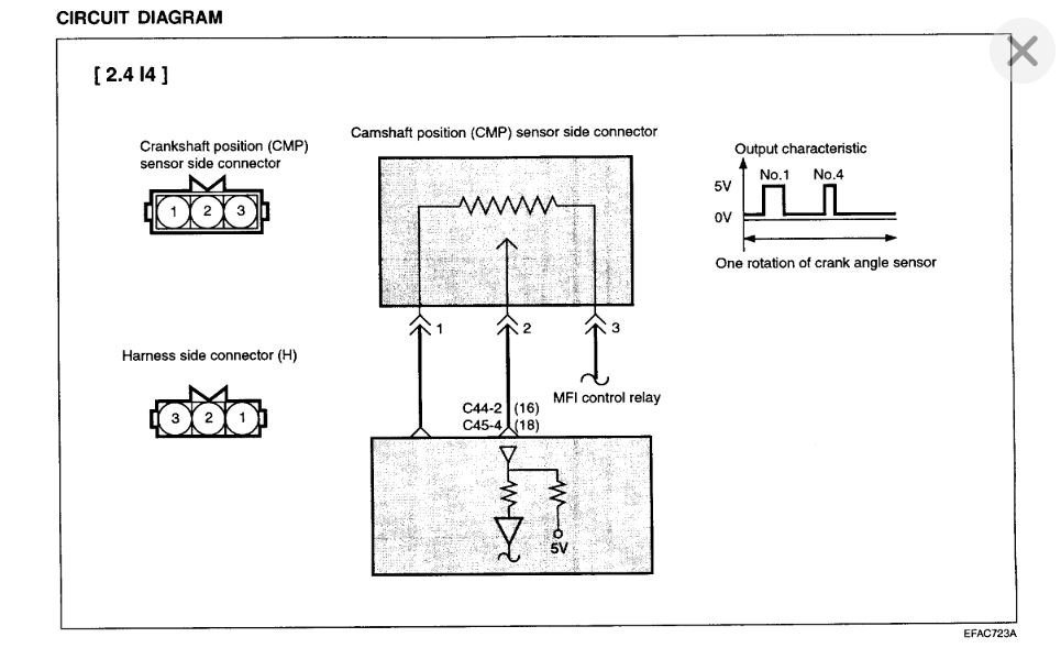

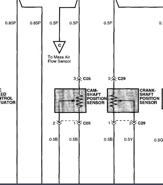

I installed the connector. Not positive which wires connect to which pin. but I put (one black and white, two pink, and three black). I was wondering if I can ruin the sensor while installing the plug. At one point I blew a fuse. But now the car starts then immediately shuts off. Does that make since? Thank you.
May 4, 2018 at 4:10 AM
Good afternoon.
Did you replace the fuse and is it holding?
Which fuse was it?
What happened to the connector?
I attached a diagram and connector diagram for you to view.
Let me know if you have any other questions.
