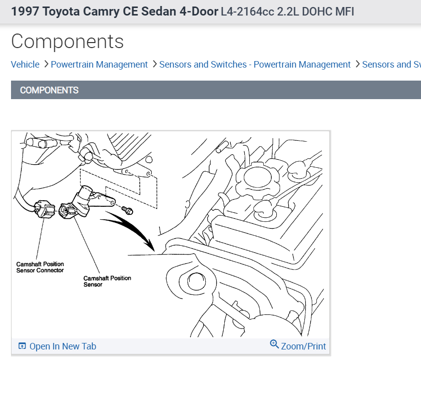

Need the exact location of the camshaft and crankshaft position sensor?
1997 TOYOTA CAMRY
100,000 MILES • 2.2L • 4 CYL • 2WD • AUTOMATIC

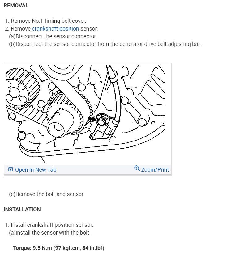

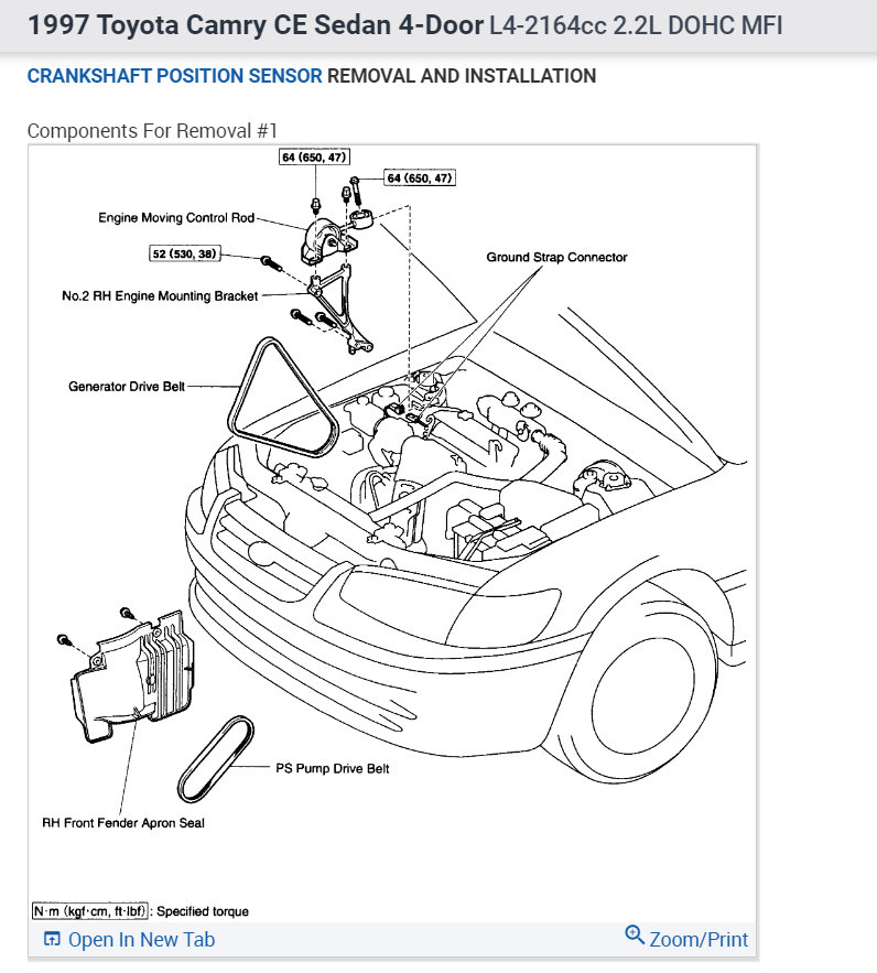

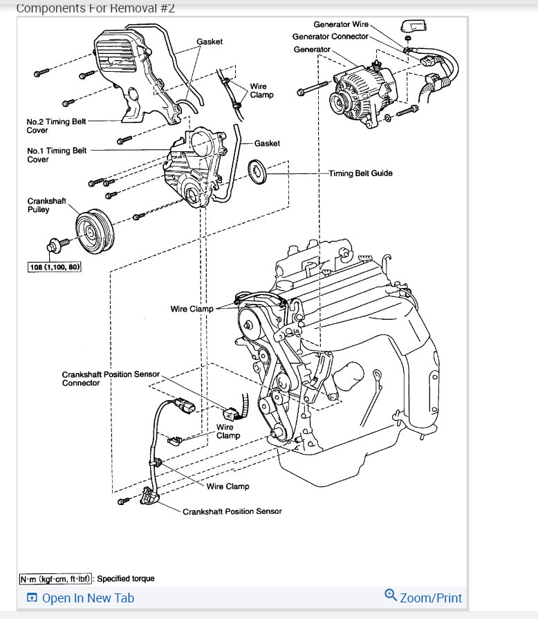

Both the camshaft sensor and the crankshaft sensor are on the front of the engine. The crankshaft sensor requires the removal of the timing belt and cover. Check out the images (below). Please let us know if you need anything else to get the problem fixed.
