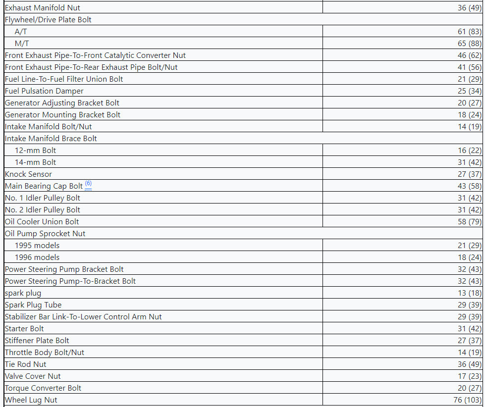

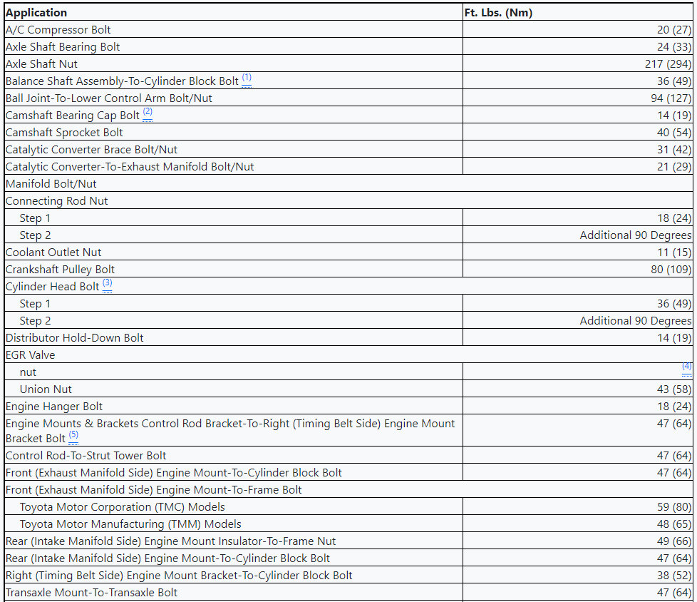

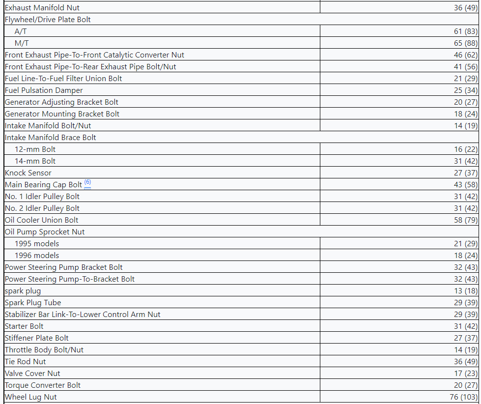

For tightening torque specifications please see images 6+7 below

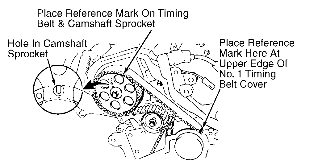

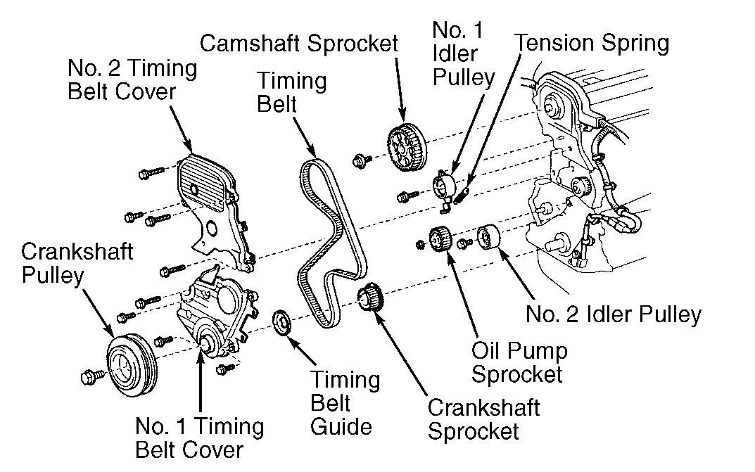

Remove engine mount and bracket from front of engine. Remove No. 2 timing belt covers and gaskets. see image 1 below.
Rotate crankshaft clockwise (viewed from timing belt end of engine) so cylinder No. 1 is at TDC on compression stroke and timing mark on crankshaft pulley aligns with "0" mark on timing belt cover. Cylinder No. 1 is the front cylinder at the timing belt end of engine.
Ensure the hole in the camshaft sprocket aligns with alignment mark on camshaft bearing cap. see image 2. If the hole in camshaft sprocket is not aligned with alignment mark, rotate crankshaft clockwise one complete revolution (360 degrees).
CAUTION: If reusing timing belt, mark direction of timing belt rotation and place reference mark on timing belt at camshaft sprocket for reassembly reference. Also place reference mark on timing belt at upper edge of No. 1 timing belt cover. see image 2.
Loosen No. 1 idler pulley bolt. seeFig.15. Move No. 1 idler pulley outward, away from timing belt as far as possible. Temporarily retighten No. 1 idler pulley bolt. Remove timing belt from camshaft sprocket.

Remove crankshaft pulley bolt. Using puller, remove crankshaft pulley. Remove No. 1 timing belt cover and gasket. Note: direction of timing belt guide installation. see image 1. Remove timing belt guide.

If installing oil pump sprocket, align cut-out areas on oil pump sprocket with areas on oil pump shaft. Install oil pump sprocket. Install and tighten oil pump sprocket nut to specification while holding oil pump sprocket with spanner wrench. See TORQUE SPECIFICATIONS .
If installing crankshaft sprocket, align crankshaft sprocket with key in crankshaft. Install crankshaft sprocket with flange toward cylinder block. see image 1.
Install No. 2 idler pulley (if removed). Ensure the 1.38" (35.0 mm) long bolt is used for the No. 2 idler pulley. Tighten bolt to specification. See TORQUE SPECIFICATIONS . Ensure No. 2 idler pulley is clean and rotates smoothly.

Install No. 1 idler pulley and tension spring (if removed). Ensure the 1.65" (42.0 mm) long bolt is used for the No. 1 idler pulley. DO NOT tighten bolt at this time. Ensure pivot hole at top of No. 1 idler pulley mounting flange engages with pin on front of cylinder block.

If installing camshaft sprocket, align pin groove in camshaft sprocket with pin in camshaft. Install camshaft sprocket. Install and tighten camshaft sprocket bolt to specification. See TORQUE SPECIFICATIONS .

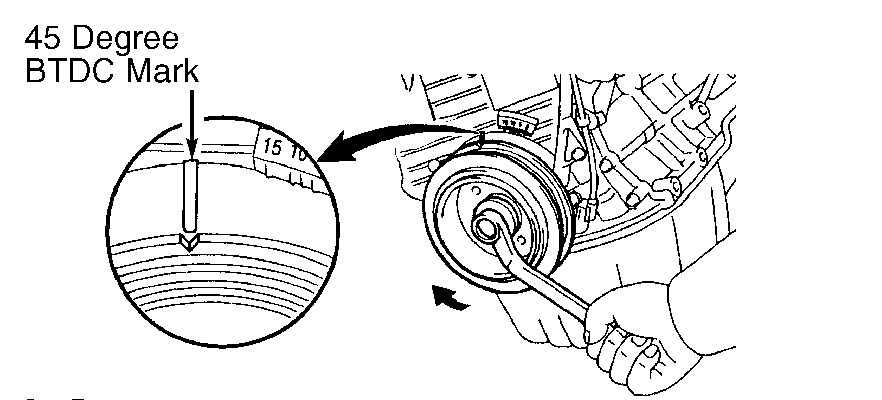

Using crankshaft pulley bolt, rotate crankshaft so key on crankshaft is at 12 o'clock position and timing mark (if equipped) on crankshaft sprocket aligns with timing mark on oil pump housing. see image 8.

Install timing belt guide with cupped side away from crankshaft sprocket and flat side toward timing belt. Install No. 1 timing belt cover and gasket.
Remove crankshaft pulley bolt from crankshaft. Align groove in crankshaft pulley with key in crankshaft. Install crankshaft pulley. Install and tighten crankshaft pulley bolt to specification. See TORQUE SPECIFICATIONS .

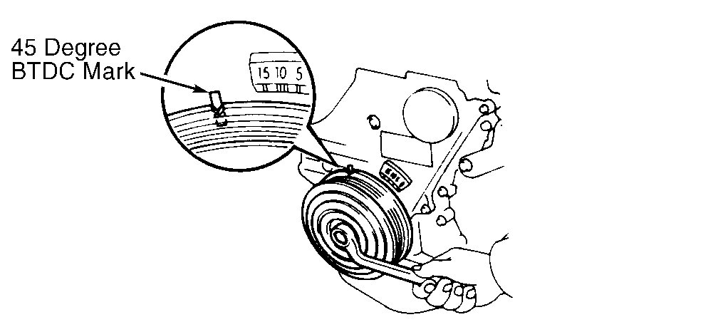

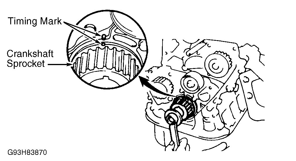

Rotate crankshaft clockwise 1 7/8 revolutions and align timing mark on crankshaft pulley with 45-degree Before Top Dead Centre (BTDC) mark on No. 1 timing belt cover. seeFig.16.
Fig. 18: Aligning Crankshaft Pulley With 45-Degree BTDC Mark (1995) see image 3
Fig. 19: Aligning Crankshaft Pulley With 45-Degree BTDC Mark (1996) see image 4
Tighten No. 1 idler pulley bolt to specification. See TORQUE SPECIFICATIONS . Install No. 2 timing belt cover and gaskets. Install and tighten spark plugs to specification. See TORQUE SPECIFICATIONS .

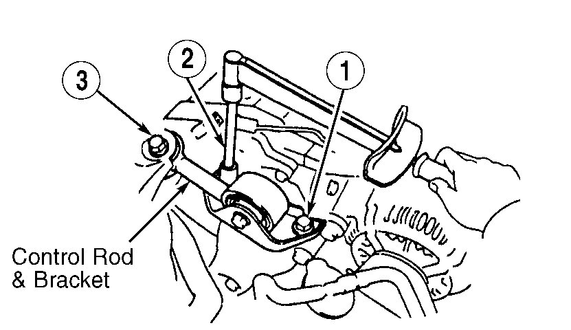

To install remaining components, reverse removal procedure. Install all bolts/nuts on engine mount before tightening to specification. See TORQUE SPECIFICATIONS .
When installing control rod and bracket on strut tower and right (timing belt side) engine mount, tighten bolts to specification in sequence. see image 5
