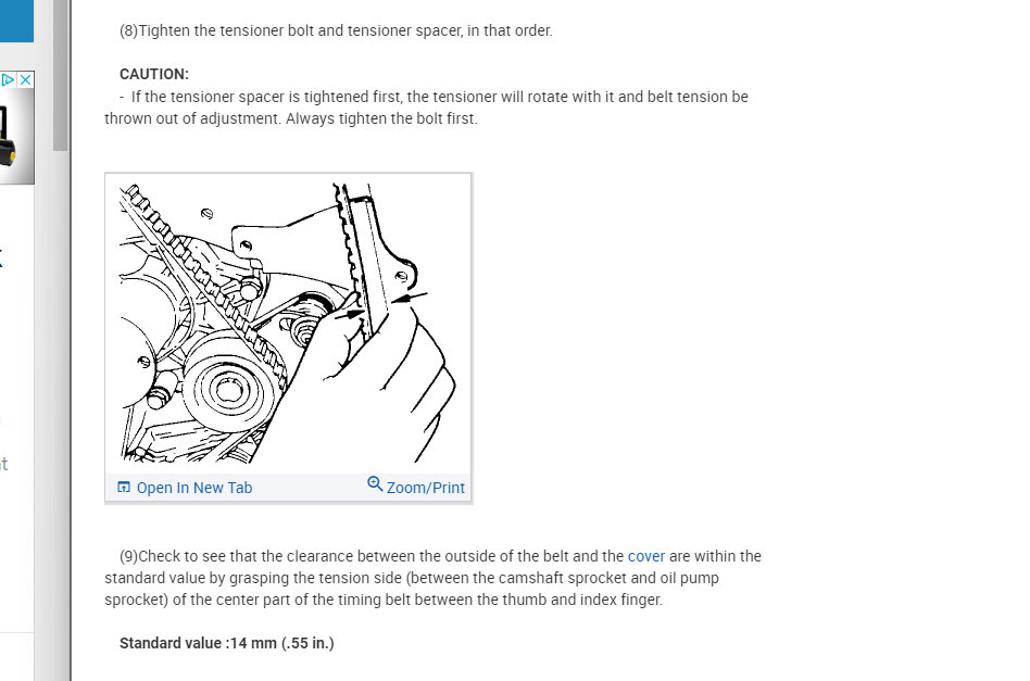

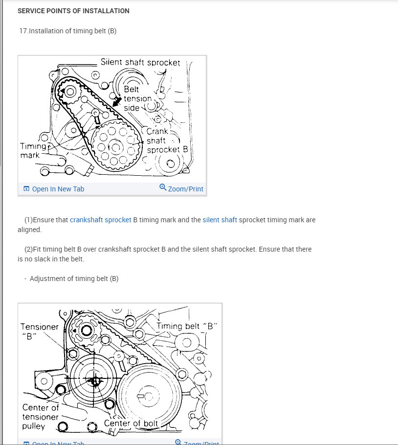

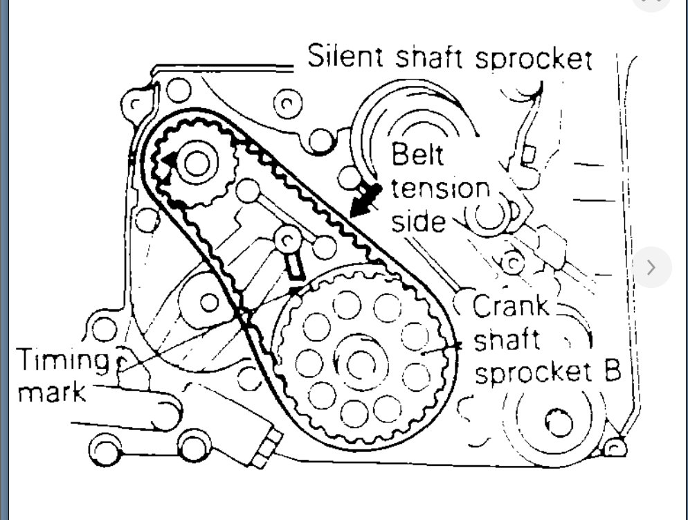

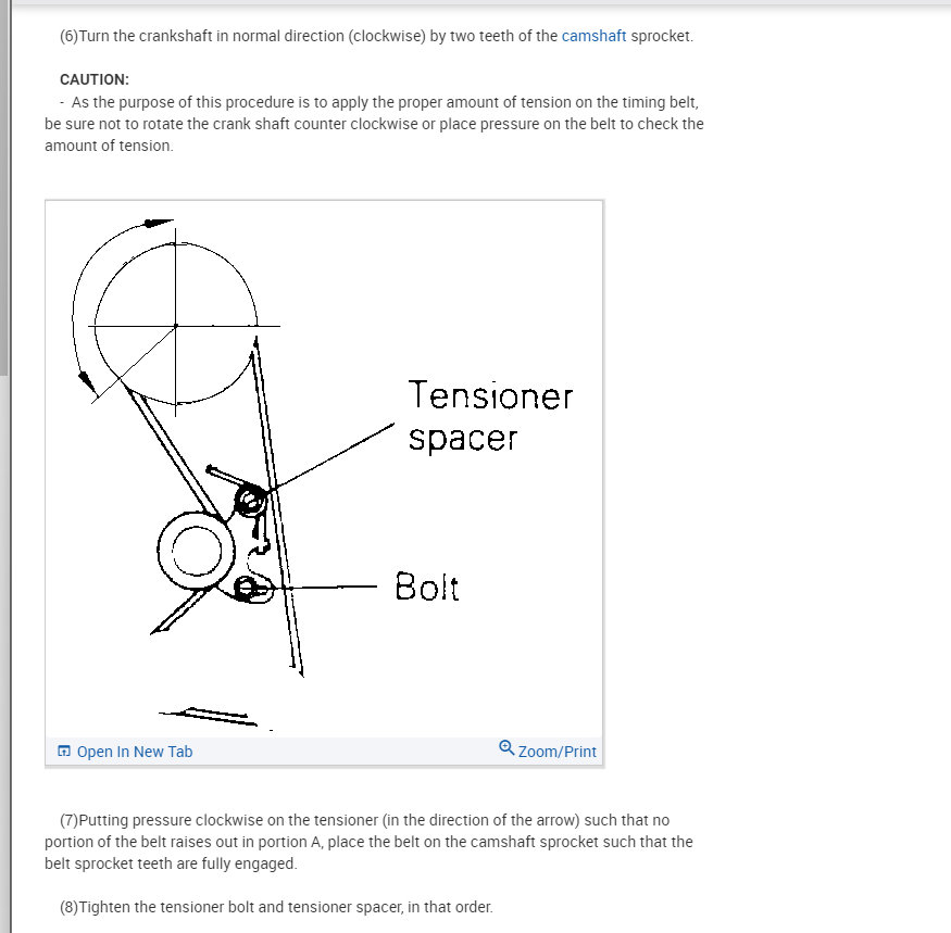

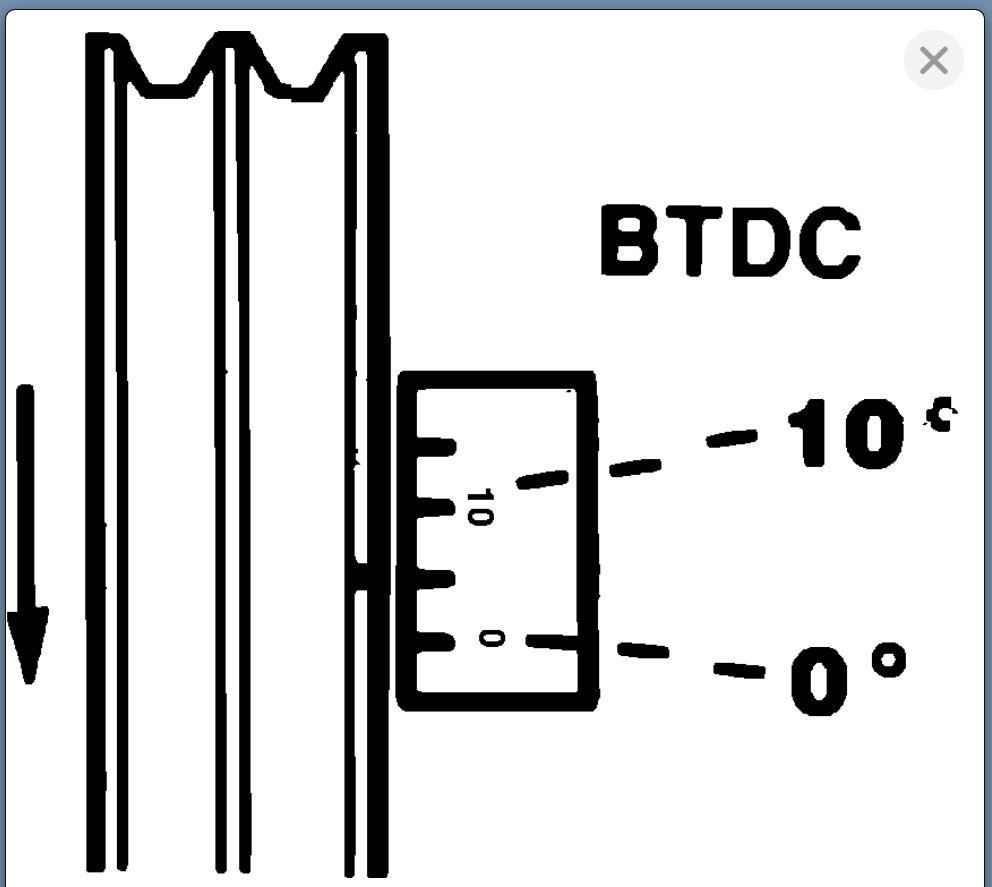

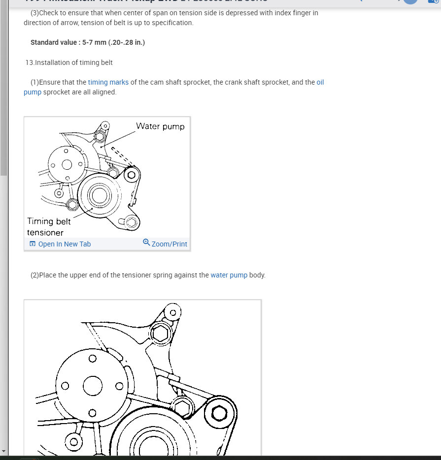

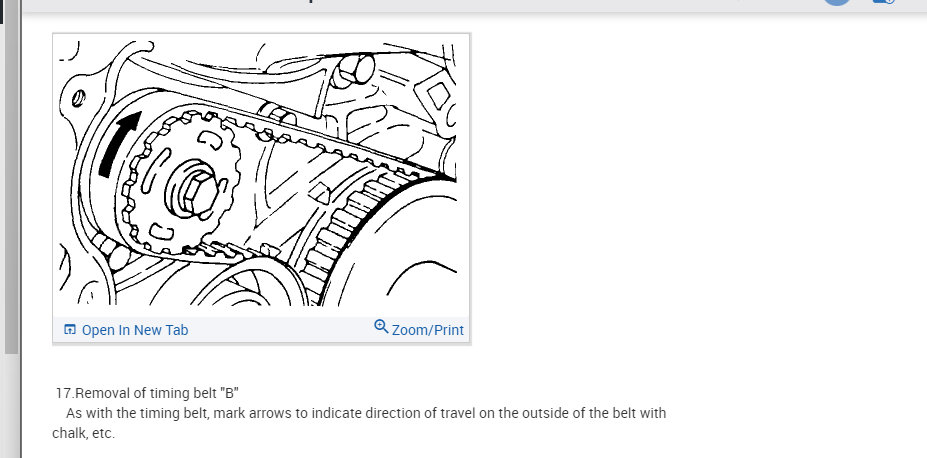

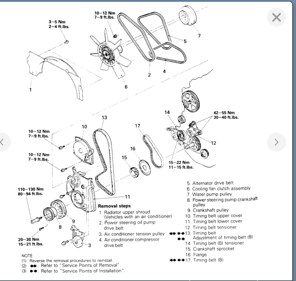

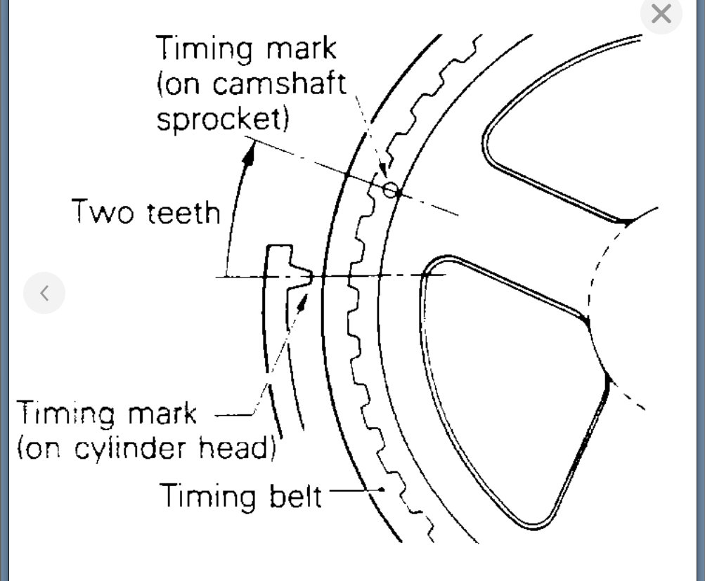

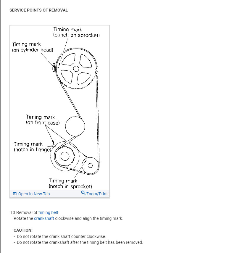

Need to know the exact position of the cam and crank timing position while at TDC compression stroke. Thank you
Oct 31, 2021 at 9:34 PM

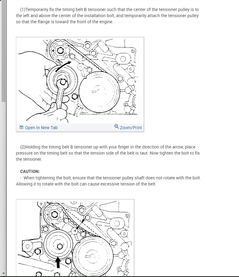

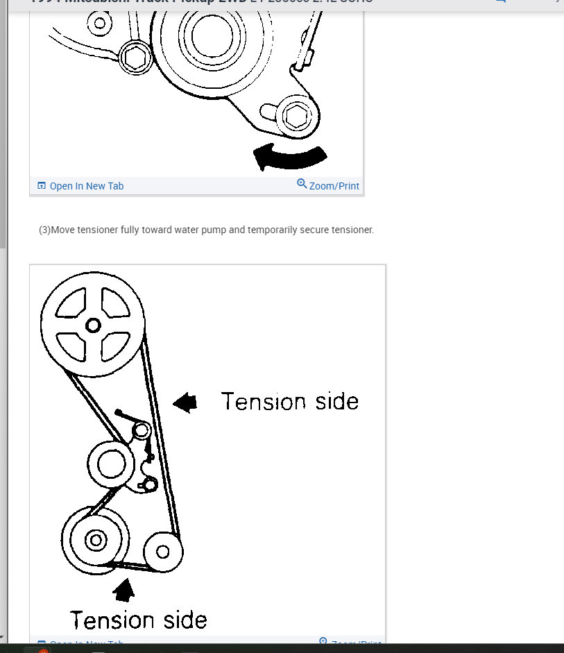

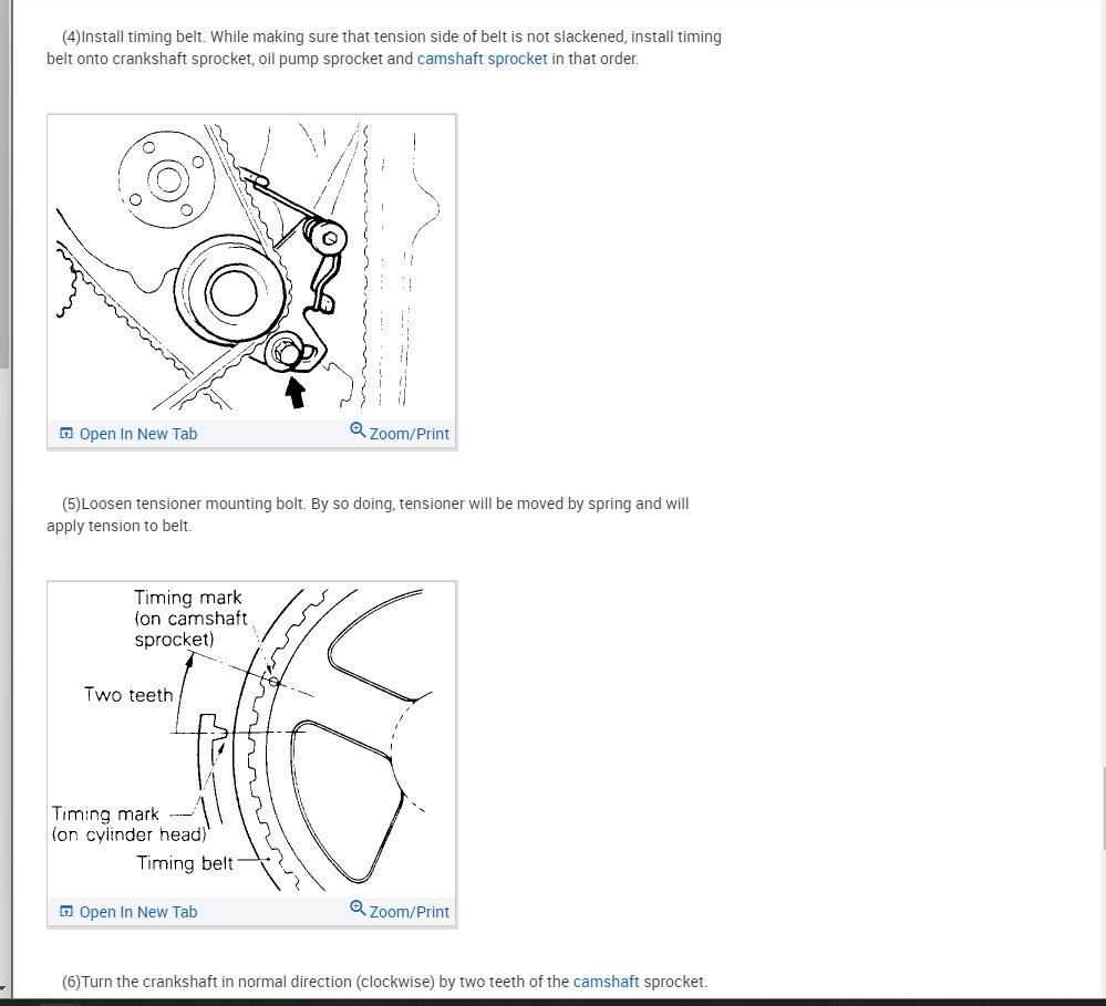

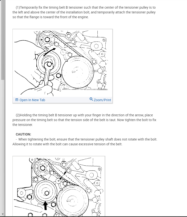

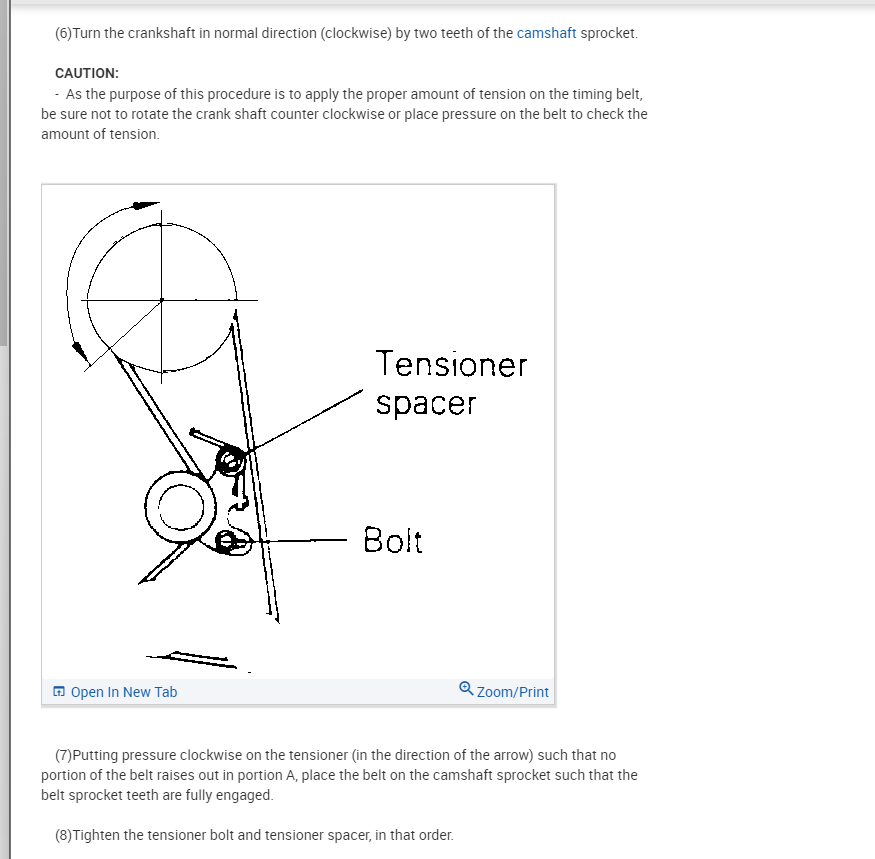

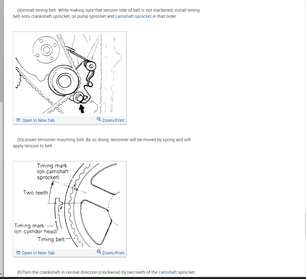

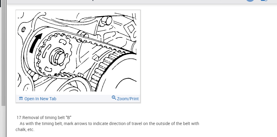

I am attaching the entire process including the timing marks for your review.
https://www.2carpros.com/articles/serpentine-belt-timing-belt-timing-chain-diagrams
Please see below for the entire process. Please run through this info and let us know what other questions you have.
Thanks
