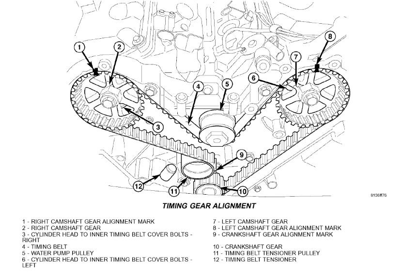

During replacing timing belt notice it was one tooth off on right side cam , during uninstalling the belt the cam on right side spun.. what is the process of getting it realigned right with out bending valves?

I attached a picture of the alignment marks for you.
If the cam spun, you can use a box wrench on the bolt holding the cam gear and rotate it until the mark lines up.
https://www.2carpros.com/articles/how-a-timing-belt-works
A little off either way and it will spin all by itself. Install the belt with the marks aligned. when you are done, rotate the engine by hand 3 times and recheck the alignment to be sure the gears are in time.

Thank you for the help. I was just worried about bending the valves if I rotate the cam while the crank was TDC.
Apr 24, 2020 at 9:22 AM
You are good.
