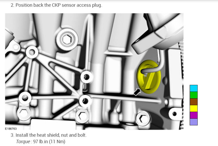

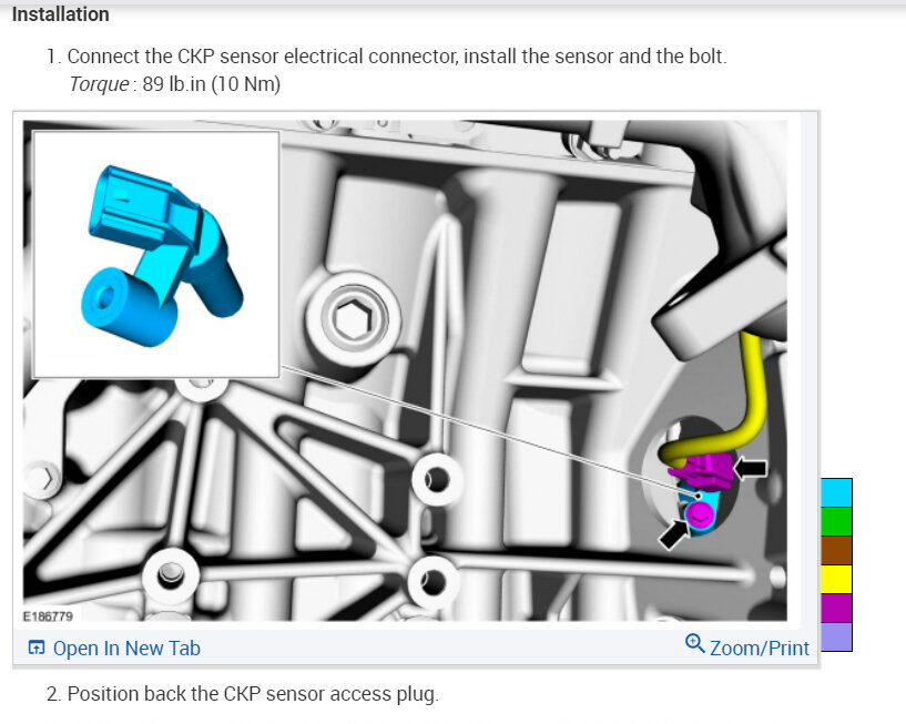

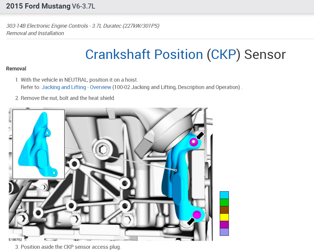

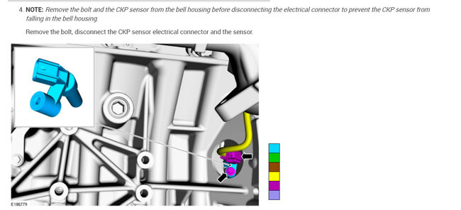

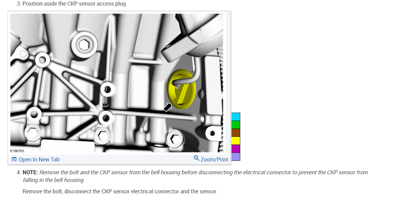

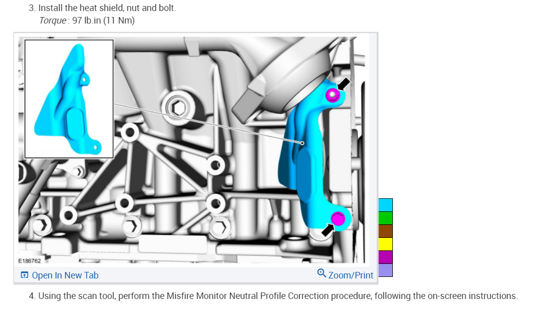

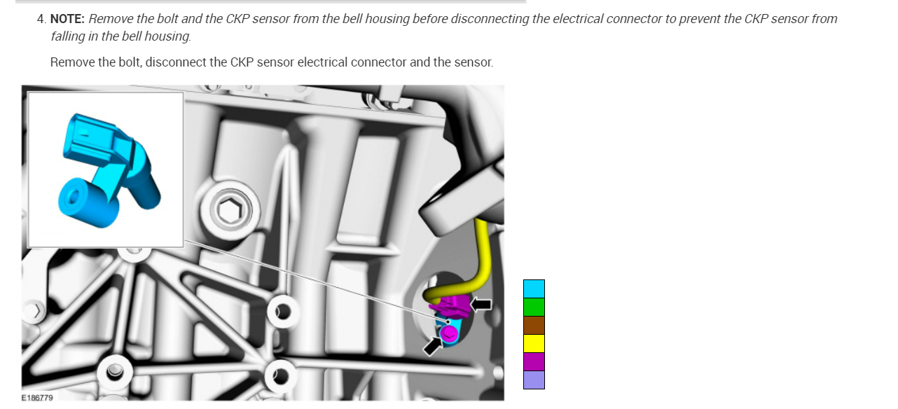

Does anyone know the part number for the crankshaft sensor bracket it screws into in side engine by the flywheel my threaded part broke.
Jul 31, 2023 at 9:21 PM
  • 55,720 POSTS
I am not sure what part you need; it looks like the sensor has the bracket made into the sensor? Please check the images below to see what I am talking about. Check out the images (below). Please let us know what you find.
