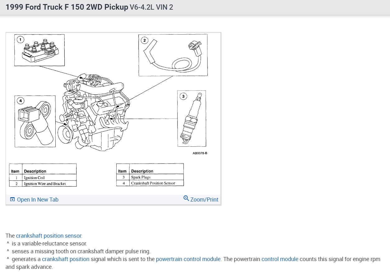

Changed water pump now no spark change camshaft sensor still no spark coil is good checked it on a ohms meter but no spark, no start.

It sounds like the crankshaft sensor is disconnected or went bad? Here is the location so you can check it out. Check out the images (below). Please let us know what happens.
