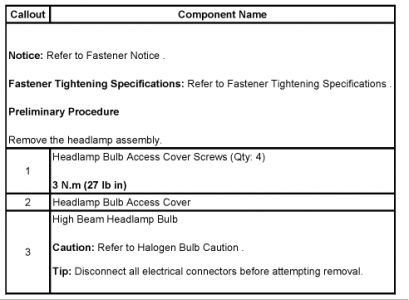

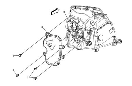

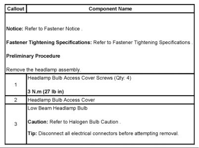

I want to change head light bulbs to improve my night driving. How difficult is it to change the bulb and how do you get to it?

Hello
