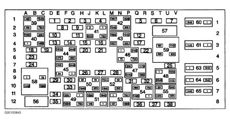

Where is the relay switch located. All documentation that I have come across say that it is in the trunk in the micro relay center...I can not locate help please.

Hi ELC relay in box under rear seat see diagrams relay # 55
https://images.2carpros.com/forum/automotive_pictures/198357_Grafic_3_134.jpg
https://images.2carpros.com/forum/automotive_pictures/198357_Graphic_524.jpg
Hope this helps Thanks for donate
