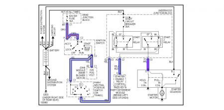

Hi, I have a 1998 STS cadillac. Every so often I noticed that when I would try to start the car it would just click. Just one click everytime I tried to start it. I would mess with putting the car in and out of park a few times and the car would start right up. Now however it wont start at all. The battery seems fine, and everything lights up in the "on" possition. But when I turn the key, all I get is a click. The starter is not turning, or even tring to turn. I have hears that ignation cables need to be replaced around 100k. Any help would be great. Thanks in advance.

Sounds like the park and neutral position switch if you have to play with the shifter-if not could be the relays
https://images.2carpros.com/forum/automotive_pictures/12900_starter_circuit_caddy_sts_1.jpg

The terminals are really clean. The battery has a good charge. When I try to start the car in park or nutral I can hear a click under the hood and in the fuse box that sits under the seat next to the batterie. When I try to start the car is D, or anything other then P/N it makes no noise at all. I know its not supose to, it just makes me think the P/N switch might be OK. Maybe the starter? where is the P/N switch, and or relays? Thanks for the help.

Get a helper to hold key in the start position-you go and short out the small purple wire on the starter solenoid to the battery terminal-did it crank over?

I can't get to the starter and solenoid. It is under the intake manifold.
